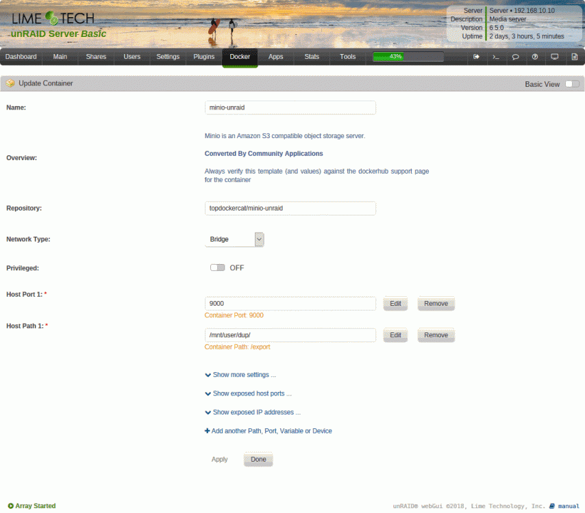

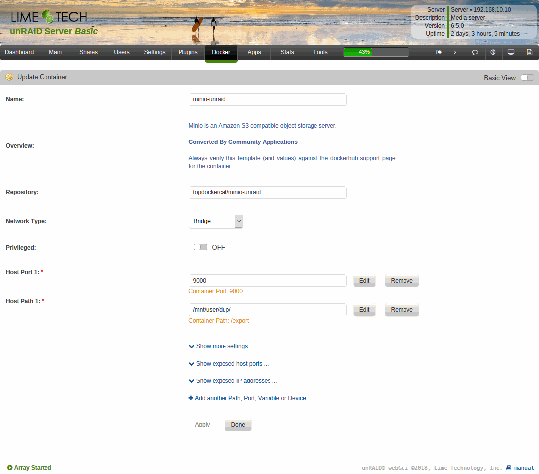

Wow. Setting up Minio and Duplicati was incredibly easy.
I have set up Minio using the unRAID docker available from "topdockercat". The only setting I needed to change was to point it to a folder on unRAID to store the Minio "buckets".

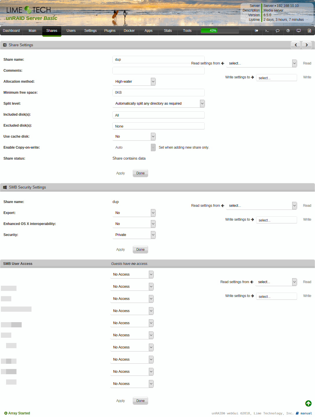

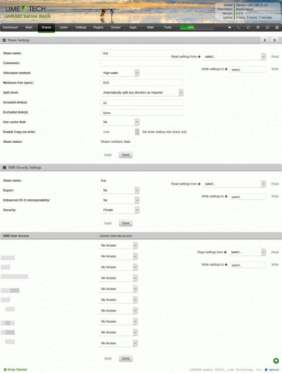

(in this case I made a folder called "dup", and did not share it in any way)

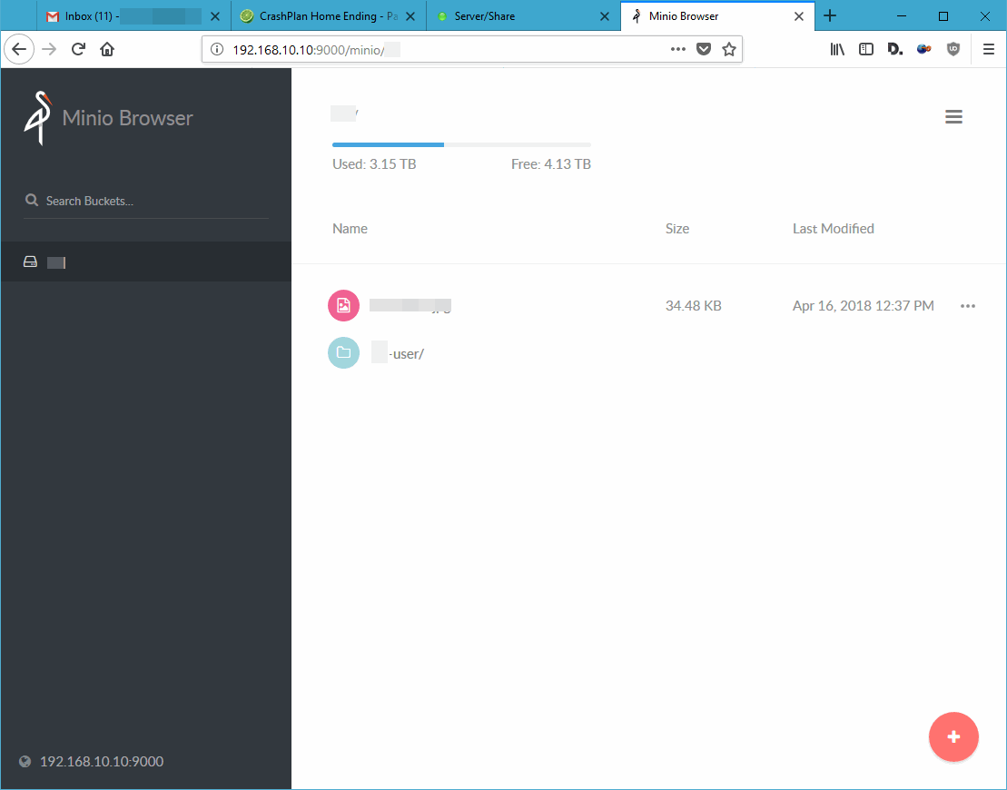

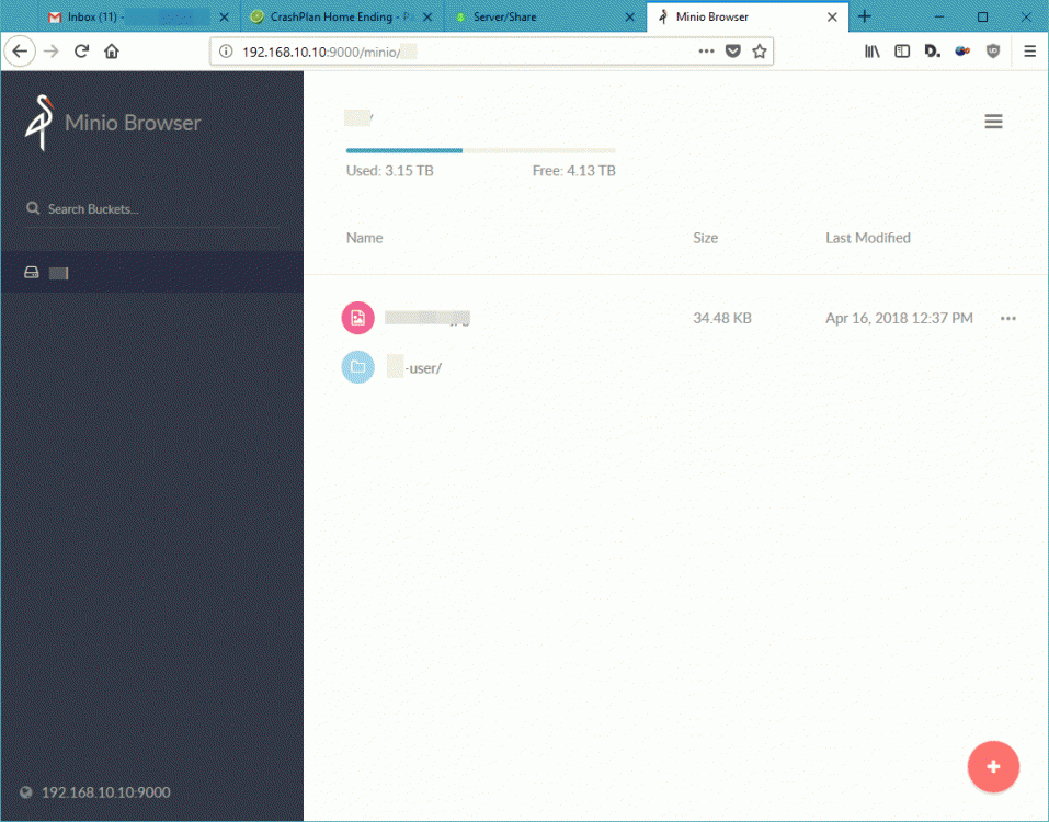

Then just made a generic bucket in Minio:
I got the Minio Keys from the docker log in unRAID.
Then I installed a Duplicati client on one of my local client computers and was able to make a backup by pointing it to the unRAID box on the LAN. The first backup compressed 60GB of files into 30GB of duplicati files... This took almost an hour for the first backup.
