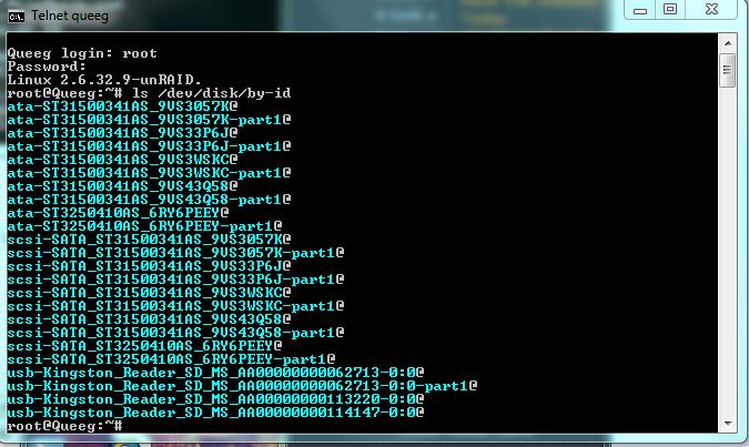

I ordered 2 more Kingston Mobile Lite G2 from here.  The attached picture shows the device id's for all 3.  One I am running my basic unRAID off of and the other two inserted but in this picture there aren't any flash chips in them at the moment.
So here are 3 of the same model with each having distinct identifiers.
usb-Kingston_Reader_SD_MS_AA00000000062713-0:0@
usb-Kingston_Reader_SD_MS_AA00000000062713-0:0-part1@
usb-Kingston_Reader_SD_MS_AA00000000113220-0:0@
usb-Kingston_Reader_SD_MS_AA00000000114147-0:0@

If you just want to check it's serial number then insert it into a usb port, telnet to unRAID (or at console) type
         ls /dev/disk/by-id
The you will get a list of devices and one will look like this.  Yours will have a different serial number than this.  Post this device entry.
