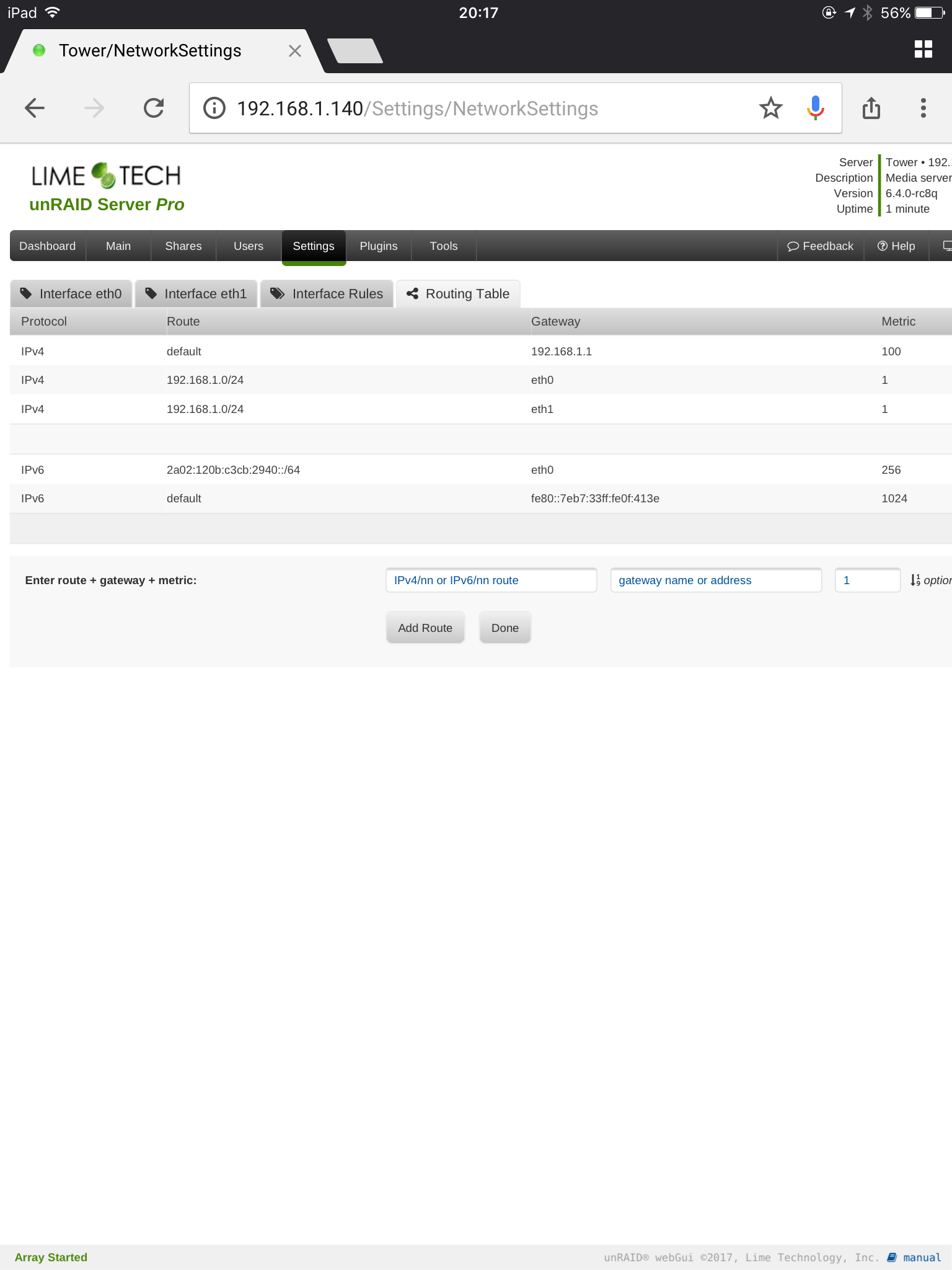

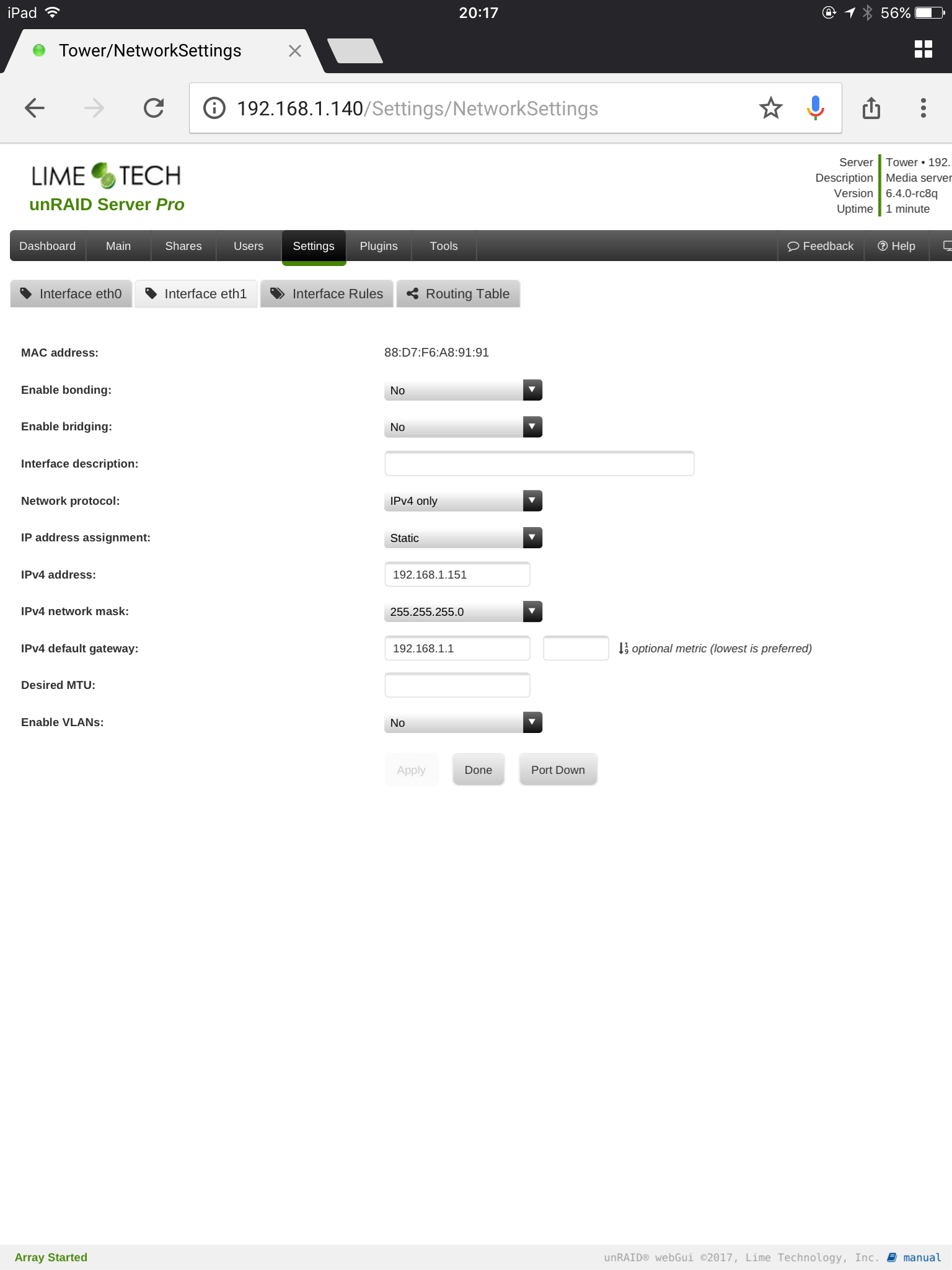

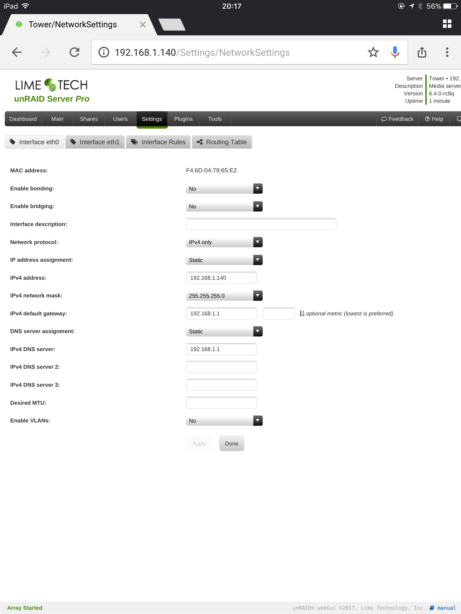

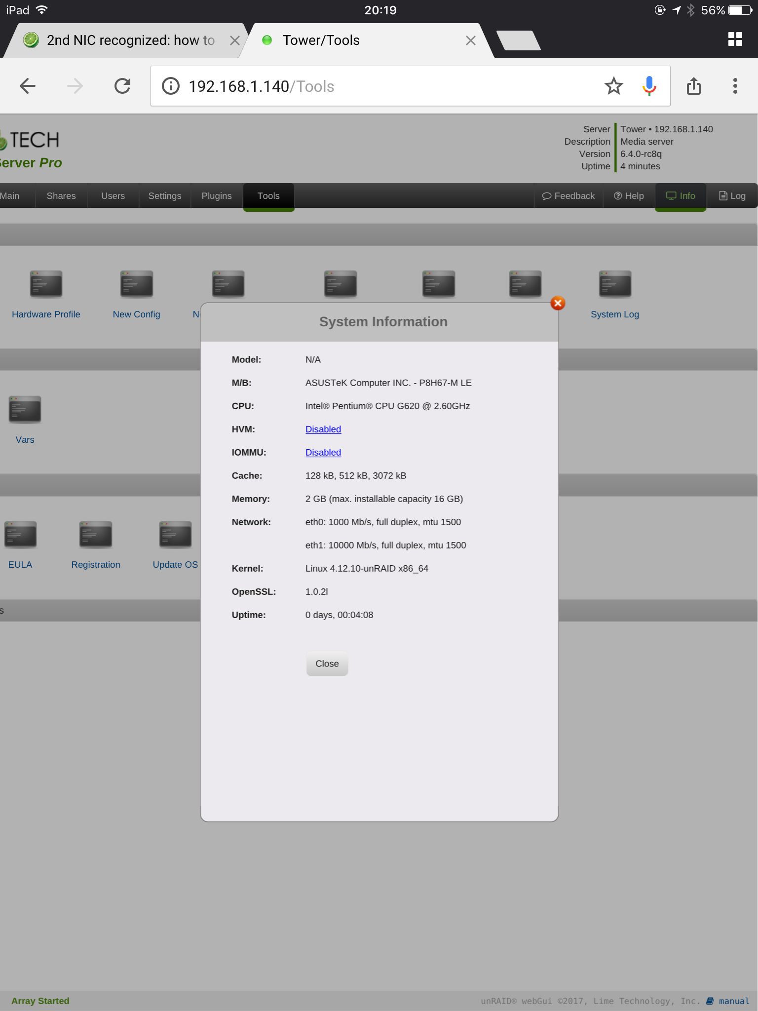

I installed a second NIC in my server, it's an Aquantia 10 Gbe NIC. I'm using the latest RC (with Aquantia drivers) and the interface is recognized as eth1 10Gbe. I'm also using a 10 Gbe switch and another 10 Gbe NIC in my workstation. Eth0 and eth1 are configured with static IP with the following IP: 192.168.1.140 and 192.168.1.141 (same submask).
I want to use it as the main NIC. What I tried so far:
- Switch eth1 with eth0 in Network settings
- Disable onboard NIC (1st NIC) in the BIOS
- Assign a higher metric to eth0 in Network settings
- Reboot rooter several times while doing the above actions
None of the above actions worked. It resulted in the impossibility to reach the server over network. Otherwise I could reach the server but with 1 Gbe speeds (writes to cach disk at 110-115 Mo/s).

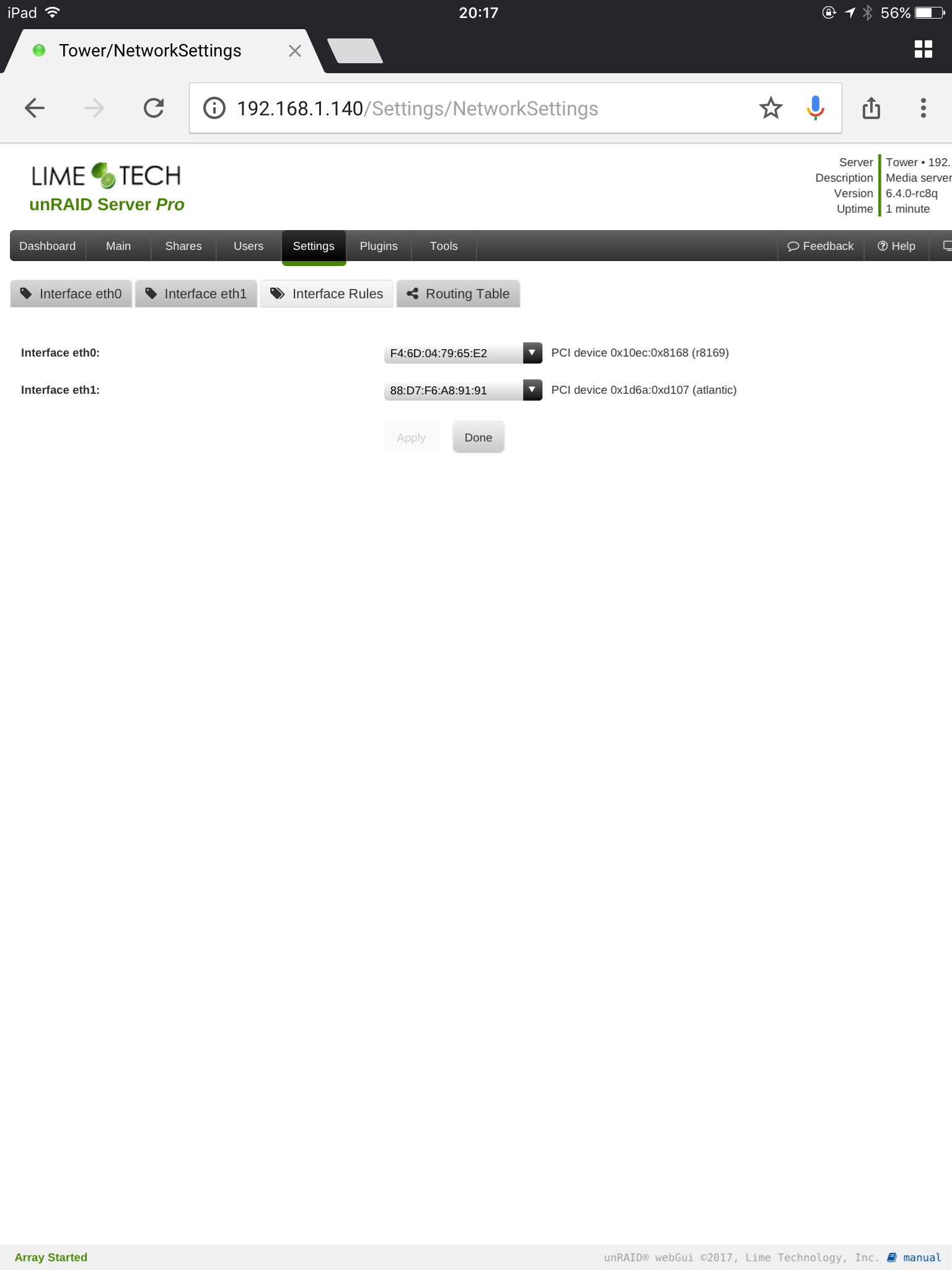

Settings -> Network Settings -> Interface Rules
Set the 10GbE NIC as eth0, reboot
I did but it didn't work. I'll try again.
That's all you need to do, then use DHCP or static IP, you can use the boot GUI mode if you lose access and need to reconfigure the network.

@BensonI'm using only one switch (Asus XG-U2008). My PC is connected to the switch using 10GbE port 1. My unRAID build is connected to the switch using 10GbE port 2. I disconnected the cable between the on board NIC and the switch (both 1GbE ports). I tried the following:
a) setting eth0 as 10GbE NIC and disabling eth1
b) setting eth0 as 10GbE NIC and changing subnet mask of eth1 to 255.255.254.0
c) setting eth0 as 10GbE NIC, changing subnet mask of eth1 to 255.255.254.0 and removing eth1 entry from the routing table
Nothing worked. You'll find the log file after a).
I don't intend to use both NICs at the same time, I'm fine using only the 10GbE NIC. But that doesn't work yet.

Are you access IP 192.168.1.140 instead of 151 ?
From log, it seems the 10G NIC working and have packet in/out, but RX packet just 4 bytes only. Does this grow with time ?
Would you try attach the 10G port to previous switch, the aim was verify 10G NIC and setup work or not without new ASUS switch.
