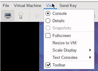

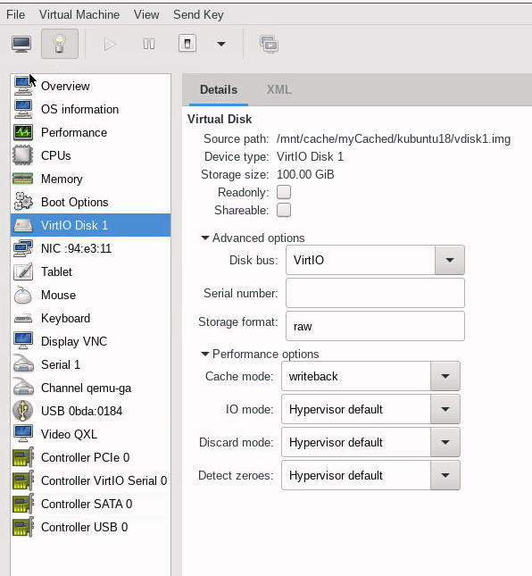

September 25, 20197 yr I've opened the VM and looked through all the menus and I don't see any mention of a snapshot or backup manager. See screenshots below. Edited September 25, 20197 yr by frakman1
September 25, 20197 yr 45 minutes ago, frakman1 said: ... This might help. https://blog.wikichoon.com/2014/03/snapshot-support-in-virt-manager.html It looks like your snapshot manager button is disabled, and you're using raw format disks rather than qcow2. It might be possible to snapshot with raw but I'm not sure how that would work.
September 25, 20197 yr Thank you for the link. Does this mean that I can change the "Storage format" field from raw to qcow2 and continue to use the VM ? That storage format option was not available within the Unraid VM settings page when I created it, Actually, I just answered my own question when attempting to change it. So it looks like I would need to have created the VM from within virt-manager to start with and use a qcow2 storage format in order to use the snapshot manager. Is that how you use it? Edited September 25, 20197 yr by frakman1
September 25, 20197 yr 5 minutes ago, frakman1 said: Thank you for the link. Does this mean that I can change the "Storage format" field from raw to qcow2 and continue to use the VM ? That storage format option was not available within the Unraid VM settings page when I created it, Actually, I just answered my own question when attempting to change it. So it looks like I would need to have created the VM from within virt-manager to start with and use a qcow2 storage format in order to use the snapshot manager. Is that how you use it? I personally usually create the VM in unraid webUI and then use the command line to convert the disk type. Then I modify the XML to change the type from raw to qcow2. But qcow2 support in the webUI wasn't always available. If you already have a disk it will need to be converted, if starting fresh you probably wouldn't need to do this conversion.
September 25, 20197 yr Thank you for the hints @scorcho99 Is this the command you would use to do the conversion? qemu-img convert -f raw -O qcow2 /path/to/your/hdd/vm01.img /path/to/your/hdd/vm01.qcow2 and is this the XML line to change it from raw to qcow2? <driver name='qemu' type='raw' cache='writeback'/>
September 25, 20197 yr 7 minutes ago, frakman1 said: Thank you for the hints @scorcho99 Is this the command you would use to do the conversion? qemu-img convert -f raw -O qcow2 /path/to/your/hdd/vm01.img /path/to/your/hdd/vm01.qcow2 and is this the XML line to change it from raw to qcow2? <driver name='qemu' type='raw' cache='writeback'/> I don't have my notes that I use for this, but the command at least looks right at first glance to me. And that looks like the XML line.
