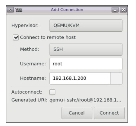

September 29, 20179 yr Application Name: Virt-Manager Application Site: https://virt-manager.org/ Docker Hub: https://hub.docker.com/r/fanningert/docker-virtmanager Github: https://github.com/fanningert/docker-virtmanager Template-Repository: https://github.com/fanningert/unraid-docker-templates Answer for connection over SSH: Install "netcat-openbsd" via Nerd Tools Select SSH in Virt-Manager, add as user "root", add as server the IP or server name and click Connect. If you don't use a ssh key file, you need to enter the ssh password in the console. Answer for connection over TCP (More details in the video): When you like to connect to the unRaid libvirt-System over TCP, you need change one setting of libVirt. A good start is the video from @gridrunner: Link to post with video Install "Nerd Tools" Go to the Nerd Tools and install "nc". Change the listen address ("listen_addr") of libVirt daemon from 127.0.0.1 to 0.0.0.0 . "nano /etc/libvirt/libvirtd.conf" Stop and start the array. With this, the libVirt daemon will be also restarted. ToDos/Bugs: Some times noVNC reconnect. I think the problem is that the websocket connection is currently only HTTP. It's looks like Virt-Manager is the problem. This bug is coming sometime by clicking on the menu entry "File", but when the reconnection is finished the menu is visible. The only problem know is that the libVirt daemon is listen know on the network. So, this docker container also support SSH for Virt-Manager. The only problem is that I get currently this error message after login on unRaid over SSH throw Virt-Manager. libvirtError: Cannot recv data: Value too large for data type The previous error is coming from Virt-Manager, because the app is not possible to ask for the ssh password. The solution for this is to start Virt-Manager via terminal. Know it is possible to enter the password into the terminal window. But after that I get a error message that the current nc version of the Nerd Tools don't support the "U" parameter. Install "netcat-openbsd" via Nerd Tools. Run noVNC under HTTPS Edited September 29, 20179 yr by fanningert

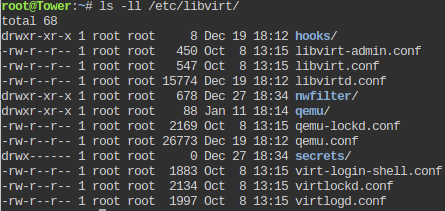

January 11, 20188 yr Author @disruptorx I don't know your system. But is libvirt running? This container is only usable with a running libvirt on the unraid server or a other libvirt server. I tested the docker container on 6.3.5 and 6.4rc* and on all of this releases the libvirtd.conf file is in this directory. Here a screenshot from my current unRaid 6.4rc21. Edited January 11, 20188 yr by fanningert

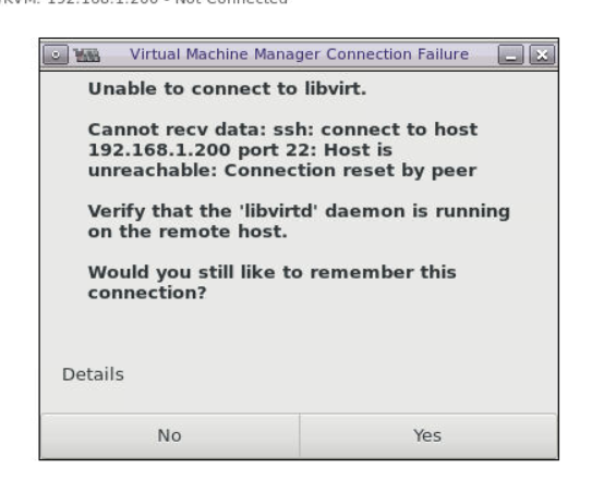

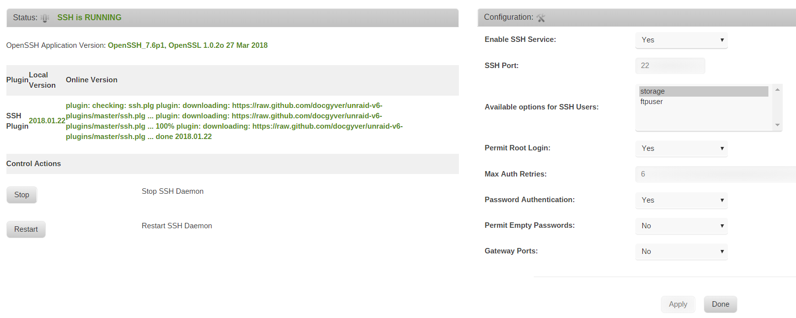

August 11, 20188 yr what is the advantage of using this instead the unraid interface? Is there any incompatibility or issue? BTW I am getting this error, I have ssh enable in unraid, and I have installed netcat Edited August 11, 20188 yr by L0rdRaiden

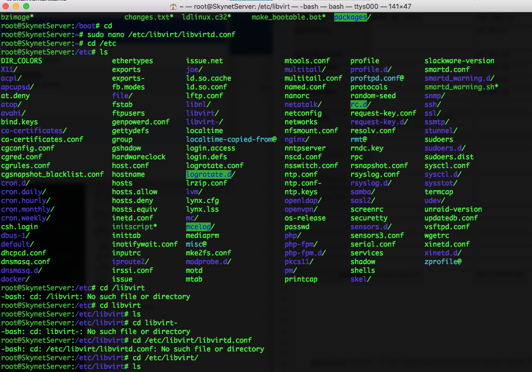

January 9, 20197 yr On 1/10/2018 at 6:49 PM, disruptorx said: Hi @fanningert , I can't seem to find /etc/libvirt/libvirtd.conf to edit . any ideas why ? I have the same problem of not having the file /etc/libvirt/libvirtd.conf. A brief history: I have four VMs, which were working fine under 6.5.3. I tried to install virt-manager on a Linux VM following SpaceInvader One's video, which also requires editing libvirtd.conf. While following the video I was able to edit the file, which was in the expected /etc/libvirt folder. (I also enabled nc-1.10 from NerdPack, as set out in the video.) But after rebooting unRAID, my VM tab was blank. Sometimes it takes a few minutes for the VMs to show up, but after a long wait there were still no VMs listed. (I've checked the paths in VMSettings, and I'm sure they're correct - and everything was working previously.) I thought I had messed up the editing of libvirtd.conf, but when I looked for it, I found that the /etc/libvirt folder was empty. I saw that there was also a /etc/libvirt- folder (note the minus sign) and inside that folder there is a libvirtd.conf file (without any change to the "listen_addr" line). I have no idea why the file is in this other folder and whether this is expected behaviour. On 1/24/2018 at 4:55 AM, disruptorx said: @fanningert thanks it's working now So @disruptorx, how did you get it working? tower-diagnostics-20190110-1722.zip Edited January 10, 20197 yr by sonofdbn Added diagnostics file
