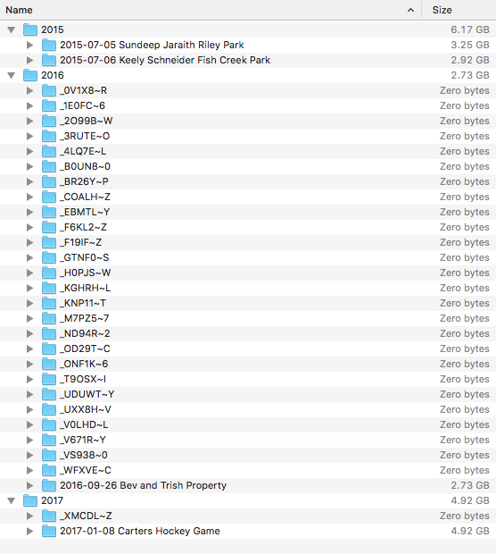

I went to update and migrate my photos from the old Light room classic to the new Lightroom CC
upon import it errored saying it couldn't find about 5300 photos from all my jobs in 2016...
I at first realized they are on my Unraid server i need to mount the drive and now using MacOS High Sierra i need to use Samba and not AFP
I mounted the drive and tried again...same error as before.
i went to my directory structure and found all the folders (one per job names by date and client) are now all scrambled names like in the attachment. the data seems to there taking space but i each folder appears empty as per my finder view.  I relied on Unraid's parity to protect me from stuff like this.
Is there any way to get my files back? I need them for an upcoming calendar project for the Calgary SPCA. HELP please.

It looks like you have used characters that the Mac doesn't like or too long names. Therefore the name is just showing letters and numbers.
If you SSH into unraid and go directly to the shares they should look normal.

seem like maybe Mac and Windows dont like the names ......Sierra never had an issue with them as thats how they were in Light room in my local Pictures folder before i migrated them.
but you are also right i ssh'd into the server and files names are fine, should i be renaming via CLI to correct them?

answered my own question.....I was naming completed projects with a folder name of "*** 2016-07-20 <client name> <pet name>"
appears windows and now MacOS doesnt like the *** now...i used mv to rename one and it shows now....
thanks Saarg you just saved me a lot of stress. now I can do these calendars sell them and donate the proceeds to the Calgary Humane Society.....
now my only problem is lightroom it will be expecting folders with those *** I may have to reimport them into Light room classic and save it all over but at least the files are there.
thanks.
one last note is on a recovered folder name i used Finder to change it back just to see......and it stays visible. so i found a less stressful solution....I guess that the file name might be been problematic with nano the CLI i used to move the files to the server in the first place.

Not sure why * confuses Mac, as I thought the same applied as in linux regarding file names, but it might be samba that is the limitation.

yes I think you're right. it must be Samba,
when i tried to rename one
mv ***\ 2016-09-04\ YYC\ Pride/ ***\ 2016-09-04\ YYC\ Pride1/ it didnt error but the folder name in a mount using samba changed...
I have to use no *** then i can use Finder (using samba mount to add them back)
now its brackets......hmmm got some i put the pets name in Brackets...unraid is confused by this
trying to rename this one
***\ 2016-10-29\ Deanna\ A\ (Dexter)/
i get this error
-bash: syntax error near unexpected token `('
and now i fixed that..... just needed to add " around the brackets
mv ***\ 2016-10-29\ Deanna\ A\ "(Dexter)"/ 2016-10-29\ Deanna\ A\ "(Dexter)"/
that worked
Issue fully resolved unraid side now....thanks for the help everyone!

I regularly use brackets in filenames (with Windows clients) so I think there must be something else going on.    I can understand that * caused a problem as that is a reserved character in filenames on Windows, but brackets are not).
You need to be careful though if using the command line as then brackets might well have special meaning if not escaped depending on the tools you are using.
