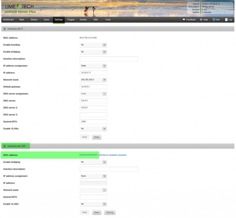

So. After resetting my router/firewall, and all the pain that goes with reconfiguration and then enabled the on-board NIC, unraid came up with both interfaces displaying properly. i configured eth1 then switched the eth0 and 1 so the 0 is now the onboard interface.  Rebooted.  The mac address for the NIC card is back to all FFs and the interface is labeled 120 -- see screenshot. The good news is I am back online and the tower is accessible via the network.  Is the nic card bad?  Unraid bug?  Something else?

Your Physical interface is eth0 which is the top one in your post and its MAC address is on the first line of that section.  The other one is probably for the use of one of your docker apps and works through eth0.  (I am not really an expert on what is going on behind the scenes with internal handling of sharing a single physical interface among unRAID and various Docker applications.)
The eth0 is the onboard NIC and the other is the NIC card.   I've ordered a new NIC card and will see if that solves the issue - as in the NIC card went bad.   If not, then I will need developer assistance from Lime.  Note,  I do not have any plugins or anything extra since moving to 6.3.5.
That looks like a hardware issue (broken) NIC, recommended to replace.
