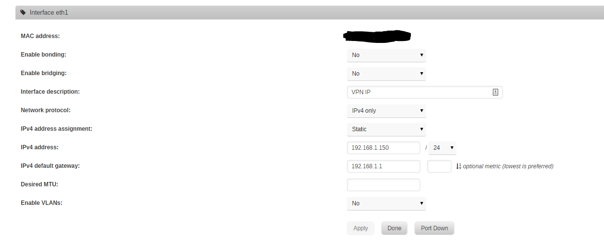

@bonienl Was wondering if I could get some help with this. Server has a quad NIC, and I'd like to take one of those and use it for one specific container, leaving the rest as they are (at least for now). I set the eth1 interface up with a static IP, and I'm able to choose that interface in the container template. When I start the container I am able to ping it locally just fine, but it cannot reach the internet. I've been all over the forums looking for an answer, and I'm sure its just me missing something, but any help would be appreciated.

Make sure you have included a gateway address in the static assignment of eth1.

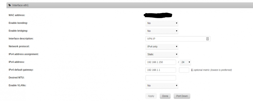

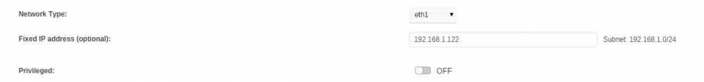

Yeah I've got that in there. I've attached an image of my eth1 config as well as the container network settings

@bonienl
The gateway address (192.168.1.2) is wrong. It should be 192.168.1.1 (assuming the setting for eth1 is correct).
