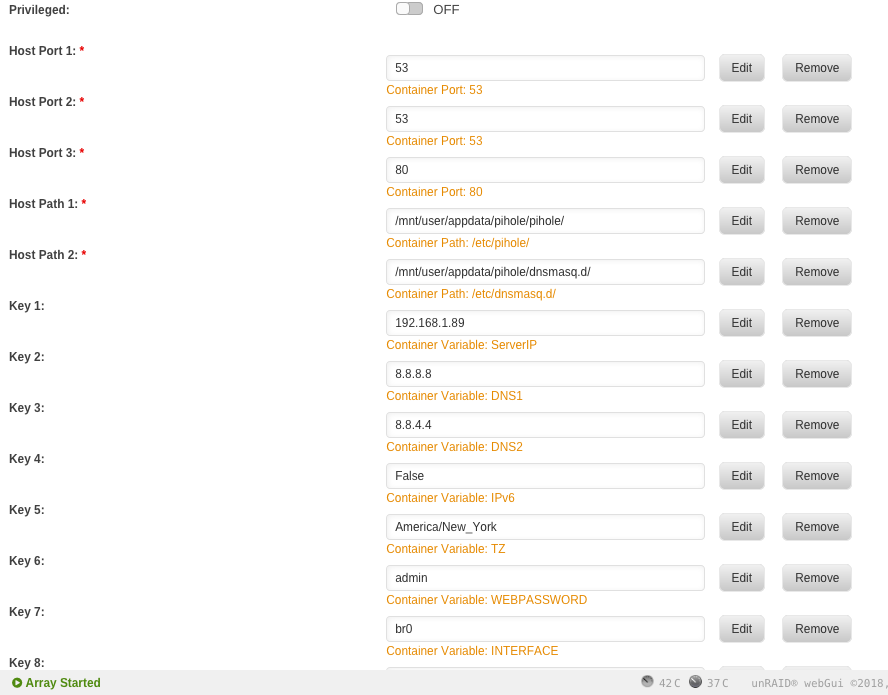

Correct as long as you use a unique IP address for the docker container, it is free to use any port as required. Can you post a screenshot of the docker settings of pi-hole.

Ok, I've upgraded to 6.4.1. Here is the screenshot. Thanks!
Command: root@localhost:# /usr/local/emhttp/plugins/dynamix.docker.manager/scripts/docker run -d --name='pihole' --net='bridge' -e TZ="America/New_York" -e HOST_OS="unRAID" -e 'ServerIP'='192.168.1.89' -e 'DNS1'='8.8.8.8' -e 'DNS2'='8.8.4.4' -e 'IPv6'='False' -e 'TZ'='America/New_York' -e 'WEBPASSWORD'='admin' -e 'INTERFACE'='br0' -e 'DNSMASQ_LISTENING'='all' -p '53:53/tcp' -p '53:53/udp' -p '80:80/tcp' -v '/mnt/user/appdata/pihole/pihole/':'/etc/pihole/':'rw' -v '/mnt/user/appdata/pihole/dnsmasq.d/':'/etc/dnsmasq.d/':'rw' --cap-add=NET_ADMIN 'diginc/pi-hole:debian'
b1bb4a1db516da072bfe5092af5bd7086ab01163dc427b24e12411669404fa02
/usr/bin/docker: Error response from daemon: driver failed programming external connectivity on endpoint pihole (d881d154a3e4b46b924072ca2899eadbe54a5d81b0609368c9550cff66fb9253): Error starting userland proxy: listen tcp 0.0.0.0:80: bind: address already in use.
The command failed.
You are doing it wrong.
You need to delete all the port mappings, and keep INTERFACE on eth0.
Then there is a drop-down above the port mappings, where the default is host or bridge. You'll need to change that to br0 or whatever docker network you want to use.
I can't give you more detailed examples as I'm on mobile right now.
Thanks, in the drop down that used to only have "Host" and "Bridged" I now see None and br0. I selected br0 which gave me the option to enter 192.168.1.89. I didn't change anything else and the docker spun up once I hit apply. So all appears to be good. Thanks!
