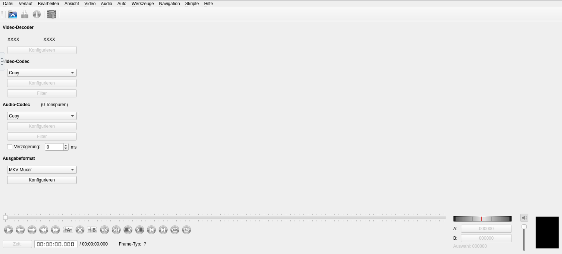

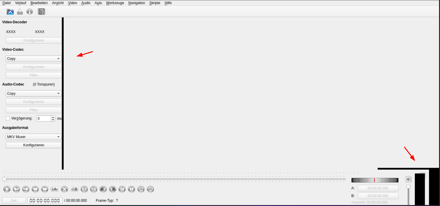

all the same behaviour, the "distortion" you see is already on startup too.
v27 (black bar left and black window buttom right looks offset)
v24 looks started up like this
