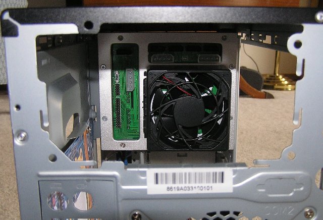

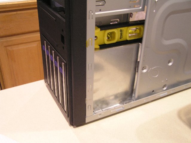

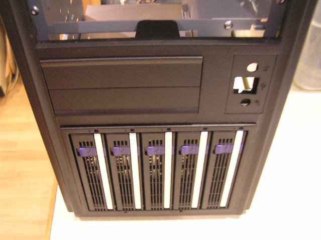

UPS delivered my Icy Dock today.  Here are some pics showing how it fits into the TinyTen case.  I haven't drilled the mounting holes in the bottom brackets yet.  Notice the fabricated right side bracket.  It rivets on the front, bottom and back.  The yellow thing is a level.

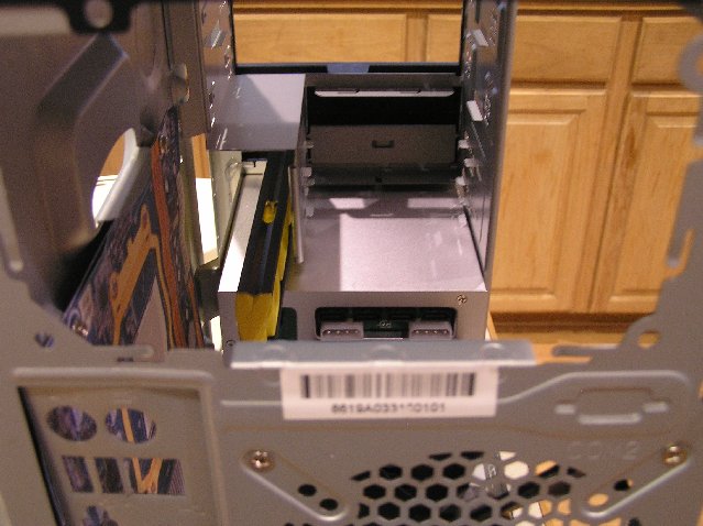

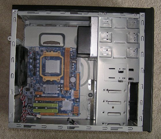

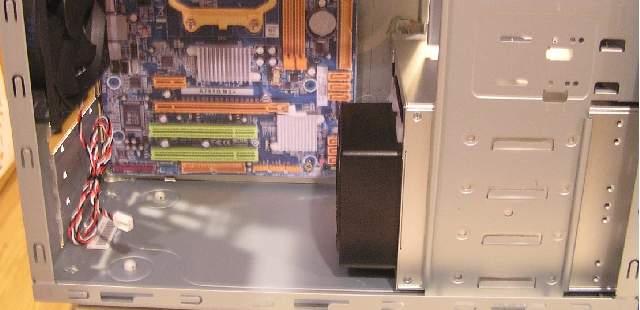

Here is the Icy Dock in the top bay with the Biostar mockup.  Lots of space between the Icy Dock fan and the motherboard.

P.S. Not got any of the Supermicro docks where I can easily picture it - I just tried. I can tell you that the fan sticks out WAY further than the connectors do. I have an "open box" dock on the way thanks to the deals forum, maybe I can snap a shot of that one for you. This pic might help though -> 17-121-405-S03?$S640W$ It's turned on it's side - mounted the power connectors on the side where you see SATA here.

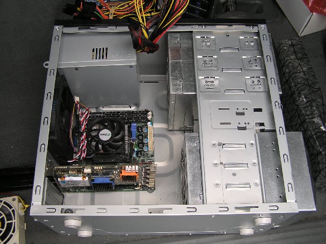

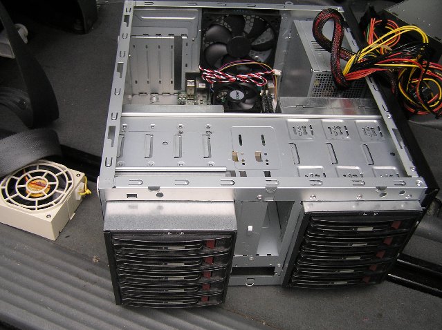

Here is some shots of the case with Supermicro 5-in-3's and a mini-ITX motherboard.  My friend wanted to know if his parts would fit.  I didn't align the 5-in-3's exactly where they should be before taking the pictures but the bottom one is pretty closely lined up.  The top one is pushed in about 1 inch too far.  The fans are removed but the bottom unit probably could have the fan installed.  I personally would use a tiny bit of hotglue to attach a 120mm fan directly on the back of the top unit.  There are 120mm x 10mm fans that mostly likely would work, but even a 25mm wide fan would fit.
There is an adaptec 16port sata controller plugged into the mini-ITX mobo but I don't have the exact card model at the moment.
The psu is a normal ATX psu I stuck in there just to check for fit.  The antec brand psu's have the intake fan on their back side (instead of the bottom) so that would certainly help with airflow.
It took me about 40 hours to mod the first case.  I've got it down to about 6 hours.  I'm willing to trade case's for hardware so if you have stuff you don't want anymore I might trade for it.  Hard drives, mobo's, ram, drive bays, controller cards... you name it.
