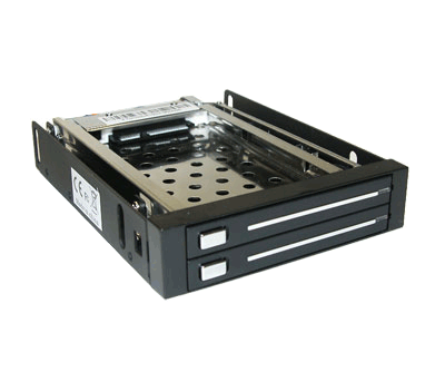

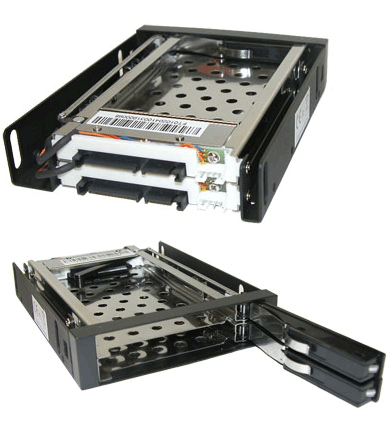

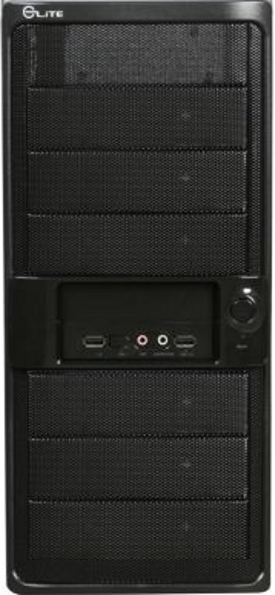

I happened across this double 2.5 inch hotswap bay that fits in a single 3.5 bay.  It kind of matches the Icy Dock bays.  Nice for running a pair of SSD's in raid 0 outside the unRAID array.  Could run some add-ons off of that nicely.
http://www.directron.com/mr2501d.html
I believe it is the Rosewill R-102-P-BK.  From the side they match up perfectly.  What makes it confusing is that queeg moved the power/reset buttons from their normal spot into the spot were the case's frontside USB and audio ports normally sit.  That's why the topmost pictures on this thread look different from the rest.  However, if you look at the skeleton pictures, you'll see the cutouts in that area are actually intended for the USB/audio ports.  queeg also must have removed the pieces of plastic separating the three upper 5.25" drive bays.
What do I win?  ;D
Winner!

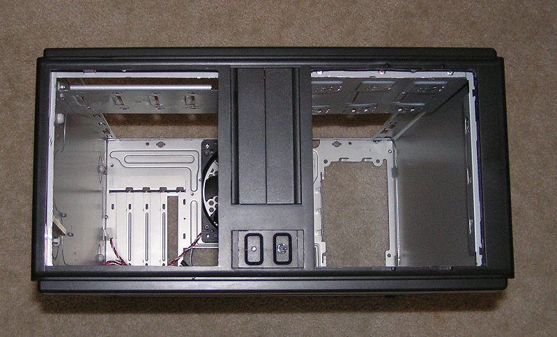

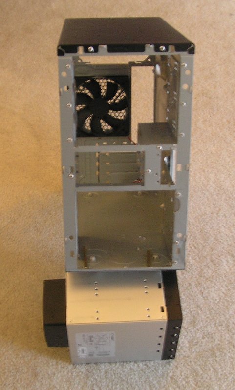

did you cut the front bezel as well as the metal plate behind it?
Can you show a picture without the front bezel and bottom hdd cage?
Nice work moving the power and reset buttons instead of the USB and sound connectors  8)
Yep, I had to cut all the layers. Cut, grind, sand, file, bend, drill, rivet.
The one you found has the power buttons and led's spread out.  It might be a little difficult to re-position them.  But the power button itself is nice.

Here is a picture looking through the front bays.
I could probably move the power and reset buttons to the same place you did, but I might have a problem with the front bezel where the 2 vertical plastic posts are running...

The black part of the bezel on the Thermaltake case bumps out further than the silver and it looks like it goes about 1/4 inch too low for a clean cut.  It looks like it would be necessary to cut into the bottom 1/8 to 1/4 inch of the black part.  Maybe that could be made to look clean as the top edge of the 5-in-3 sets into it but it would have to be done carefully.
The Rosewill case used to make the TinyTen is on sale at the moment for $22 + free shipping.

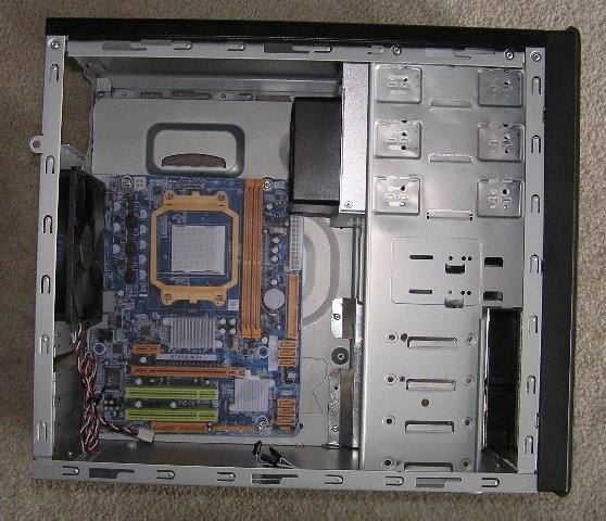

I happened to come across another case CoolerMaster 335 for the TinyTen collection.  Maybe this one should be the MidiTen :)  It's a little more stylish.  And there is one extra slot for the 11th drive or a BlueRay drive maybe.
It's a couple inches taller and about 3.5 inches longer.  It's probably the smallest FULL ATX case that can be modded to take 2 5-in-3 enclosures.  And it would have room for those long SuperMicro 5-in-3's and the AOC-SAT2-MV8 adapters.
It think it would be simpler to modify because the power button doesn't have to be relocated.  The front bezel in the cut out area is that wire mesh so under-cutting by say .5 inch and bending it back should be faster and easier than filing and sanding.  The internal bracket for the lower 5-in-3 would be a either a one piece u-shape (top and both sides) anchored to the bottom of the case or could be as simple as 2x 1 inch staps again anchored to the bottom of the case.

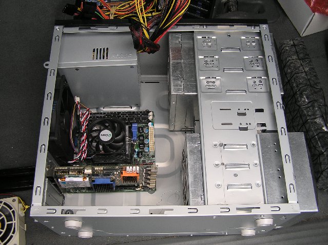

Here are a couple of pictures I took a while ago.  One shows an Icy Dock in the case.  The other shows two Supermicro cages and the psu is an Antec 380 that I had handy just to give some perspective.  The top Supermicro cage is pushed too far into the case because the bezel wasn't on the case.  The lower Supermicro cage is in the correct position.  You can see that there is lots of room between the psu and the 5-in-3 case.
