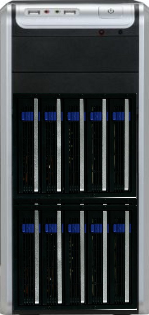

Hey Queeg, how about this guy?  It's got a lot going on with the plastic in front, but otherwise..?
Well it's thinner but not quite tall enough to make it a 12 bay.  This is also really preliminary as there is no telling where the bezel pegs are located and they can't be cut off.
That's nice, you could fit a single 5.25 removable for the parity drive.
A point to consider is where you put the extra PSU cable lengths.
That was a factor with the other tiny ten. I shoved them into the open spot between the icy docks and all was well. Otherwise they would have impeded air flow.

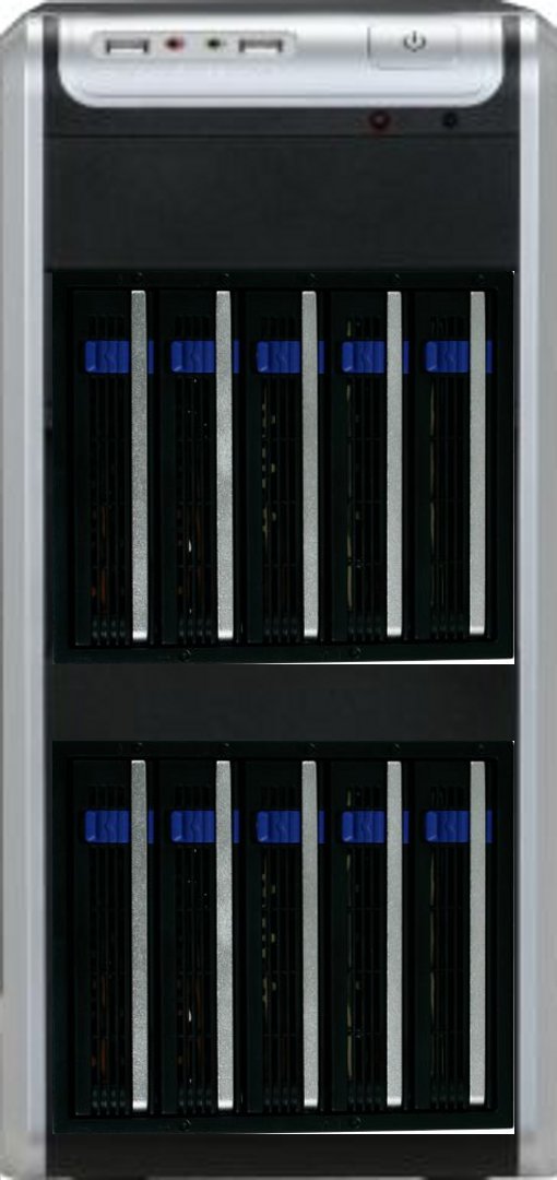

I'd probably want to move the top 5-in-3 up to the bottom of the first top 5.25 bay.  Then move the bottom 5-in-3 up some from the bottom.  Maybe leave a small gap between the 5-in-3's.  Here's an example.

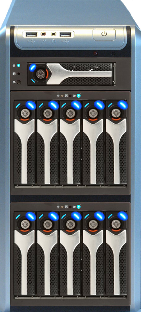

How about this?  Weebo, one thing I really want is to add a parity drive outside of the 10 data drives, so I've been lobbying Queeg about such a mod...
...one thing I really want is to add a parity drive outside of the 10 data drives, so I've been lobbying Queeg about such a mod...
I like that idea too.  Physically separating the parity drive from the other data drives makes it much more 'noob friendly' in my opinion.  I think it would be even better if the single drive slot were a different style or different color or something to further differentiate it.  Or if there are two spare slots, maybe designate one for a cache/warm spare as well.
If we could gain a second slot, we could put a 3 x 2 in there, adding room for parity disk and cache, and a spare / preclear bay.
I like the way this looks and is coming about, it all depends if it's do-able.
So.. is there an experimenter fund we can drop a few bucks in for queeg? LOL!
I do think that the parity drive slot should be the same removable as the others. it doesn't need to be that different. It's on top (or wherever the best airflow would be).
As far as cache/warm spare 3in2's. Entirely possible.  remember the 3in2's I had available a while back!
So a total trayless 10+1 or 10+2 would be sweet.
That is freakin beautiful!  One thing though...the bottom unit has to be a little higher.  The corners are rounded and the mods have to be on the flat part.
I tried but the Foxconn case doesn't have room for 2x 5-in-3's + 3-in-2.  The corners are rounded.  It's lacking about 1".
