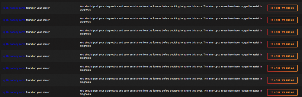

So I also have this popping up recently.  I started to ignore it all, but then Fix Common Problems decided to show 8 in a row. I don't have any BIOS updates available and there have been a number of other issues lately that have all generally been ironed out.

56 minutes ago, johnnie.black said:
Can't open your diags.
Weird, not sure what happened there - I couldn't open it either.  This one appears to be working - thanks again for looking!
manky-dreadful-diagnostics-20181203-1420.zip
Yes, those work.
There's an USB 3 controller using that IRQ, nothing else of importance, so if everything is working fine you can ignore for now, if you have issues with any device using an USB 3.0 port change it to another controller/HUB
