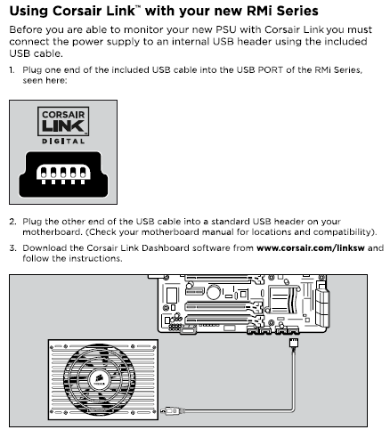

I've had disks drop offline in a similar manner while using a older multi-rail PSU that could no longer supply rated amperage to each rail.  Mind you, I think Johnie's suggestion to try another slot is the obvious next step, but since this situation is puzzling here's the PSU information:
I don't know whether the RM650i defaults to single or multi-rail.
I missed the RM650i has a configurable 12v rail, single or multi, when first looking at the specs only noticed the second box, I did think it was strange since most Corsairs are single rail, in that case I would guess single rail is the default.
