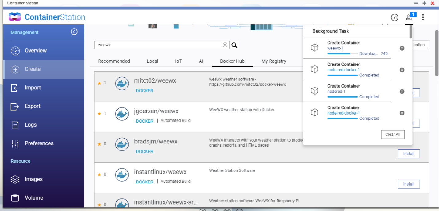

Anyone? or how to get those containers into Unraid? seems like QNAP has those options
image.thumb.png.45017718fb0214c9a9256230b7de044f.pngThanks
