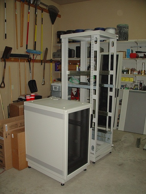

I got 2x 7-foot racks from a buddy that was moving a data center. They were no longer needed and they were fully depreciated so the company just wanted to throw them out. I helped him throw them out in the back of my pickup! They came with 4 UPS's a KVM and a slide-out keyboard/mouse.
They were too tall to fit into my server "closet" which is under the stairs and the door's too low. I ended cutting off the top, cutting the 4 posts and welding the top back on. I cut the sides down to match. The only hard part was cutting the doors down - had to take the frames apart and cut both ends off because the locking mechanism was in the middle. I cut the bars that lock top & bottom, ground new gears into the bars so they go up/down when you turned the handle, cut the mesh insert off, put it all back together and I had a nice short rack that holds my 3 servers, 2 UPS's, slide-out keyboard & KVM switch. A little spray paint where I welded it up and it looks like it came that way (picture attached).
The other rack is in the garage still waiting for my next project.
Ask around, talk to people who work in a data center. One will pop up. The 2 I got were my 3rd chance so I thought I'd better just go ahead and get them. Don't pay for one.
