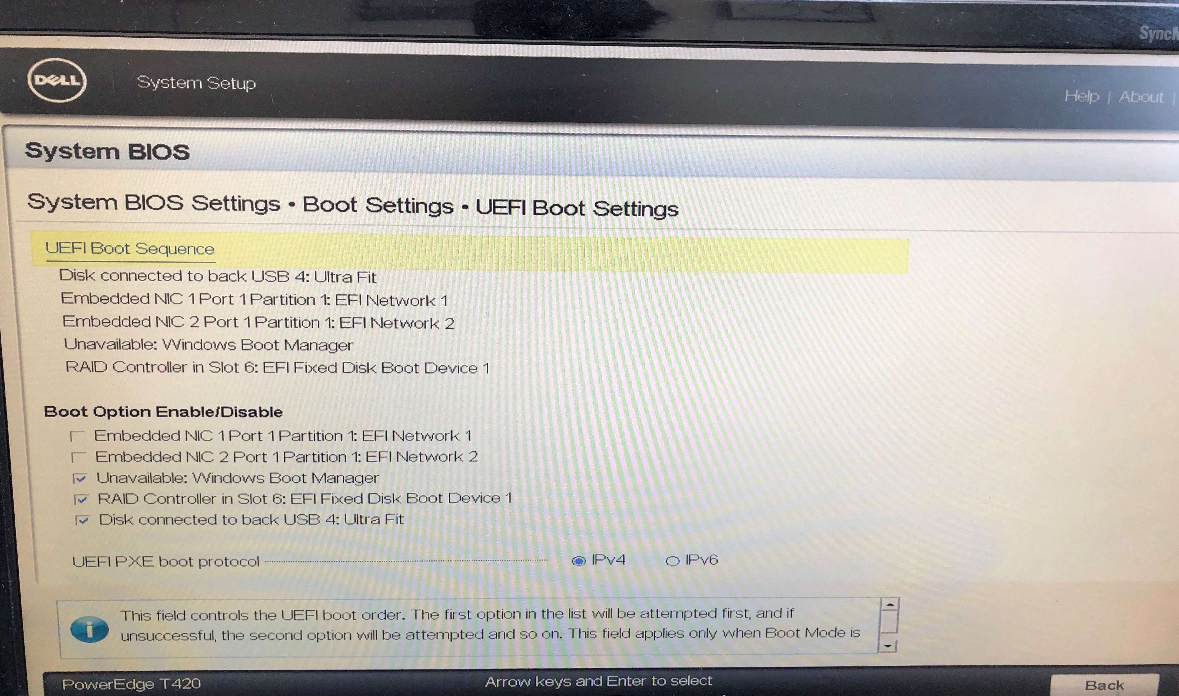

  1. Created a 6.3.5 USB using the USB creator tool for windows. Started the Trial for 2 weeks with MBR BIOS boot.
  2. Saw that the new stable 6.4.0 was out, used the WebGUI to update
  3. Reboot required
  4. Upon loaded WebGUI enabled UEFI in the Flash media on main page (so far so good) Reboot
  5. (Set Server BIOS settings to default) Changed my Servers BIOS system setting to boot to UEFI
  6. Deleted previous UEFI boot menu paths (Windows, ESXi..etc)
  7. Created a UEFI boot entry pointing to /EFI/Boot/Boot64.efi (1st attempt I did not create a UEFI boot path same result)
  8. Rebooted server
  9. UnRaid Boots up in UEFI

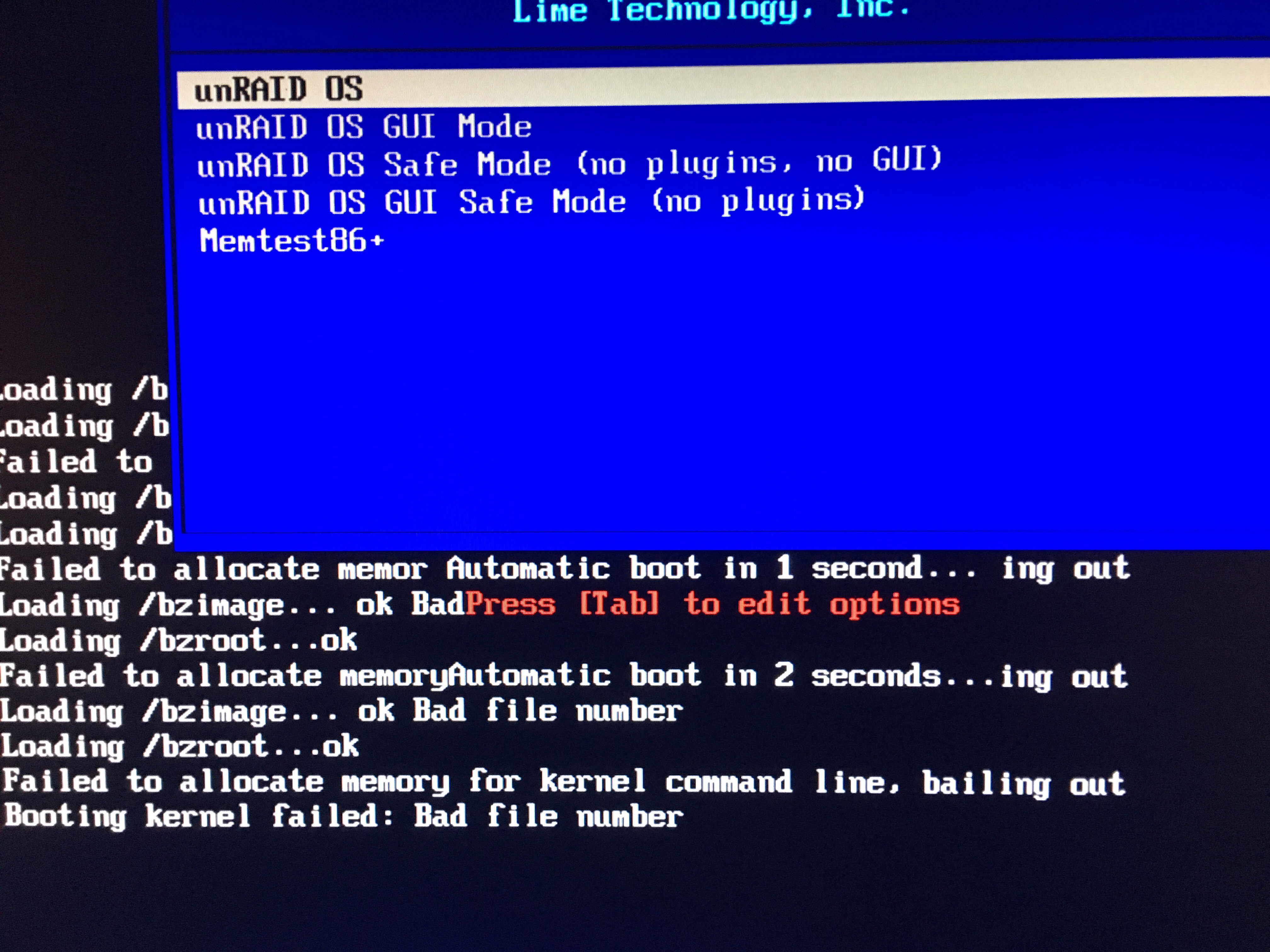

  10. Auto boot count down
  11.  loading bzroot...ok
  12. "Failed to Allocate memory for Kernel command line, bailing out
    booting kernel failed: bad file number"
I had this same issue prior to starting the trial creating a 6.4.0RC19 Boot usb. Just I knew there was not going to be any support for a BETA now that 6.4.0 is stable any Ideas or possible solutions.
I should also note that all of the boot options including memtest all have the same failed message as above.
I can only Tab to edit >/bzimage initrd=/bzroot_
I really don't want to be stuck using legacy boot mode. Thanks in advance to any suggestions or help.

> the message comes from main.c when allocate_pages() fails.
> allocate_pages() is just a wrapper that calls BS->AllocatePages.
http://www.syslinux.org/archives/2015-April/023398.html
http://www.syslinux.org/archives/2015-May/023466.html
https://github.com/geneC/syslinux/blob/master/efi/main.c

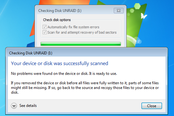

As a precaution you could check & repair your USB device on a Windows or Mac computer to ensure it is free from corruption.
So I removed Mushkin Higher speed non-ECC Ram, Same issue. I did Check the USB and I have FSCK000-FSCK0010 REC files... I back them up. I even backed up the whole USB drive. Created a new 6.4.9 USB wEFI overwrote the Config folder with backup. Same.

[UPDATE] Day 2 11:25p EST
After resetting Setting Server BIOS defaults, turning off Lifecycle controller, Disabling the PERC310 RAID controller, changing Memory type settings, Removing the memory, adding it back in, Rebuilding the bootable USB, Diskpart clean USB, and other frustrating settings, I lost BIOS BOOT and I do not see my usb in the BIOS boot order, I keep getting not a bootable device try again. This is part Why I really would like UEFI support from the Kernel command line. Server BIOS is not the same as a traditional Desktop BIOS and UEFI just Boots right up no issues or questions asked.  If you forget to enable the tiniest Legacy BIOS server setting it throws everything offline.
In this event before I turn off the lights, thrown in the towel and call it a night, I have discovered that LifeCycle Controller needed to be updated along with 6 others(Driver Pac, RAID update, NIC update, iDRAC update, UEFI DIAG update) .. Other than just the BIOS..  So I am running that. Still open to any suggestions to try for a resolution.

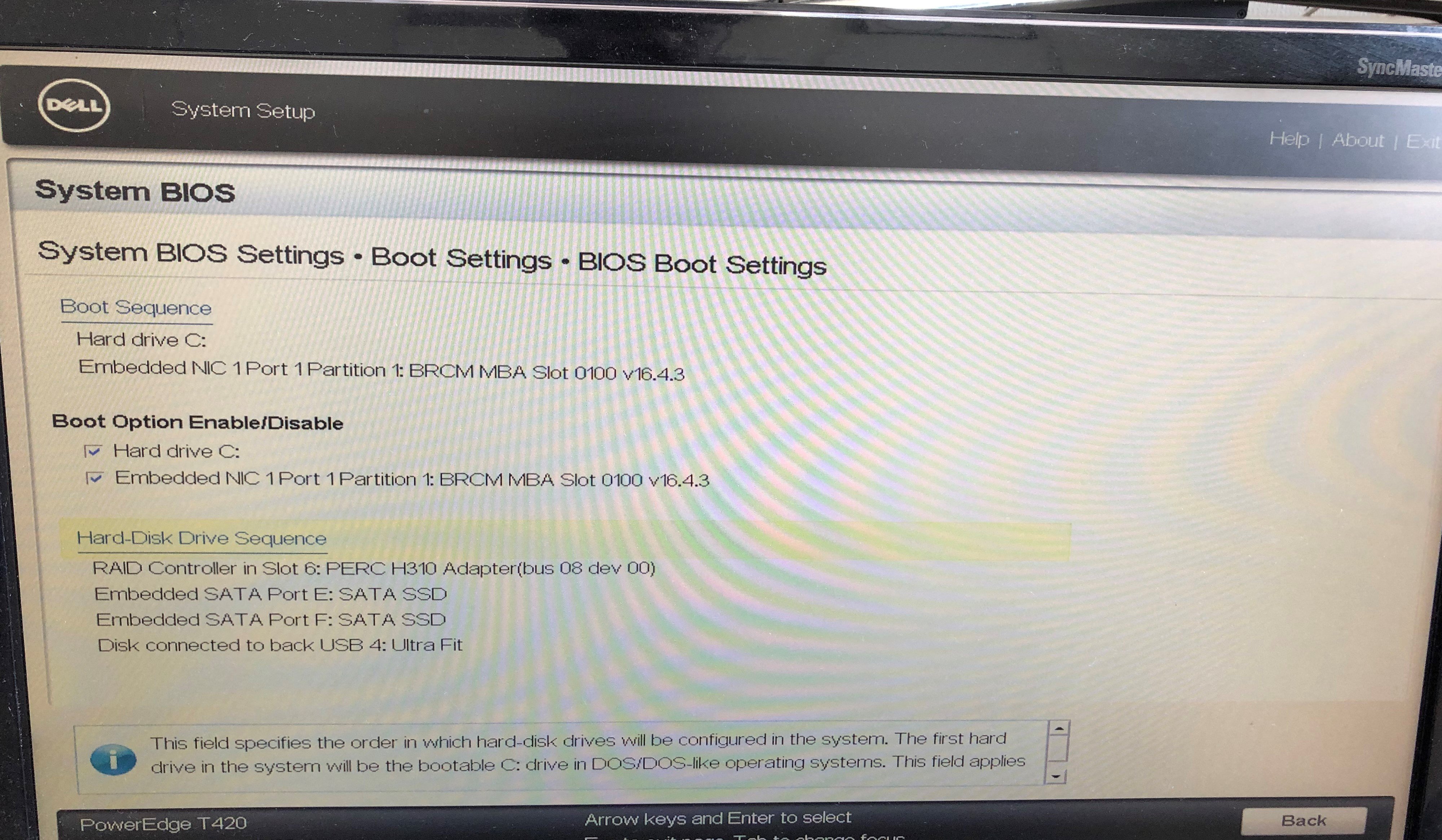

So New (previously owned) Motherboard Came in, Yesterday, All is working
Took me a bit to set up the BIOS legacy boot...
