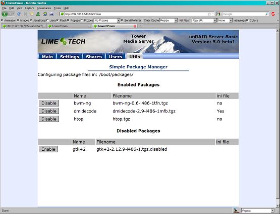

Some suggestions to get the ball rolling
I was looking for a solution that would let packages be installed w/o having to consult a different file (either contents or filename).... But using the ini file as the disabling key is fine if that's what you guys prefer, but what about .tgz files that have no .ini file?  To disable that .tgz, you have to create a (minimal) .ini file with the .disabled suffix?  That seems doable.  But in that case, I'd lean towards the .ini files being in the same dir with their associated package file.
Perhaps we go simple at the beginning... using ".disabled" on the .tgz files for now, and plan to add more sophisticated control via the .ini files as we get further down the field?
I'm still a bit confused about the example "airVideo" ... are you saying all those .tgz files are in the .jar zip file, and to install it, you have to extract them all from the zip, and installpkg each one?

>> Please, do not ask me to try re-name a full set of 14 .tgz files if we wish to enable, or disable a package.
There seem to be two definitions of package here.
We have the slackware package which is the root of supportive constructs.
We have the "managed" plugin package which contains definitions to describe a package(plugin) which would "require" one or more supportive packages.
For the supportive slackware package renaming them is something I would do.
Now for the plugin,
  you have the choice of renaming the .ini file so the plugin manager will not process it.
  updating a variable in the INI file STATUS=DISABLED so the plugin manager will not process it.
  or have the plugin manager rename the list of required support packages.
  You do not have to rename 14 files, The plugin support facility should handle it in one of the manners.
Also, no one has to update slackware packages to include the .ini file.
It's only an option and if they choose to do it that way for simplicity, then they must insure it does not overwrite an existing .ini file.
I really don't see people including it. I would expect the package repository to present one for downloading to a directory hierarchy then being smart enough to download the slackware support packages or know they exist locally and are enabled for install.
This works for now.

No, it does not work for now.  It ONLY works if you do not use /boot/packages or have no existing packages
I have these, and no way do I think re-naming them is "easier for now":

So how about using the .tgz and .tgz.disabled for now, using standard .tgz slackware packages.  That is the closest to the current package handling in unRAID.  That way we can get the first iteration of installpkg iterations into unRAID now, and refine it as we move forward.  It makes the entire workd of Slackware packages immediately usable.
Note that dependencies are part of the standard .tgz Slackware package with the slack-required file.  Once we build dependencies checking to handle that, it should be easy to refine it so that .ini files can do it too.
More sophisticated .jar and .zip distributions will be handled with something more intelligent to be developed later.
Joe, if what you have works in unRAID 5.0, then nothing stops you from using it.... so what is the issue if others use something else as a standard?  Hell Latrtisnet continued making their non-standard 10BaseT hubs for years after the standard was adopted that did not include what Lattisnet proposed.
When Tom first posted about having to use Ruby in unRAID 5, I didn't like it, but I was willing to go there since that was what made Tom's life easy.  I was pleasantly surprised when 5.0 was actually php based.

Renaming them in a pinch is a small find or script.
You can also move them to a "bak" or "disabled" directory.
The find in the rc.local script does limit it's search to a -maxdepth 1
A disabled directory would work also.
If these were in the /boot/extra directory you would have no choice but to move them out of there.
There's nothing wrong with renaming them. where and how is open.
If they do not conform to the supported package extensions that installpkg supports, skip them. Done.
That slackware package is now disabled from being installed.
This should be that way no matter what.
I refuse the sit there and make a .ini file for every package when I can mv it.
What I would expect is for a plugin manager to handle this all for me.
So renaming them is not something you would have to do, the plugin manager would do it.
And if there is a plugin manager, the files will be defined in the .ini file.
Further along these lines, if there is an ini file, that can be renamed or a state variable can he set within.
It seems straight forward to me.
Perhaps I'm not understanding of the resistance. A further explanation would help.

How about if the package manager defaults to saving downloaded packages as disabled when it saves them to /boot/packages?  Or perhaps, if a package is found w/o a .ini file, the server disables it the first time it sees it (when running the install events), so the user has to go into the UI and enable it?  Or REQUIRE a .ini file, and the UI or package mamager can create a minimal one if there is not one in the package itself.
/boot/<boot package dir>   <--  slackware package files (for now) or other types of packages in the future.
                                              server/emhttp runs the install command (installpkg or somethign else specified in the .ini)
                                              rename to .disable to disable.
                                              NOT loaded if server is put into safe mode.
                                              anything not a Slackware package MUST have .ini file in order to run
                                              .ini files live in same dir.
                                              .ini file name same as appname from package file.
                                              Default install command is installpkg, but .ini can specify a different install command.
                                              rename to .disable WILL disable them (overriding .ini).
                                              NONE are loaded if server is put into safe mode.
                                              package manager always puts new packages here as DISABLED.
.ini files
- specify install command
- specify the event commands (can be single command with parameters or individual scripts).
a simple package manager will:
 - detect different versions of same package.
 - list packages in the UI
 - do enable/disable of packages
 - can run the appropriate install command on packages interactively.
I have a simple package manager done.... I'll make it into a package with some other utilities soon.
