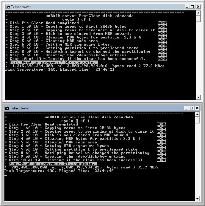

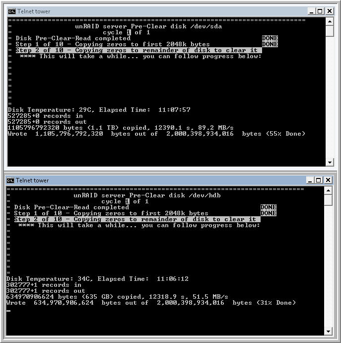

July 30, 201016 yr Author As a side note, your drives are taking a VERY long time to finish a cycle. Comparatively, my Hitachis do it in about 30 hours, and my Samsungs do it in 36 hours. This is really good to know aiden. I thought for sure the new hardware would help speeds things up here and for the Samsung drive I think it has. However, something does not look right with the WD drive. It seems to be moving at exactly half the speed of the Samsung drive and has been for hours. I started the preclear at the exact same time on both drives. See attachment.
July 31, 201016 yr 51.5 MB/s on the outer 1/3 of the platter is pitifully slow. Even if that is a 5400 rpm drive, at that location on the disk you should be seeing at least 70s. There are numerous possibilities for the slowdown, like a bad sata cable, bad controller port, or simply a bad drive. I'm sure Joe or Weebo will have a much more succinct theory than I do. But I would at least look at trying a simple cable swap and seeing if that changes anything.
July 31, 201016 yr Author Thanks aiden. It certainly seemed like something was wrong to me as well. It seems to only be attributed to writing on the WD drive. Both drives are now at the post-read stage and they are both performing at about the same level (~80 MB/sec).
July 31, 201016 yr You have one of your disk controllers set in your BIOS to emulate an IDE drive in an legacy mode. It is why the disk is showing as /dev/hdb instead of /dev/sdX. That emulation of an old master/slave controller in the BIOS is there so the motherboard can boot older Windows operating systems. They have no SATA drivers and therefore would not be able to boot if they did not (think they) see an IDE hard disk. We have no need for that kind of IDE emulation, and in fact, it might be causing the slower performance. You should set the BIOS to ACHI mode for the SATA disk controllers.
July 31, 201016 yr Author Great catch Joe. Thank you. I won't be able to update it and do another preclear until I return from out of town (tomorrow). I guess this does have me wondering though, could the preclear succeed without ACHI on this drive? If so, I assume I wouldn't need to do it again, would I?
July 31, 201016 yr Great catch Joe. Thank you. I won't be able to update it and do another preclear until I return from out of town (tomorrow). I guess this does have me wondering though, could the preclear succeed without ACHI on this drive? If so, I assume I wouldn't need to do it again, would I? You would not need to do it again. Joe L.
July 31, 201016 yr However, something does not look right with the WD drive. It seems to be moving at exactly half the speed of the Samsung drive and has been for hours. I started the preclear at the exact same time on both drives. What model of WD drive is it? If it is a WDxxEARS, then slow writes could be the result of misaligned sectors because of the 'Advanced' format. With an EARS drive, it is important to install a configuration jumper on pins 7-8.
