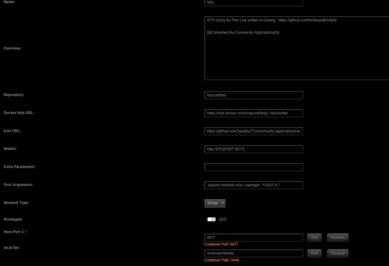

It does seem promising, the dev on Reddit messaged me and told me the update tonight should allow for URL support of the m3u file, still hoping someone can make a clean unraid container, but the Telly itself sounds very very promising for a perfect use.   Definitely interested in where it goes.  Can someone interpret how to properly place the commands and variables on the current docker available?  What should go where in order to make it work in unraid properly?  I dont fully understand that.
Another user on a different forum posted a screenshot of how they setup their container, and that should help configure the container, the only difference would be to enter an http url instead of an actual file on the -playlist argument, but its a good starting spot

Just to make it a little simpler, here is the config I am using right now and it is working as expected.  Again there is probably a way to pass the arguments via the variables but I could not get it to work, hopefully somebody here can build a proper container and get it listed in the Apps by Squid.  I think there was some mention that there might be a new docker coming from the original developer so all commits get automatically updated... still waiting for it under tombowditch/telly

Porkie was able to take good part of that configuration, the only thing missing was adding a path for /tmp to a directory either in appdata or on a user share which is where Telly is supposed to download the m3u file when using an URL.   That part still I think is a work in progress.

Pretty much works perfect for me now using Tom's docker hub and template.  In Unraid just add the template url to the Main page and then using Squid's App's plugin, search for telly and then make sure to enable docker hub for more results.  Input the the paths and variables and you are in business.  I think the only official thing to do to make it Unraid official is to have it listed with Squid's App plugin and maybe get it's own support page on Unraid.  Thanks for all your work Tom!
