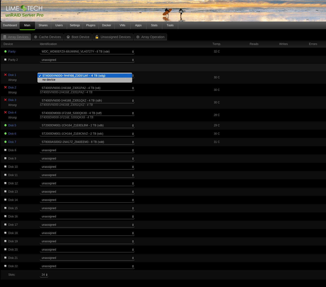

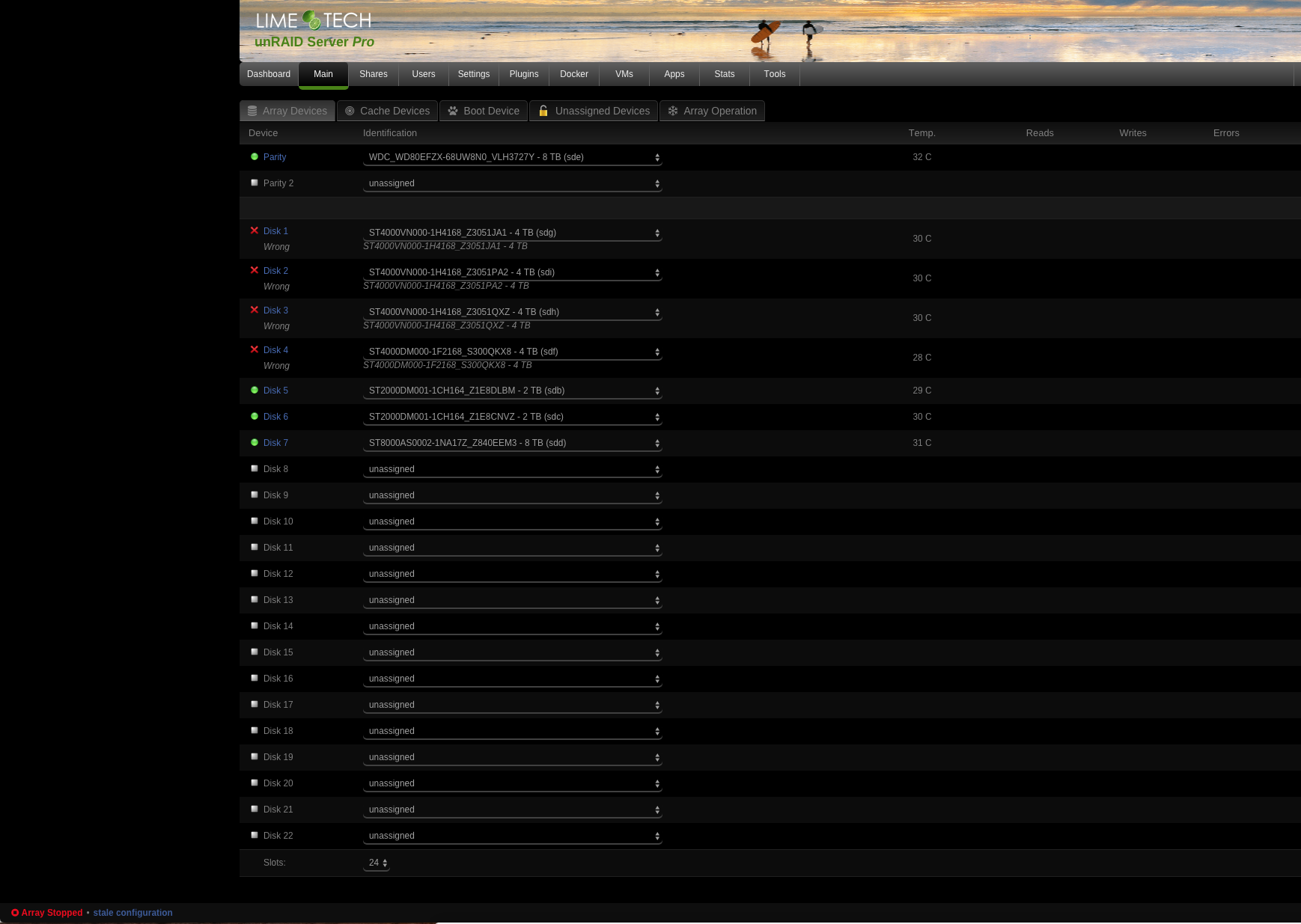

So I have a larger issue now, I thought it could have been my adaptec controller perhaps doing something strange, so i checked the forums and saw a number of posts saying as of unRAID 5 the disk ID's are done using the serial numbers, so it shouldn't matter what SATA ports they are changed to. As long as I restart the server with all the same drives connected.
I had my two 8TB drives on my SATA ports, with my other 6 drives connected to my adaptec card, so as a test, I shut the server down, disconnected 4 of my drives from the adaptec card, and connected them to my 4 remaining SATA ports on my MB, so now 6 on SATA and 2 on the adaptec.
I restarted, updated my JBOD config to confirm the two remaining disks - all ok ..... however now in unRAID its saying I have an invalid array configuration (stale configuration)
I've attached what I see in my dashboard, and when I select one the disks that it says is wrong, I just get the drive name or 'no device'
I really don't want to lose my data, so if someone could point me in the right direction that would be a great help.

@johnnie.black after reading through some other posts about the 'wrong disk' issue, it seems I may need to do a new config while preserving the parity slots? I'm really at a loss as to what to do on this one now.
this post looks very similar to my current issue:
The problem is that the Adaptec controller was not using the total disk capacity, they were slightly smaller:
  => 3907018532 -> current size
 [status] => DISK_WRONG
 [sizeSb] => 3905935308 -> previous size
This is one of the reasons RAID controllers are not recommended, HBAs only, if you do a new config you'll get unmountable disks because the existing partition will be considered invalid.
You'll need to leave the disks as they were or rebuild one by one after changing controller, so unRAID can expand the partition and filesystem.
Yep fair enough, lesson learned I guess.
ok so as it stands right now, with the 4 disks being marked 'wrong', can I rebuild them one at a time from this current state? As my 8TB parity disk is valid, will I lose any data that's on any of those four 4TB disks that are currently marked as wrong?
Is there an existing guide to assist me in how to rebuild one disk at a time in the current state my disks are in?
Also I really appreciate you taking the time to assist me trying to get this fixed  @johnnie.black
You'd need to connect all but one of the wrong disks to the original controller, then start the array to rebuild the remaining, when done, repeat the process one by one.
