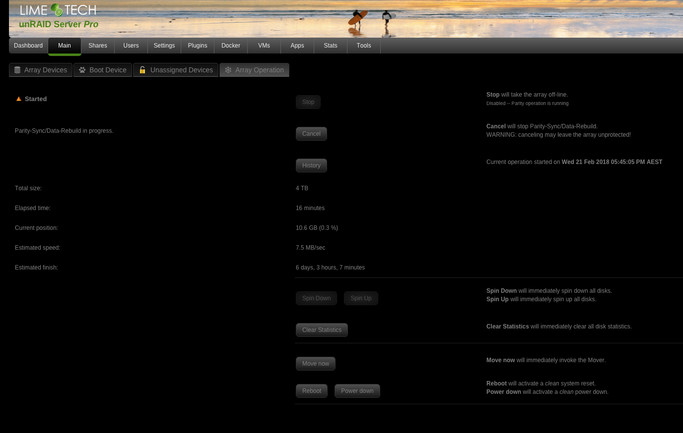

OK I've connected 3 of the 4 drives back to my Adaptec, left the 4th connected to my onboard SATA, and have started the rebuild on that drive.
6 days ..... FML! haha :)
That's very slow, probably the same issue causing your performance issues, likely nothing there but grab the diagnostics during the rebuild so we can take a look.

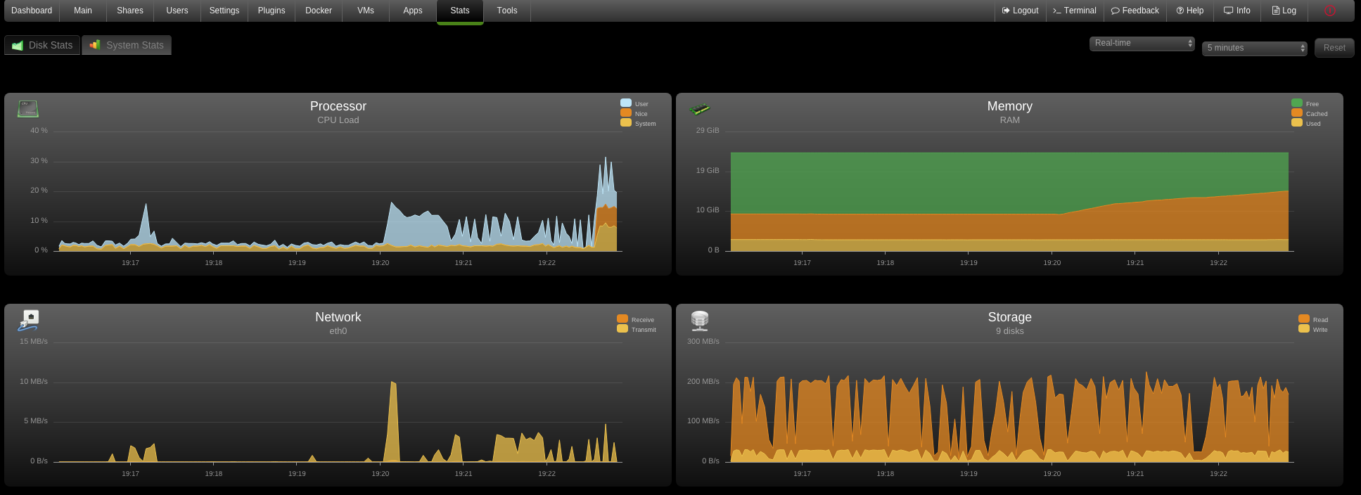

Here's my diagnostics
unraid-diagnostics-20180221-1923.zip
heres a screen of the stats dashboard
No errors on the logs, but during the rebuild there's heavy simultaneous write activity on two disks (disks 4 and 7), this explains the low speed, you should stop or at least severely limit array activity during the rebuild.
@johnnie.black Thanks so much for looking at the diags again .... the only thing thats currently happening on the server, is just watching a movie through Emby using my Roku, so the writes could have been the transcoding of the video.
Could you tell me where exactly in the diags you saw this info about the writes?
system\vars.txt
diskload
    [sda] => 0 0 2576 80
    [sdb] => 27448661 0 578064 345
    [sdc] => 20212394 0 560295 219
    [sdd] => 20290218 79872 569157 2065
    [sdf] => 20212394 0 554050 27
    [sde] => 20212394 0 554061 17
    [sdg] => 20247210 146090 491120 139905
    [sdh] => 20472490 228010 503797 122016
    [sdi] => 0 20327082 212 311418
Read speed and all disks involved in the rebuild at around 20MB/s
Write speed om the disk being rebuilt also around 20MB/s
Extra write activity
