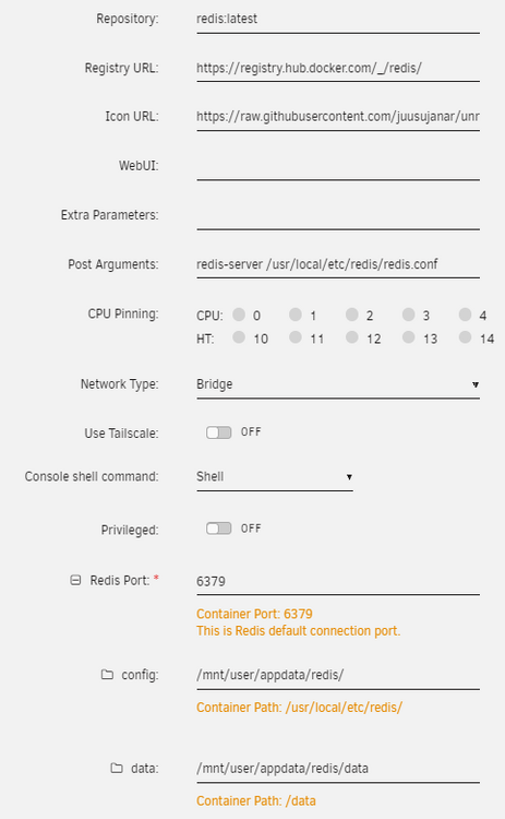

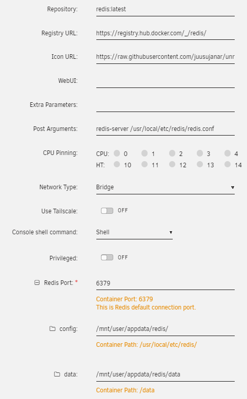

September 10, 2025Sep 10 On 1/21/2023 at 2:11 AM, spidobot said:having the same issue with redis.i created a file-link between my docker and unraid and created a redis.conf file.when starting i also recieve the message, that there is no redis.conf specified. if i try to load my custom-conf-file into the redis-server, it aborts the loading, because it is already listening to the 6379 port.it there a way to tell the docker on startup to load my custom config?if it post "redis-server /data/redis.conf" in the post-arguments redis wont start at all. does anyone have any ideas?Just started my redis journey. After hours of experimentation, I use following template to make Redis use my customs redis.conf file:My redis.conf settings are:# NETWORKINGbind 0.0.0.0port 6379protected-mode no# SECURITYrequirepass ..yourpass...# MEMORY MANAGEMENTmaxmemory 512mbmaxmemory-policy allkeys-lru# PERSISTENCEsave 900 1save 300 10save 60 10000appendonly yesappendfilename "appendonly.aof"appendfsync everysec# LOGGINGloglevel noticelogfile ""# DATABASESdatabases 16# SNAPSHOT LOCATIONdir /dataPlease note that your password should not have any special characters to use it easily with redit command lineto run redis command line from unraid host, you can start with command:docker exec -it redis redis-cli -u redis://default:yourpassword@localhost:6379/0 It will give the following prompt, and you are now ready to issue Redis command, e.g. config get maxmemory redis-cli -u redis://default:yourpassword/0Warning: Using a password with '-a' or '-u' option on the command line interface may not be safe.localhost:6379> CONFIG GET maxmemory1) "maxmemory"2) "536870912"localhost:6379> Edited September 10, 2025Sep 10 by bthoven

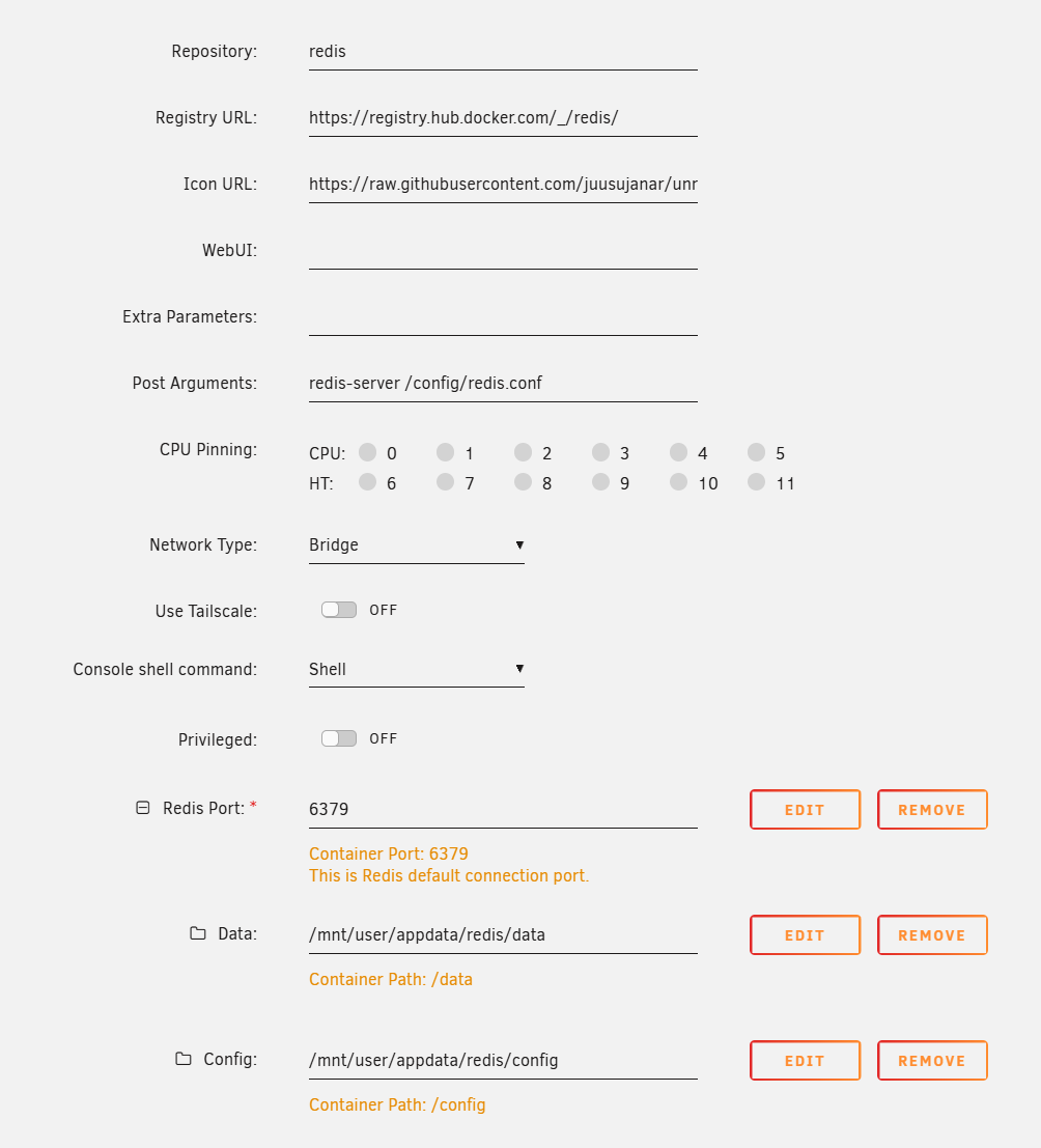

September 11, 2025Sep 11 I'm struggling to get this container to start when I specify my config file in the post arguments. It just throws the following in the logs:1:C 11 Sep 2025 22:16:31.208 # Fatal error, can't open config file 'redis.conf': No such file or directoryHere's my container config:I must be doing something silly, but I can't spot it!Anyone got any ideas?
September 11, 2025Sep 11 4 minutes ago, CodeThief said:I'm struggling to get this container to start when I specify my config file in the post arguments. It just throws the following in the logs:1:C 11 Sep 2025 22:16:31.208 # Fatal error, can't open config file 'redis.conf': No such file or directoryHere's my container config:I must be doing something silly, but I can't spot it!Anyone got any ideas?AAARRGGHHH the example redis-full.conf from the website has the following at the top and I didn't notice:include redis.conf loadmodule ./modules/redisbloom/redisbloom.so loadmodule ./modules/redisearch/redisearch.so loadmodule ./modules/redisjson/rejson.so loadmodule ./modules/redistimeseries/redistimeseries.soRemoving that lot fixed the problem!
