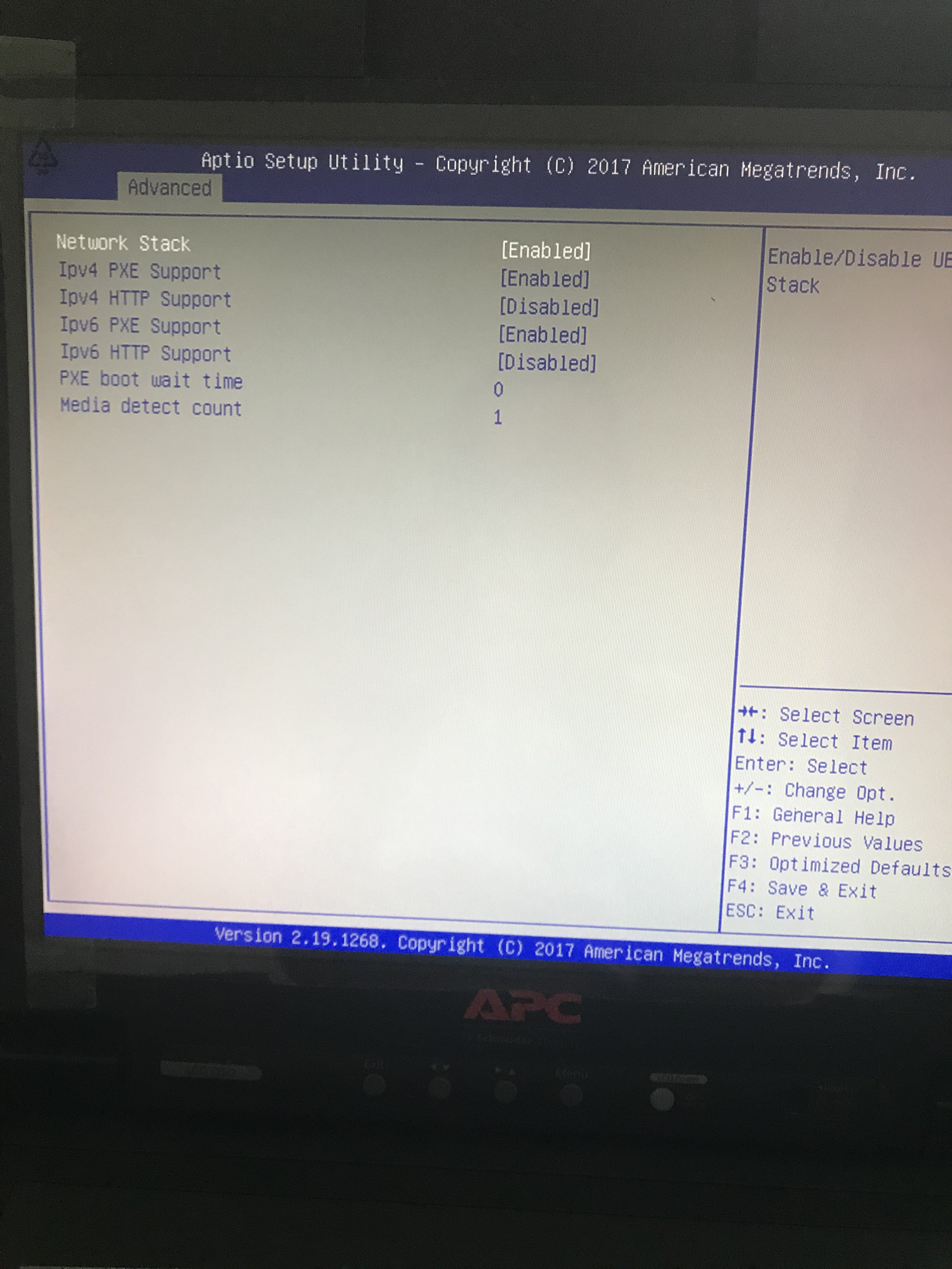

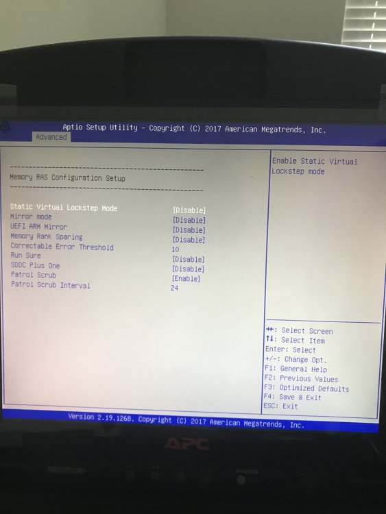

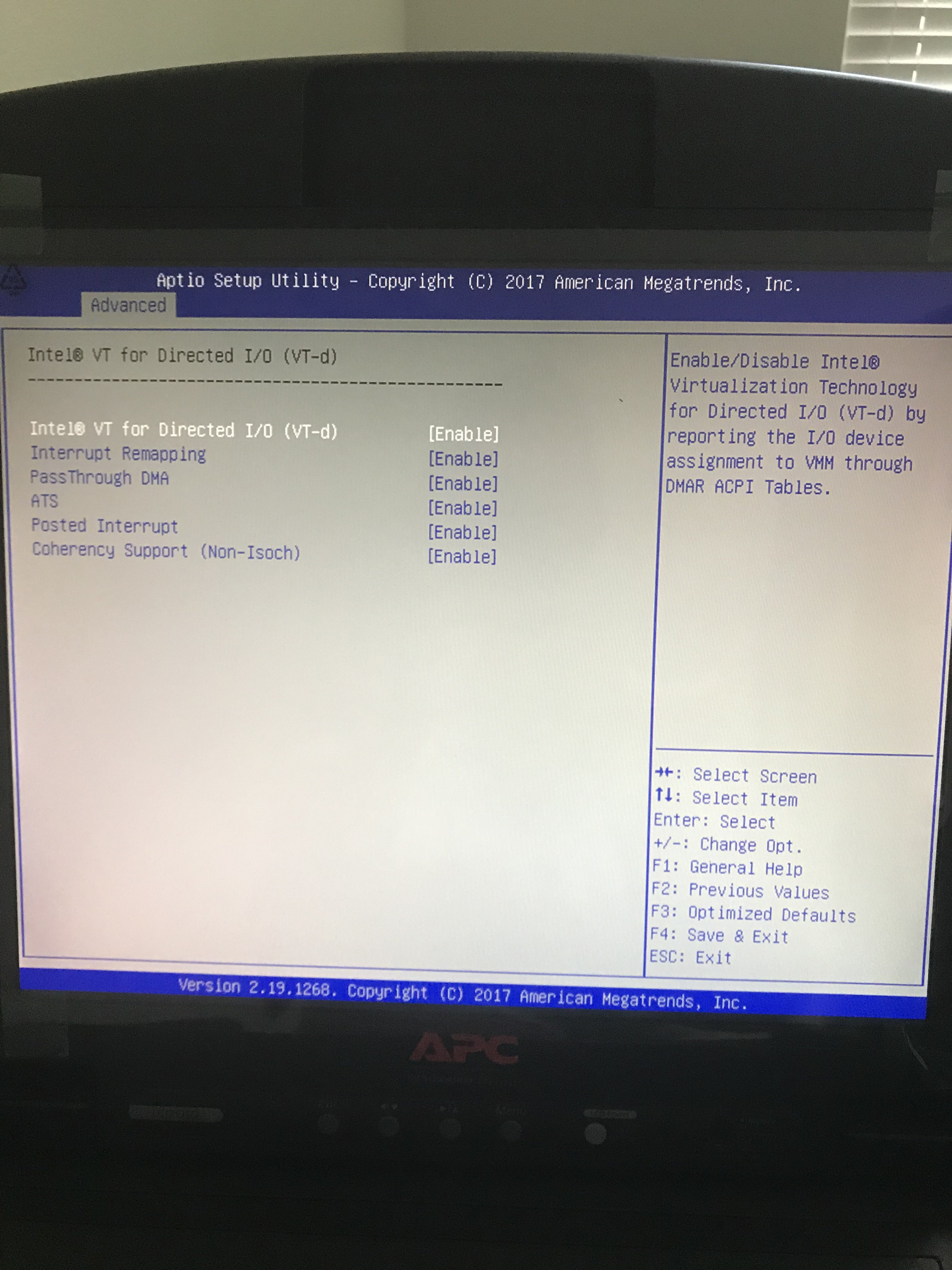

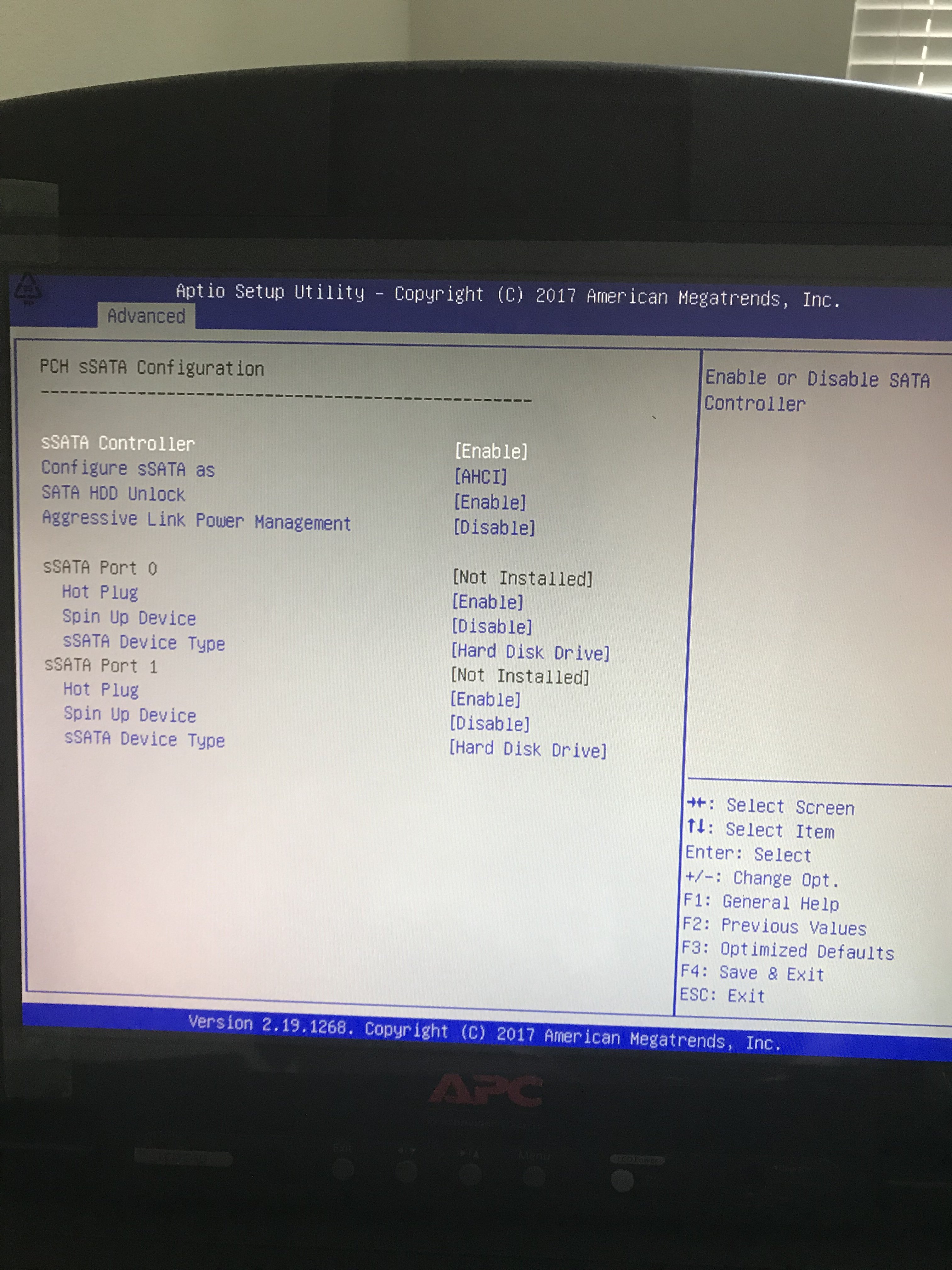

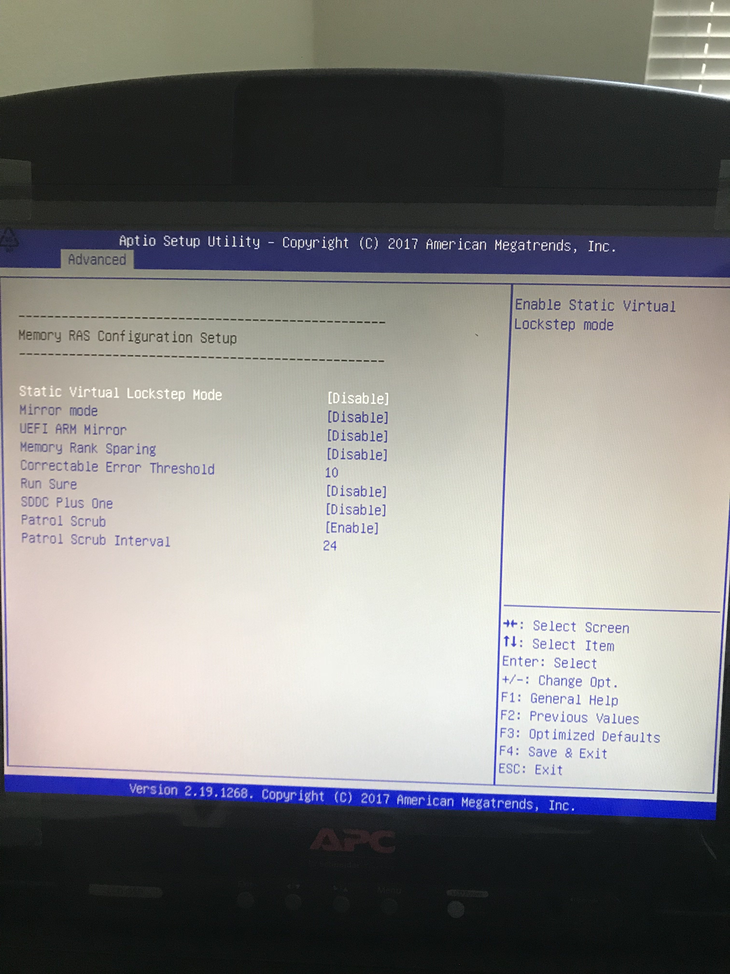

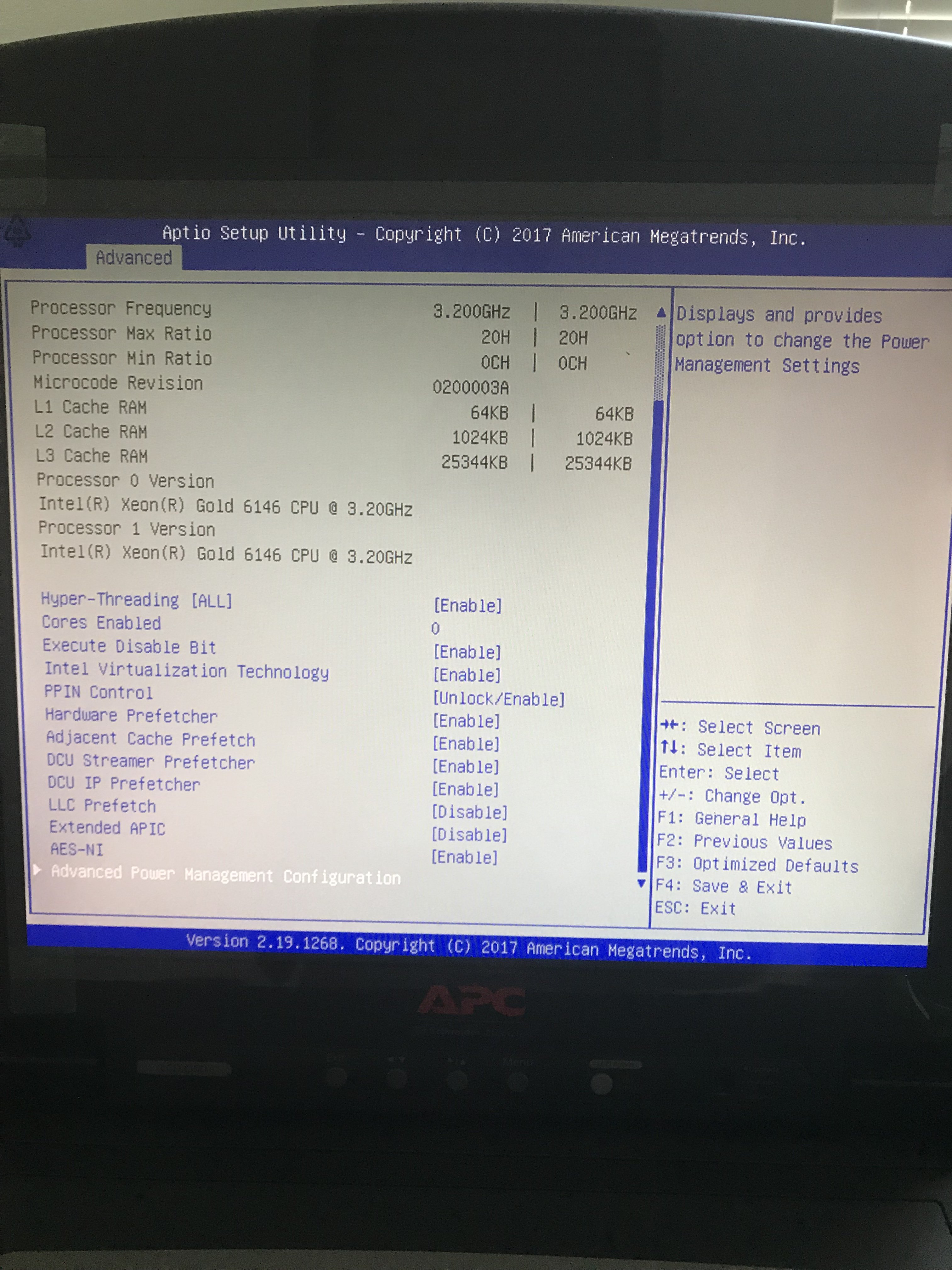

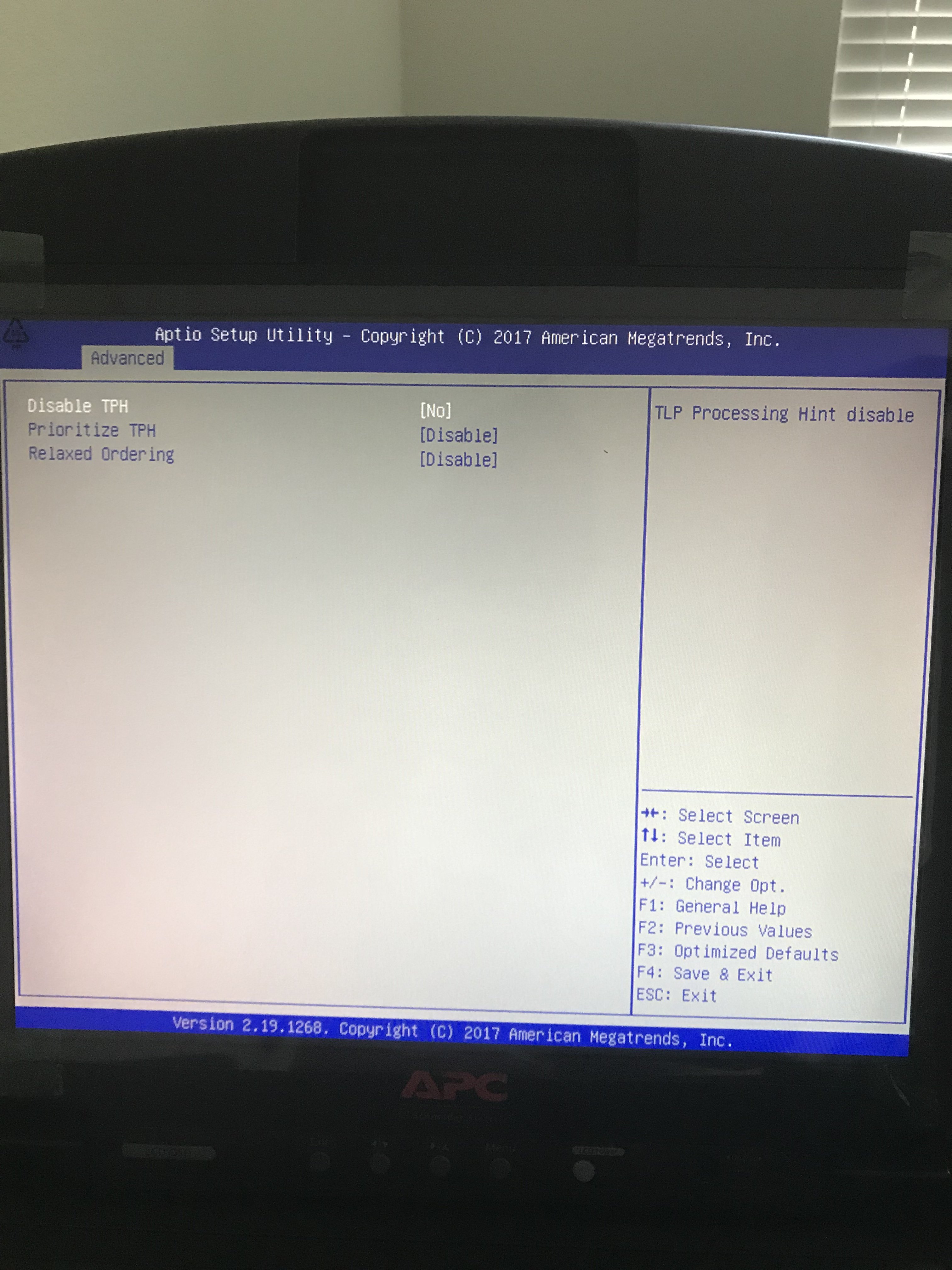

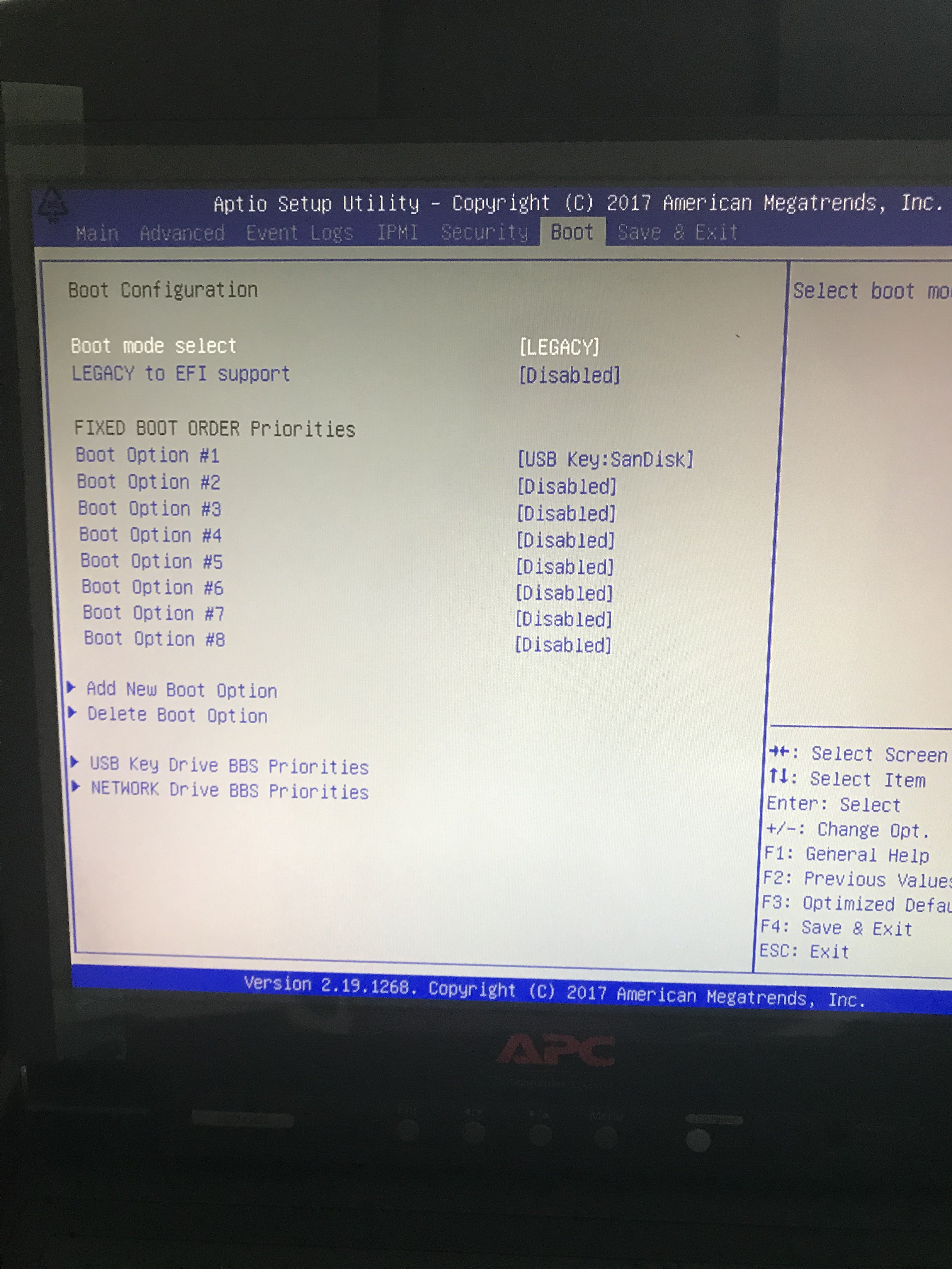

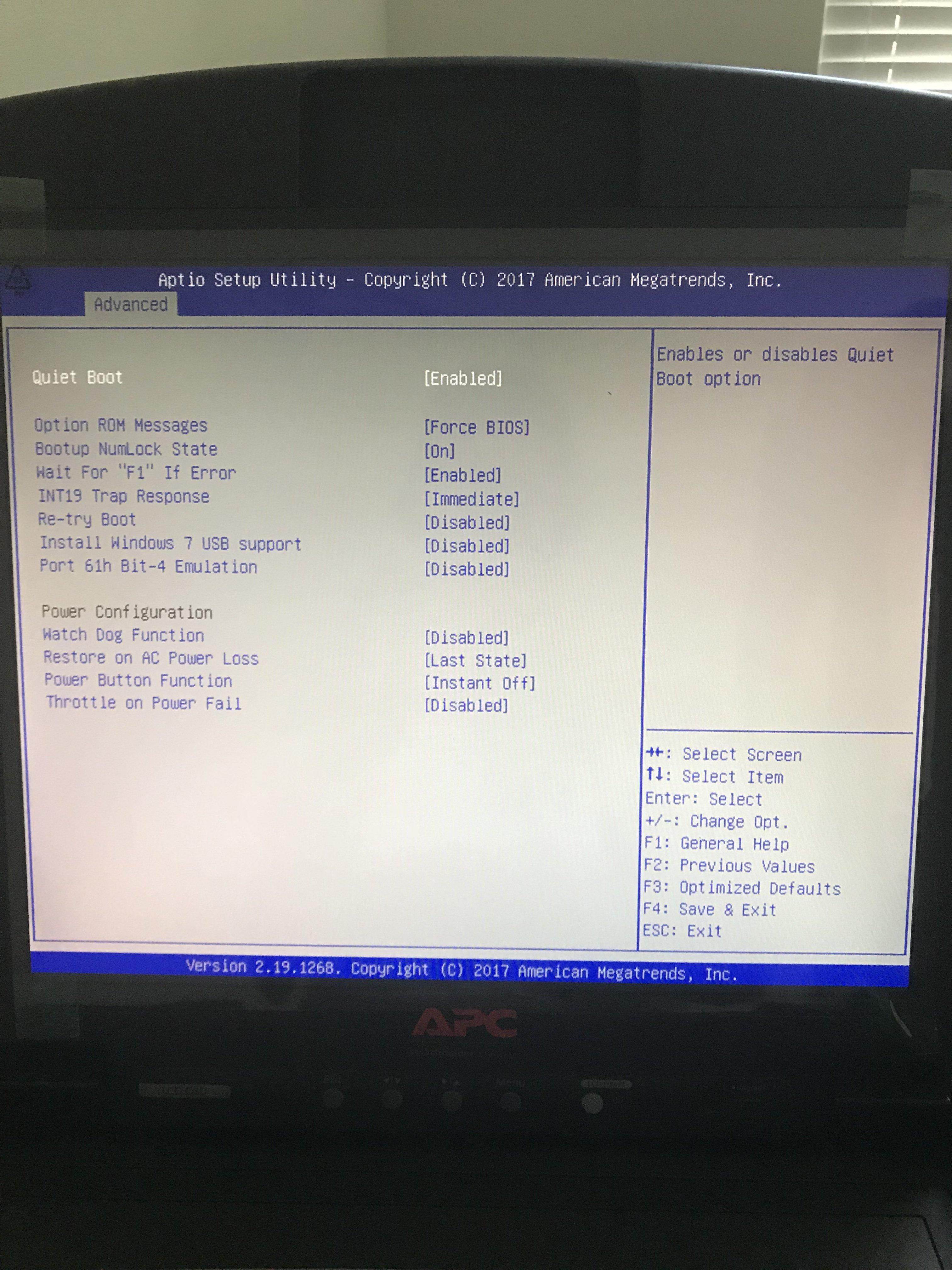

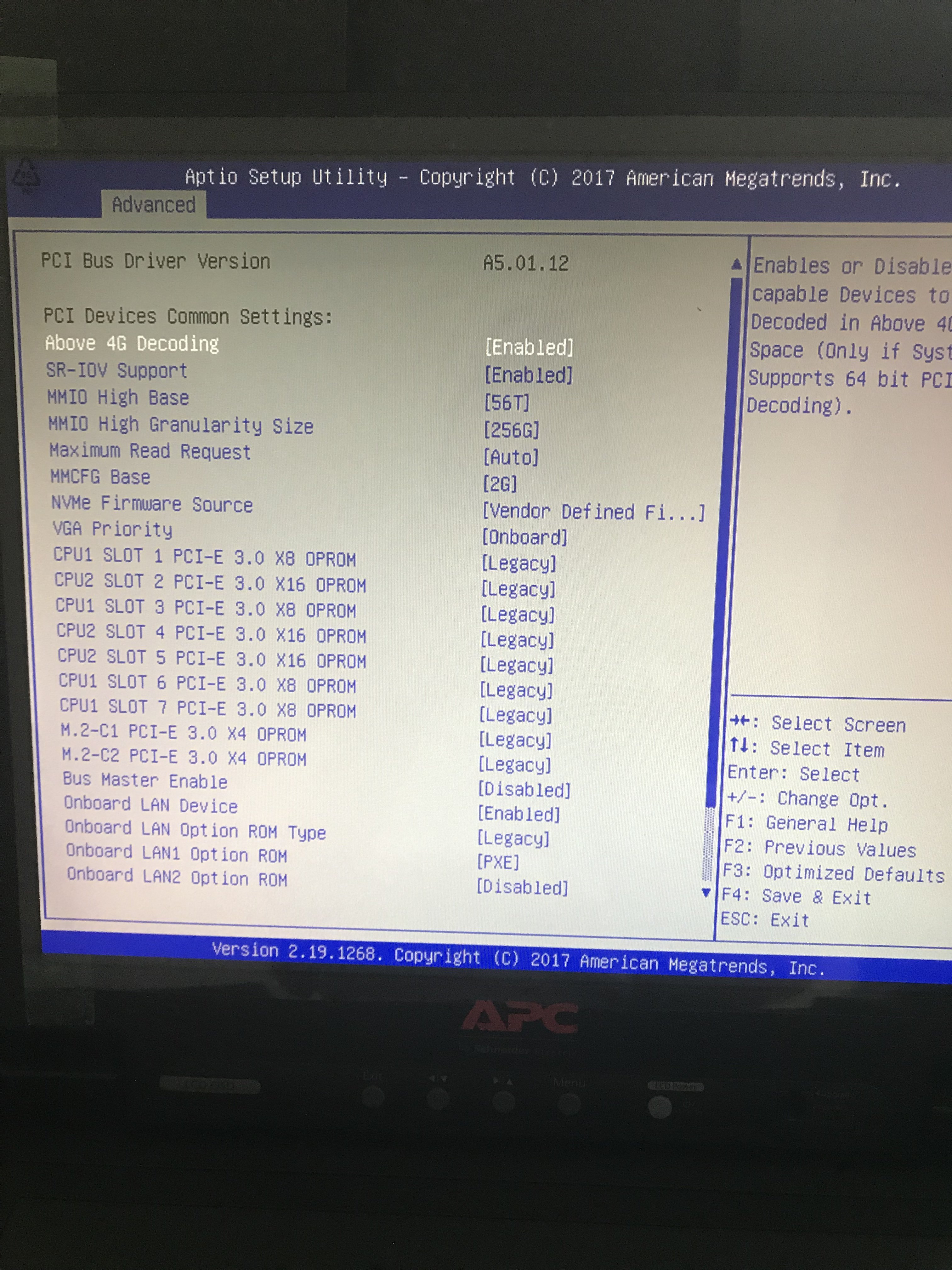

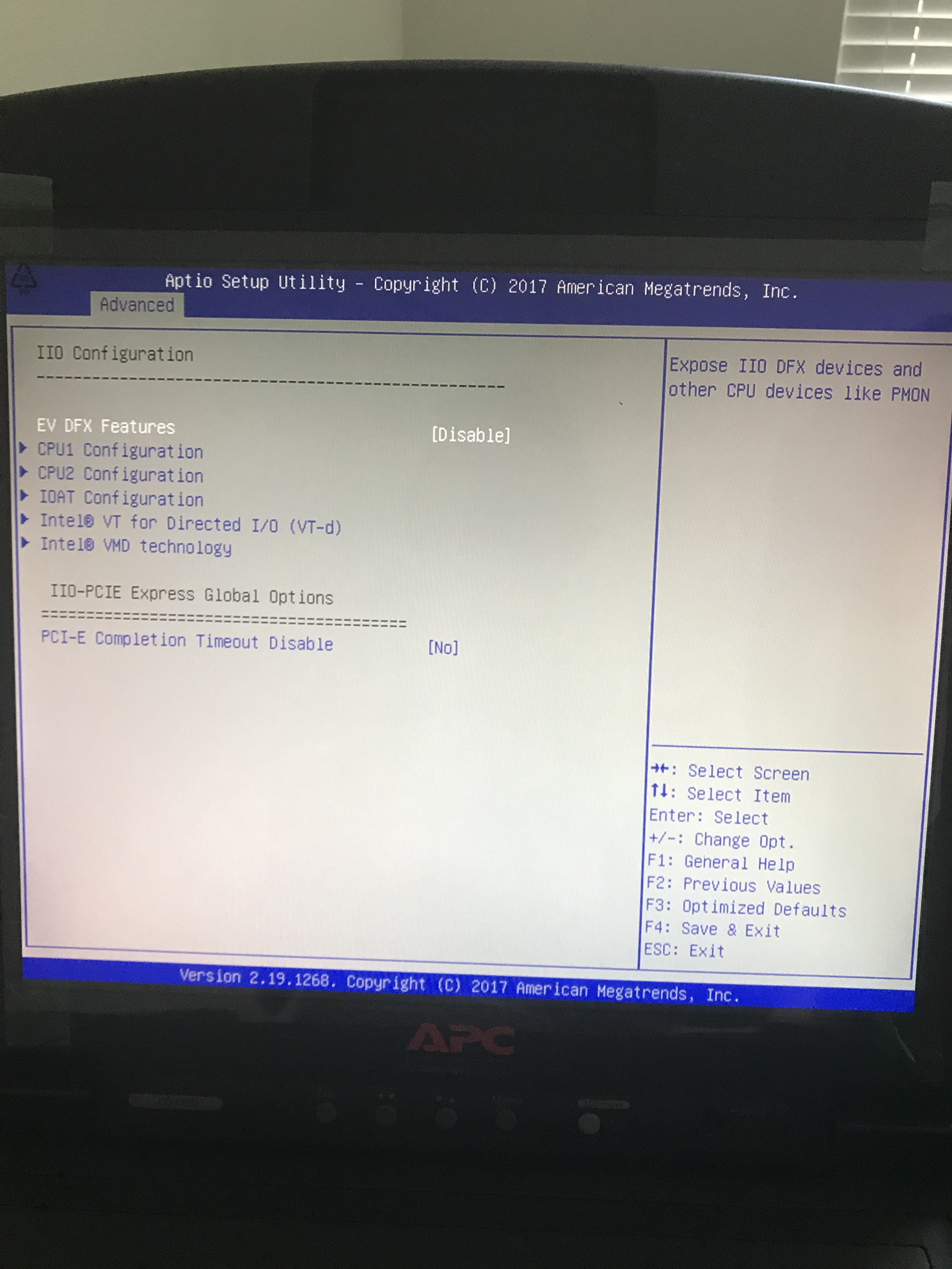

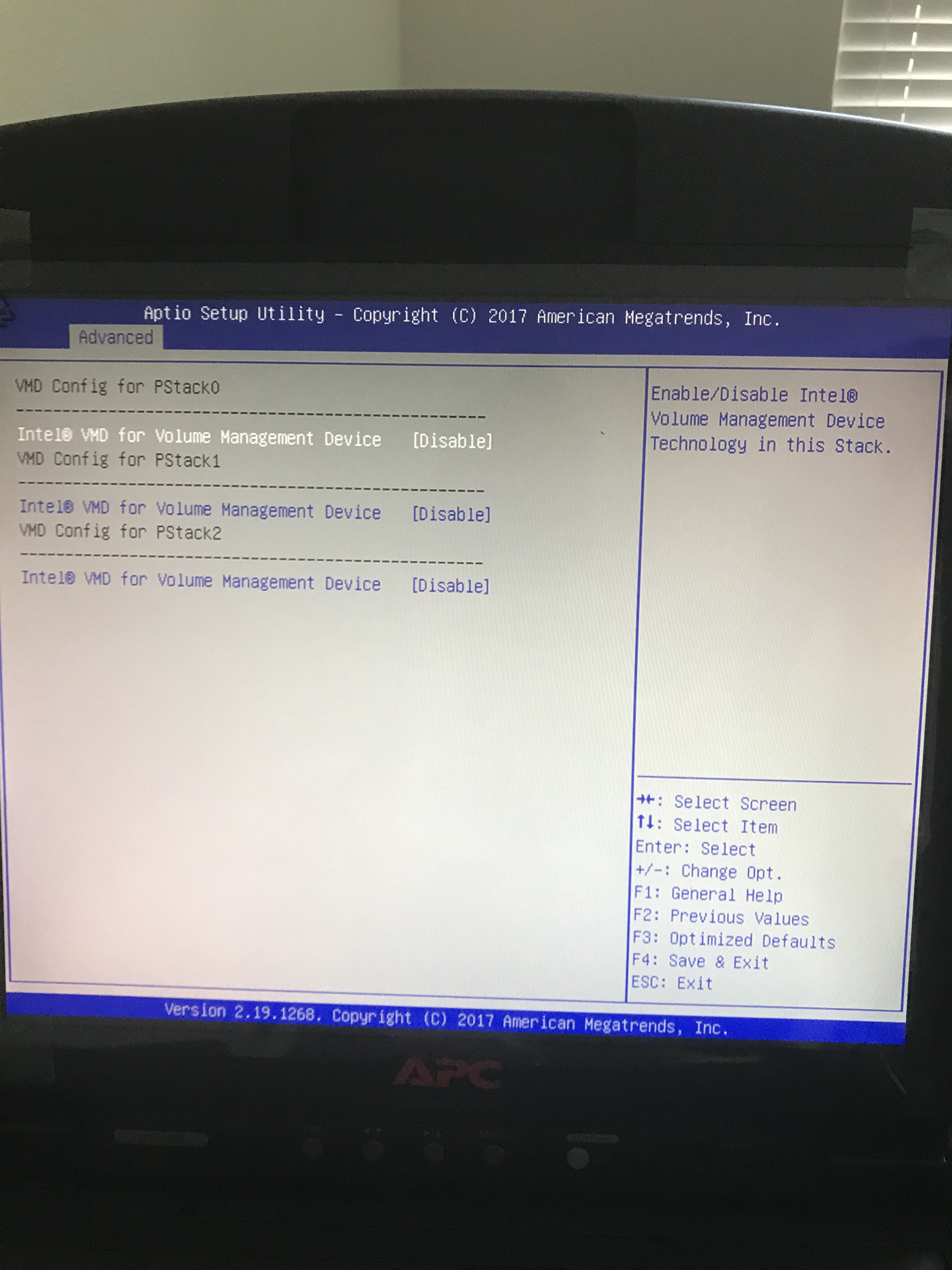

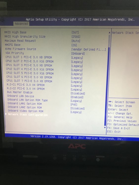

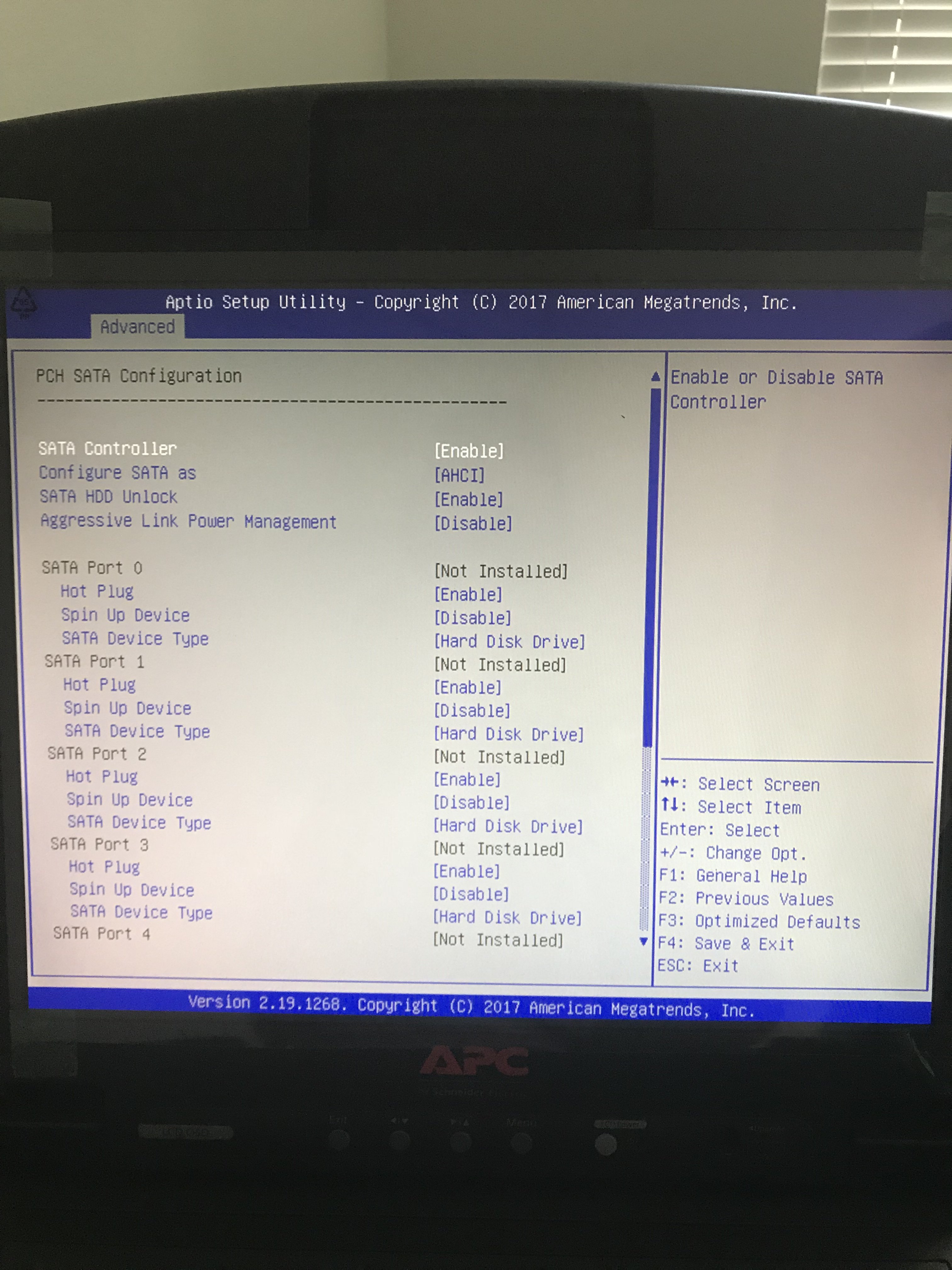

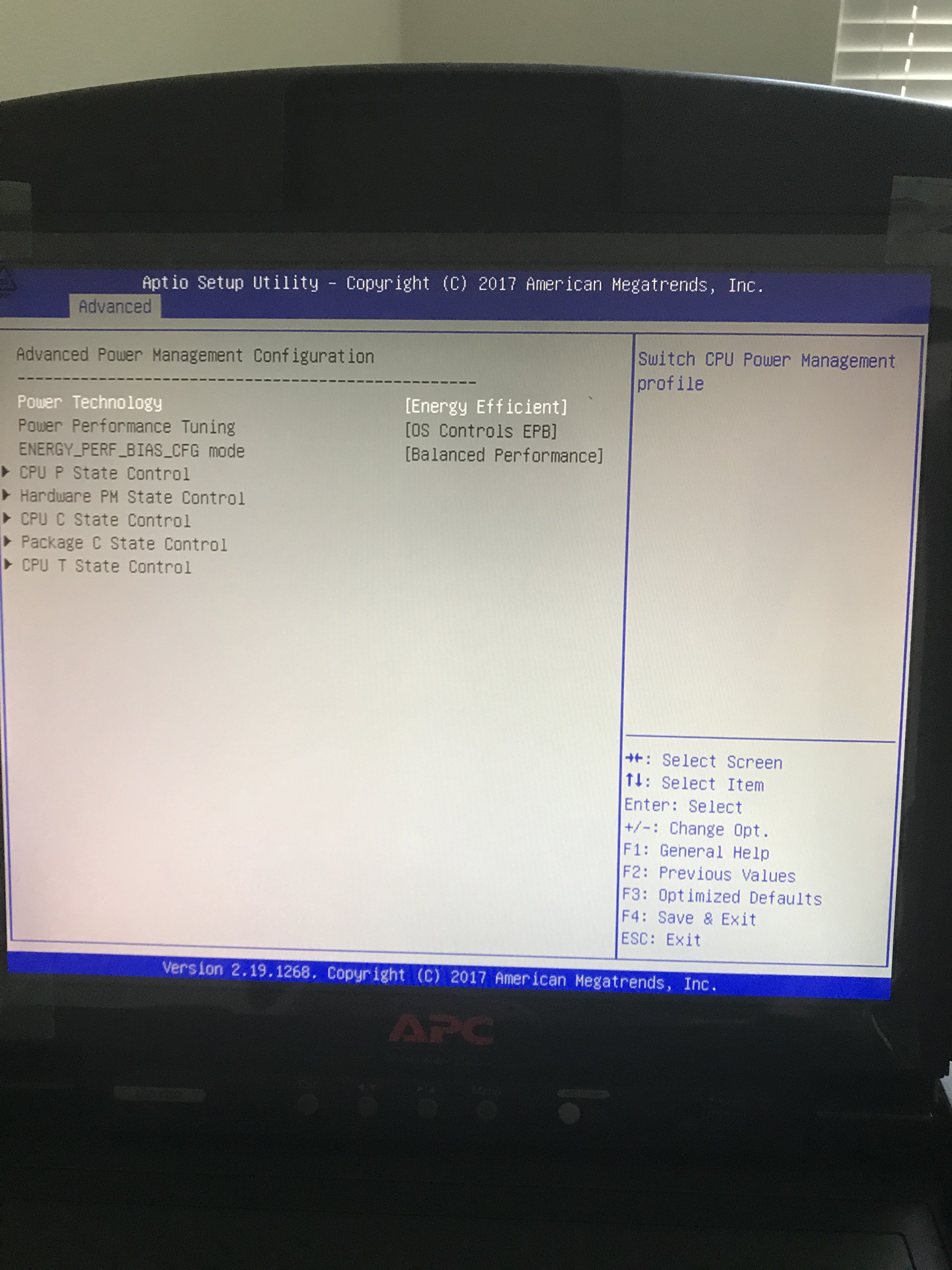

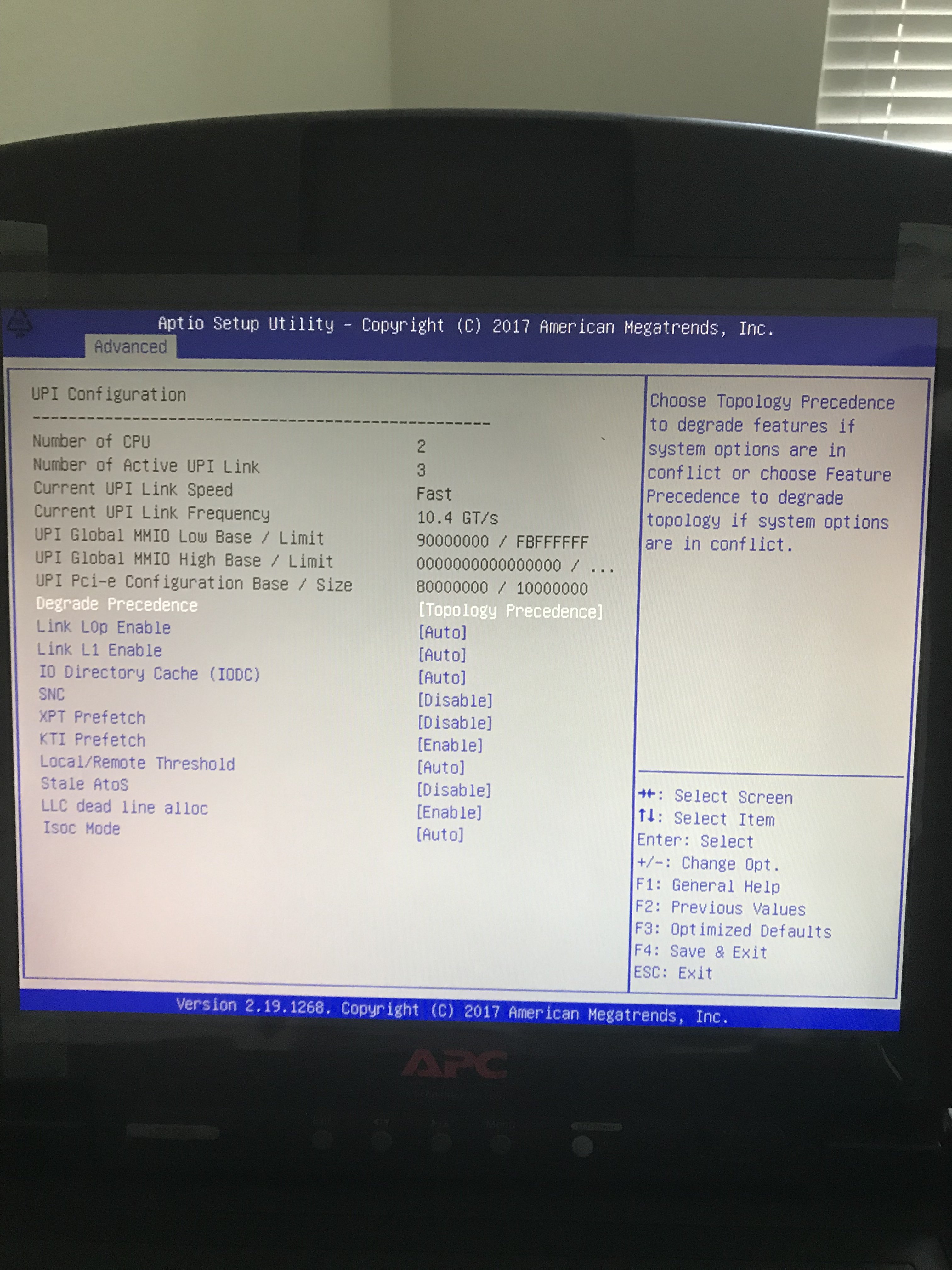

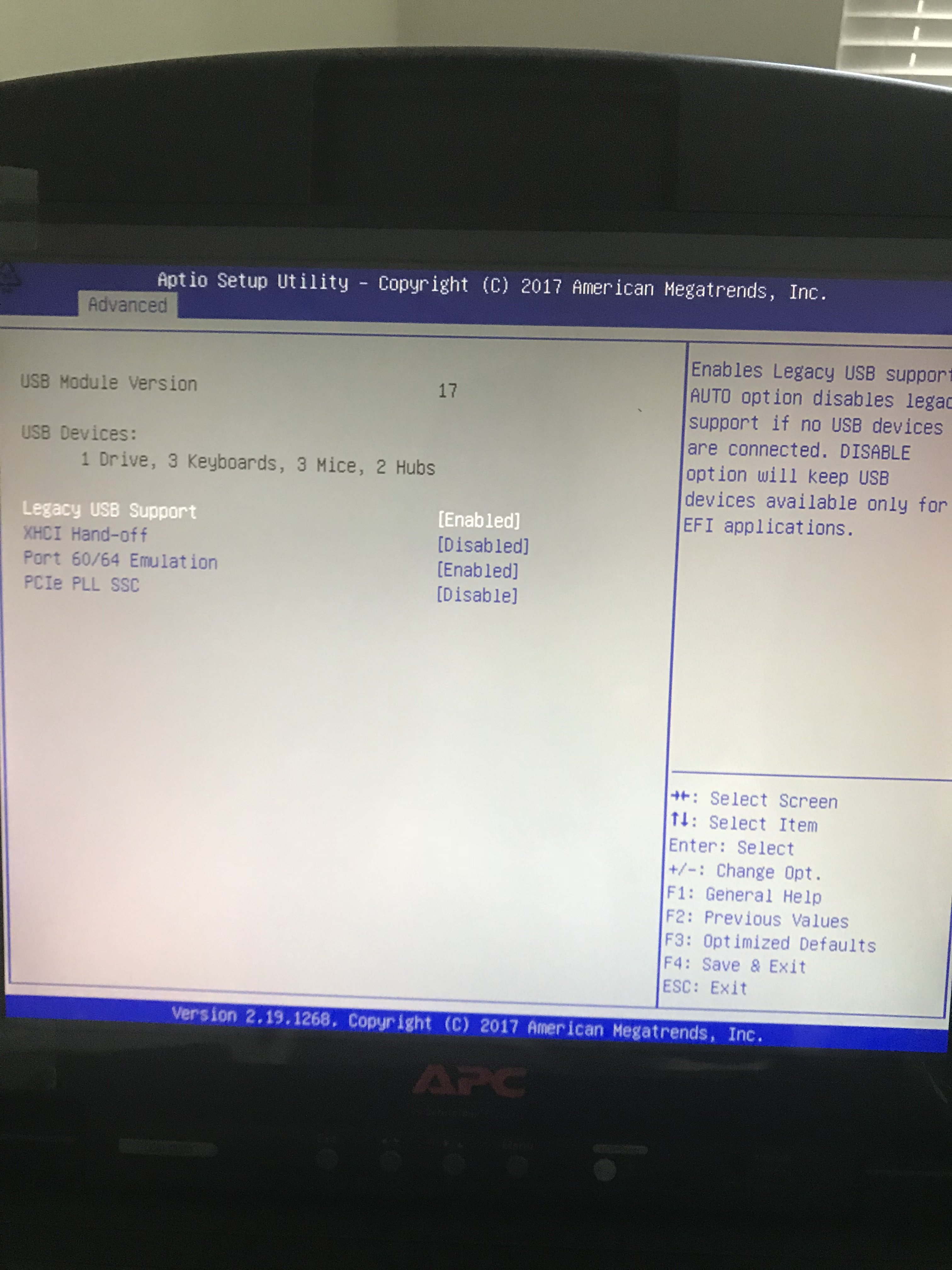

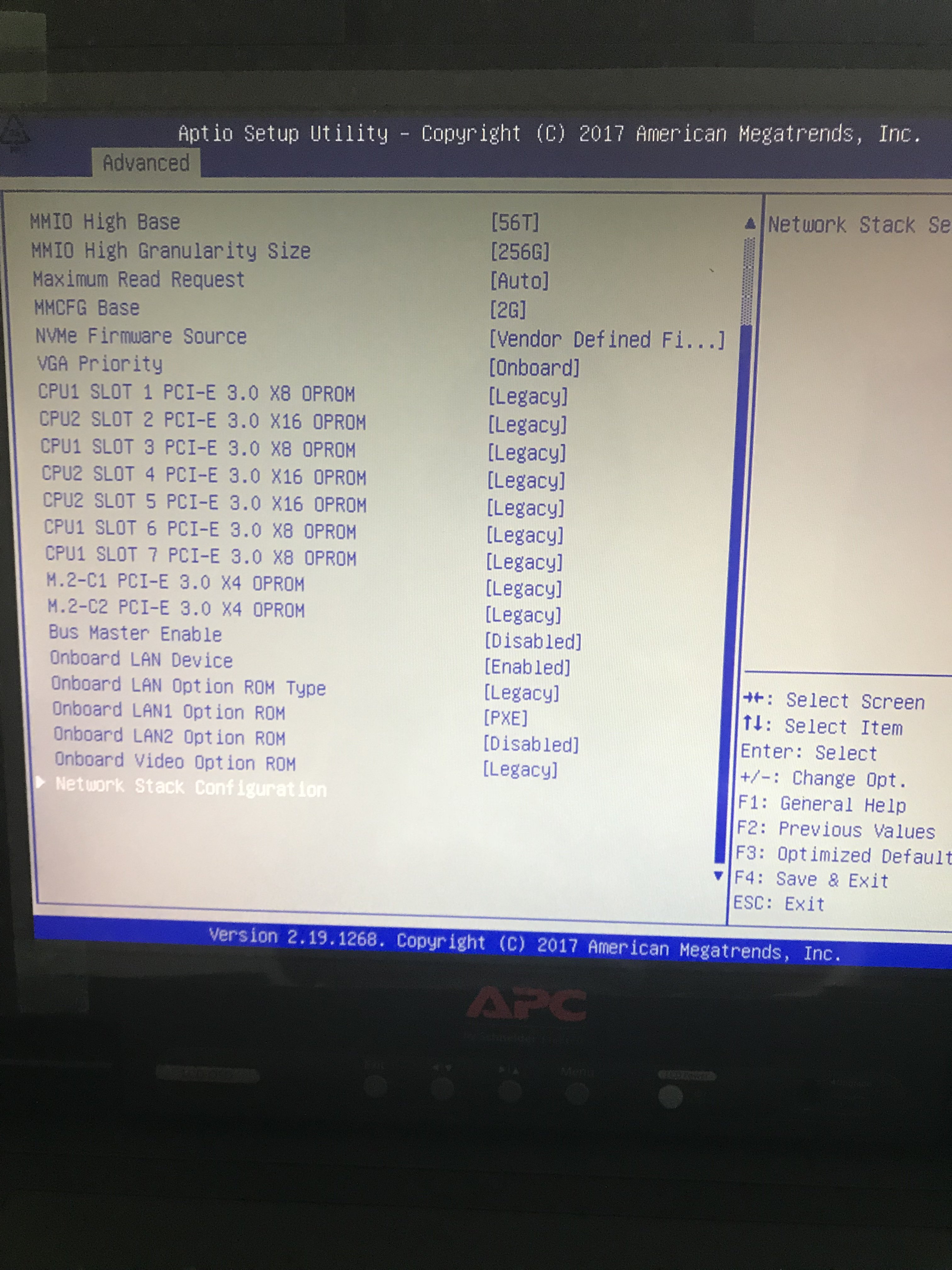

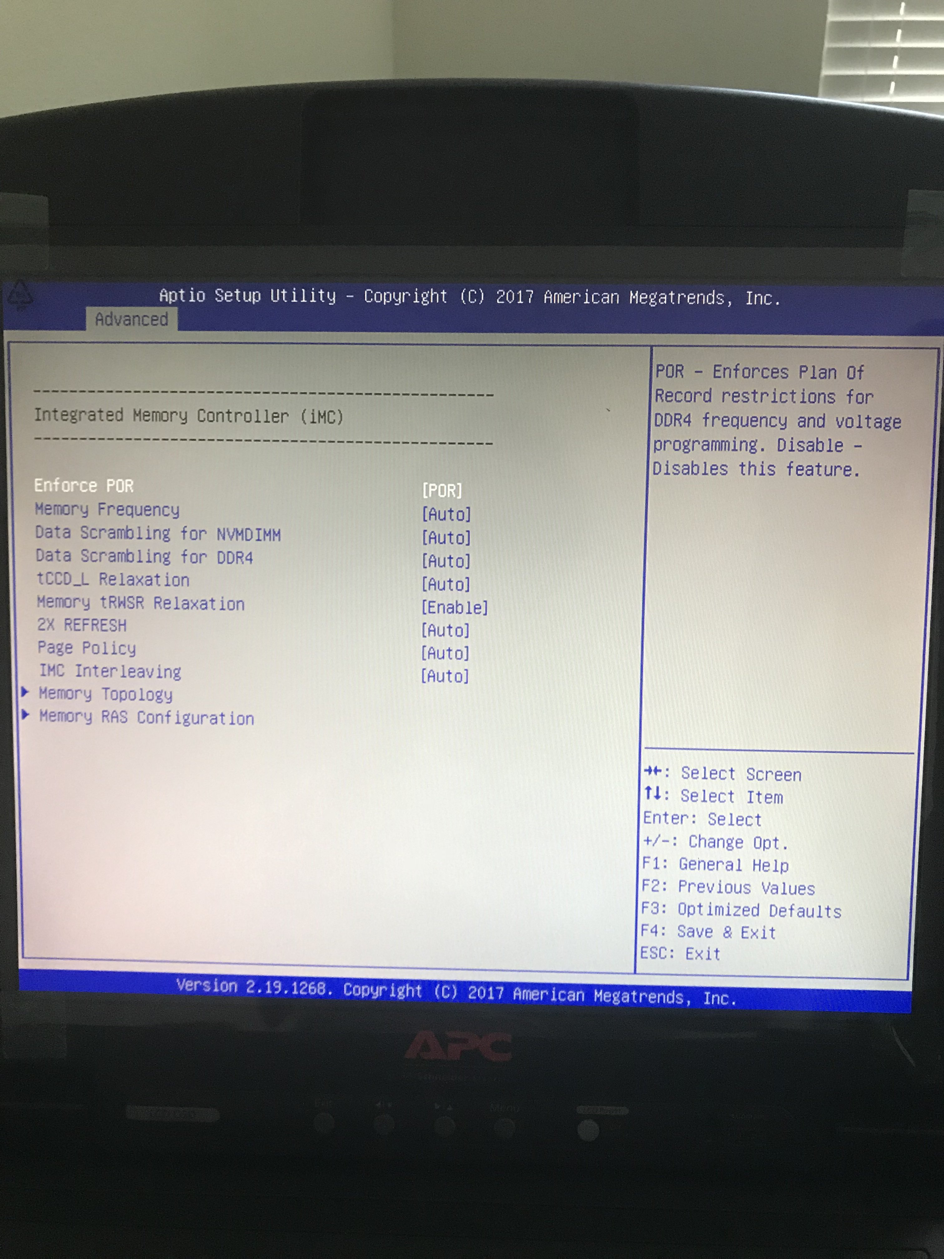

Guys, can you please have a look on the bios setup and confirm everything is in order?
FWIW I’ll be installing windows VM.
