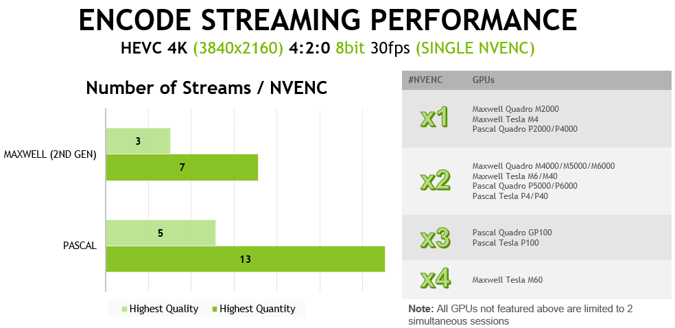

Have a look here at number of supported streams:
https://developer.nvidia.com/video-encode-decode-gpu-support-matrix
Ahh yeah. I see that the Quadro cards are more capable. That's good to know.
Plex also has some limitations listed in the link I posted earlier. They only support decoding on Nvidia in Windows. To decode on Linux you will need Intel. I'm not sure if this is a limitation in Plex or something else (I would assume it's Plex though, so presumably support will get better). Of course, this may not be a major issue for your use case.

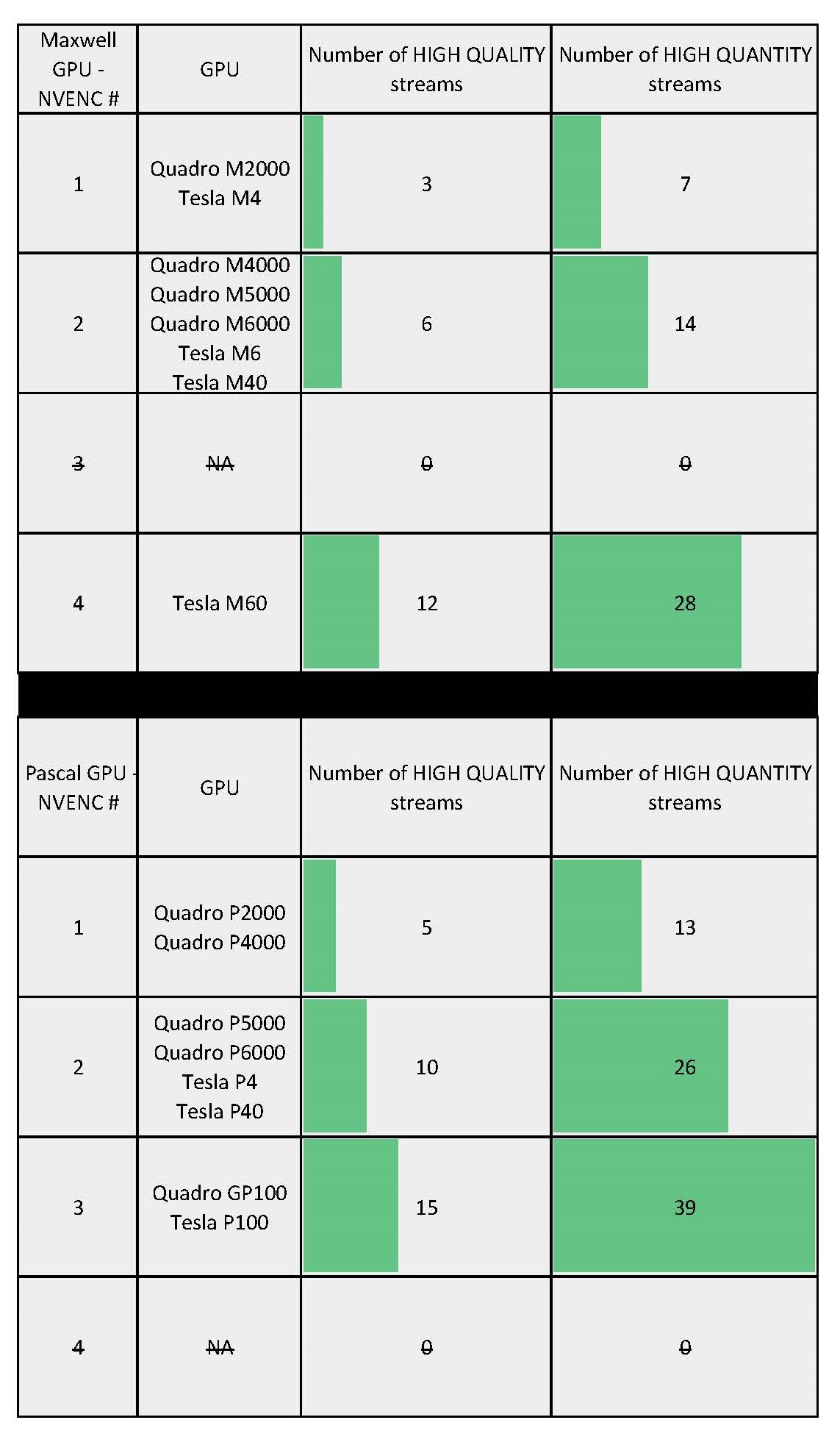

Finally I found something useful:
According to this, I came up with these calculations:
