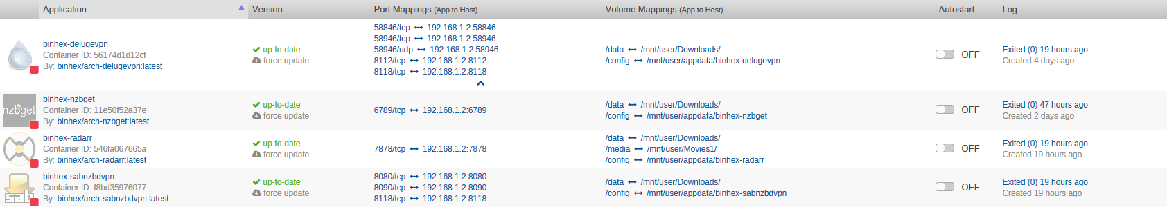

Just to make absolutely sure we aren't talking past each other, could you please answer this question?
41 minutes ago, trurl said:
What are your port mappings for each?
Or just post a screenshot of your Docker page.
Port mappings are as per original. As i say thw only change i tried was to move one of the containers to use privoxy on 8119 instead of 8118 to avoid clash. I'll see if i can grab a screenshot ...
Sent from my LG-D855 using Tapatalk
5a904036c23e8_Screenshot-2018-2-23smtowerDocker.thumb.png.05265c7b78d281343588ed5ce3f79b96.png
So I maybe don't really understand how privoxy plays into this. Are you saying privoxy won't allow you to use a different port for deluge, for example?
Or do you just not know how to map delugevpn port 8118 to a different host port?
While it is true that both applications will want to use port 8118, that doesn't mean that one of the applications can't remap container port 8118 to another host port. That is the whole point of docker port mapping, to allow a container to use the port it thinks it should use, but to map that container port to a different port on the host so that different host ports are used when communicating on the network and internet.
