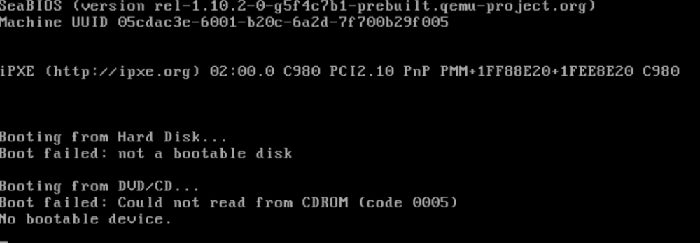

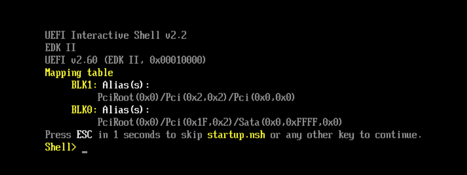

i just tried, and i get this far:
Image here /mnt/cache/vms/LibreNMS/vdisk1.img
ISO here /mnt/user/isos/librenms_centos_7.vmdk
Is the image UEFI compatible? Try creating a new VM template, this time select SeaBIOS instead of OVMF before starting it for the first time. Advanced view.
thanks, wasn't aware of the advanced tab!

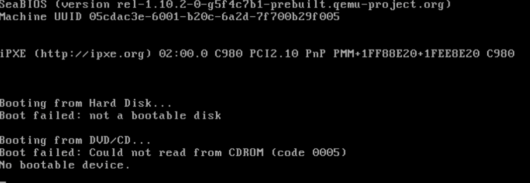

so used that, and i get a diff BIOS boot now:Boot_error.thumb.png.84f45c87e36dc0fc382fe545d0d088fc.png
Im guessing this is an issue with the VMDK file?
my xml for the vm is:

Try switching the vdmk to boot order 1 and the vdisk to boot order 2. Why do you even have a vdisk entered? I thought you were trying to run the vdmk as the VM's hard drive?
tried that, still the same - no ideas why i have a disk setup, this is the first time ive messed about with the VM side of things, so really don't know how it works.
I assumed that the vmdk was the equivalent of an ISO, and i needed to set it up like that
Are you saying that the vmdk is the replacement for the .img file and should sit in my vm disks folders?
Edited by rorton
vmdk spell checked as vodka again!
I had no problems getting this to run!    I did the following when creating the VM:
  • create a new VM and select the Centos option
  • make sure that the Advanced view is selected (at top right)
  • set the BIOS to use SeaBios
  • Set the primary vdisk to use SATA, Manual mode and then set the path to point to the .vmdk file
  • set the network to a bridged connection (br0 in my case)
  • create the VM
it will now be running and you can connect to it via the built-in VNC Remote or via a VNC client running on another machine (using the port shown for the running VM).   If you want to connect directly to the VM bypassing VNC then you will need to gets its IP address either from your router, or using a scanning application such as Fing, or by doing an ‘ifconfig’ command from a login via VNC.
Edited by itimpi
  • create the VM
THANKYOU
followed your points, and got it working - i need to read/play a bit with the vm stuff i think.
I didn't have the disk set to sata, it was set to virtio.
For that to work you would have needed the virtio drivers loaded in the VM.    I had a look at the .ova version and that was where I saw that it was expecting SATA and that it did not support UEFI (and thus the need to change to SeaBios for legacy style booting).
  • create the VM
On 2/23/2018 at 2:56 AM, rorton said:
THANKYOU
