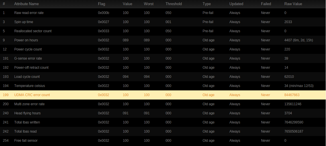

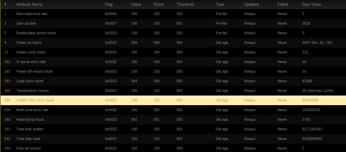

And finally - 6.4.1 introduced UDMA CRC error count. I am upgrading from 6.4, so I never saw these warnings until now.
I am getting hammered with warnings send to my my email every 30 minutes about both of my cache drives. Because of this I had to disable all email alerts.
I have reseated cables, cables are brand new, barely 2 months old, they do not cause any issues on other drives.

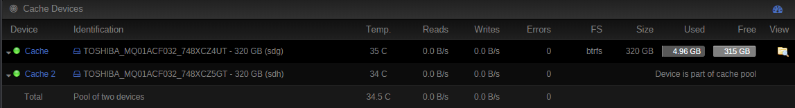

Both 2.5" disks are the same, used as cache drives - TOSHIBA MQ01ACF032 in a Icy Dock MB322SP-B adapter dock, that way they share one SATA power connection and makes use of 5.25" bays.
For SATA controller I use cheapo Syba SI-PEX40071 SATA III 8 Port PCI-E 2.0 as there were no other better devices at this price range and port count.
Errors on both drives:
Event: unRAID Cache disk SMART health [199] Subject: Warning [UNRAID] – udma crc error count is 92831193 Description: TOSHIBA_MQ01ACF032_748XCZ4UT (sdg) Importance: warning
Event: unRAID Cache 2 SMART health [199] Subject: Warning [UNRAID] – udma crc error count is 84380027 Description: TOSHIBA_MQ01ACF032_748XCZ5GT (sdh) Importance: warning

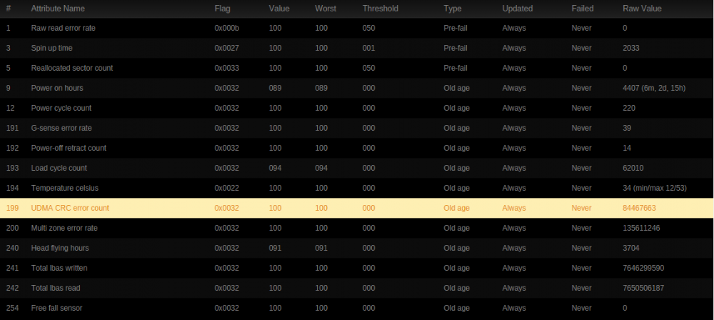

I have swapped drives around with drives in second icy dock caddy (no errors there), but I am still getting UDMA errors, they appeared instantly during boot.
Looks like I am getting 300'000 UDMA errors per day on both drives, so going by this logic, this has been happening for almost a year now (84745745 / 300000), I do not notice any particular slowdowns or anything like that.
So, if it's not a cable or SATA controller, this means it's probably one of drives that's bad - am I right to assume that since both cache drives run as "RAID1" so CRC errors would show on both drives?
Is there anything else I could do to test them before I toss them out of window and maybe get some SSDs instead?
Actually, do I even need cache drives for plex media server sharing 720p/1080p content?
I have noticed that I can disable "SMART attribute notifications, Attribute=199" individually, that could work, I guess?
No, they would appear just on one, it's very unlikely both SSDs would have the same problem, cables, enlosure, controller are the most likely candidates, but it's not impossible.
That's like putting black tape over the engine temperature warning light and continue to use the car without coolant in the radiator.
You have an issue you need to solve. If you have a USB enclosure you could test to put a drive in that enclosure and see if you still get the error to count up. If it does, then you can be almost certain it's the drive that has the issue. If it doesn't, then you need to suspect the cables or the controller. Or possibly bad power to the drive.
The problem with a large count of UDMA CRC is that if you get enough of them, you may get a transfer error that computes a correct checksum. So instead of a retransmission (that loses you a tiny fraction of the bandwidth) you might now and then get broken data to or from the drive. If it's to the drive, then you will permanent that broken data on the disk surface resulting in a permanently broken file.
As noted by @johnnie.black, it doesn't matter if you use drives in a mirror or not. The UDMA counter will only tick up for the specific drives that suffers transfer errors - if both drives tick up then both drives have issues with the communication.
Thanks, I'll give USB to SATA cable a go and try to run some tests on it. Any particular software that you guys recommend for tests on Windows?
