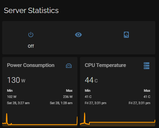

hmmm maybe I can use this ssh method to drag some stats into into home assistant
