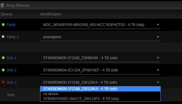

 As the drive is unmountable, should I remove from the array by selecting no device (as per the image), start the array, stop the array and then try to re-add it?
Or
Should I proceed with xfs_repair -vL /dev/md3?
^this
