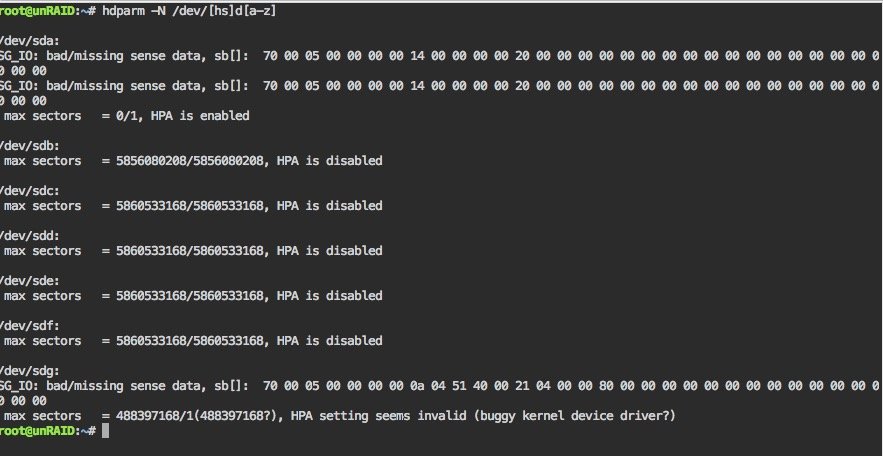

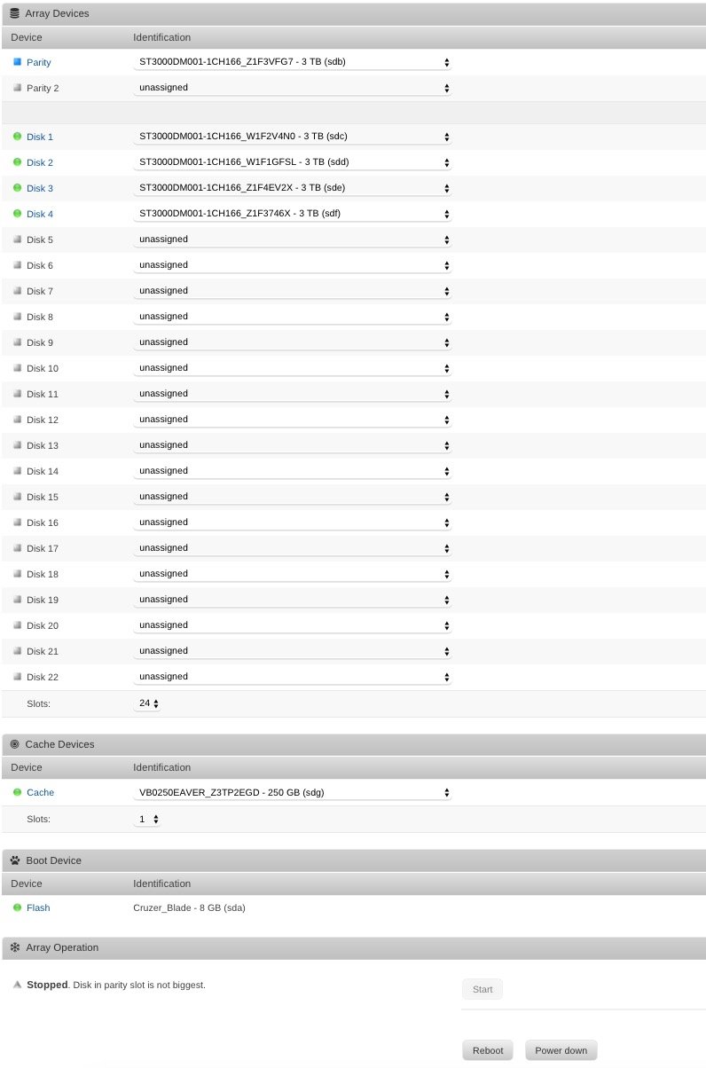

Am really hoping someone is able to offer some help here as stuck.
So my parity disk (3TB) failed and disabled itself. I have purchased a new 3TB drive to replace it with.
However now when i assign my new parity it will not let me rebuild and has message 'parity disk is not biggest'.
Have found the hpa issue but not sure if this is whats affecting mine? Have added some screenshots to hopefully help identify the issue.
Support greatly appreciated.

Please post your diagnostics: Tools -> Diagnostics
Though not registered on the syslog it does look like HPA is enable on the new parity disk, it's definitely smaller than the other ones, try removing it, but because of the bad/missing sense data errors you might need to use another controller or computer to remove it, two different ways of removing it in this thread.

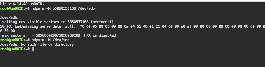

Looking better at the screenshot you posted the bad/missing error is not for that disk, that disk appears to have HPA disable, but it's smaller than the other ones, which is very strange especially since they are the same model, unless that one came from an external enclosure, still no harm in trying but most likely it wont work:
hdparm -N p5860533168 /dev/sdb
Identifier might change after a reboot, check it's still sdb, you can see that on the main page, after the brand and model

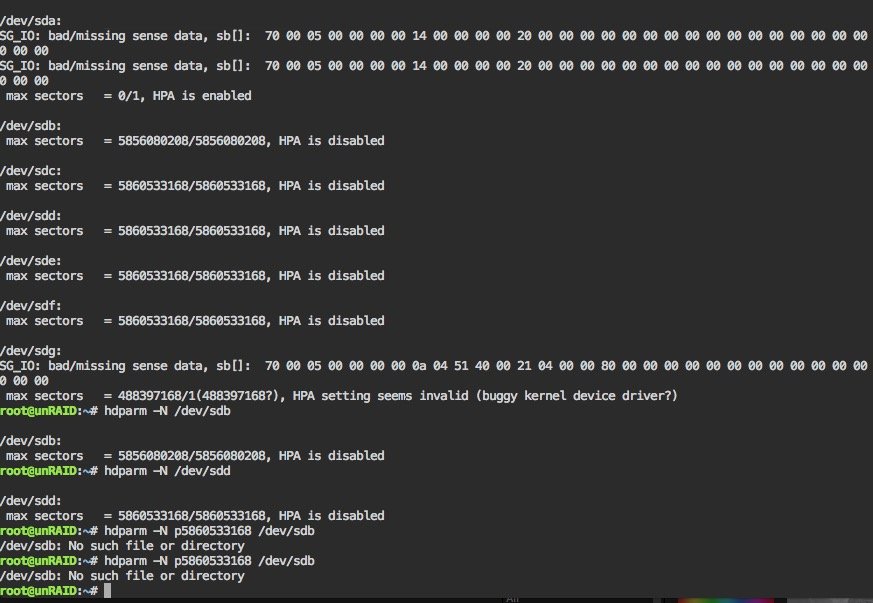

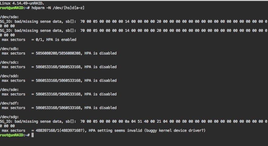

so tried that and rebooted but still the same.

Yes, like I suspected the disk is actually smaller than the other ones, possibly came from an external enclosure, in any case but you'll need to get a new one, that one won't work for parity, it will for adding as a new array disk.
