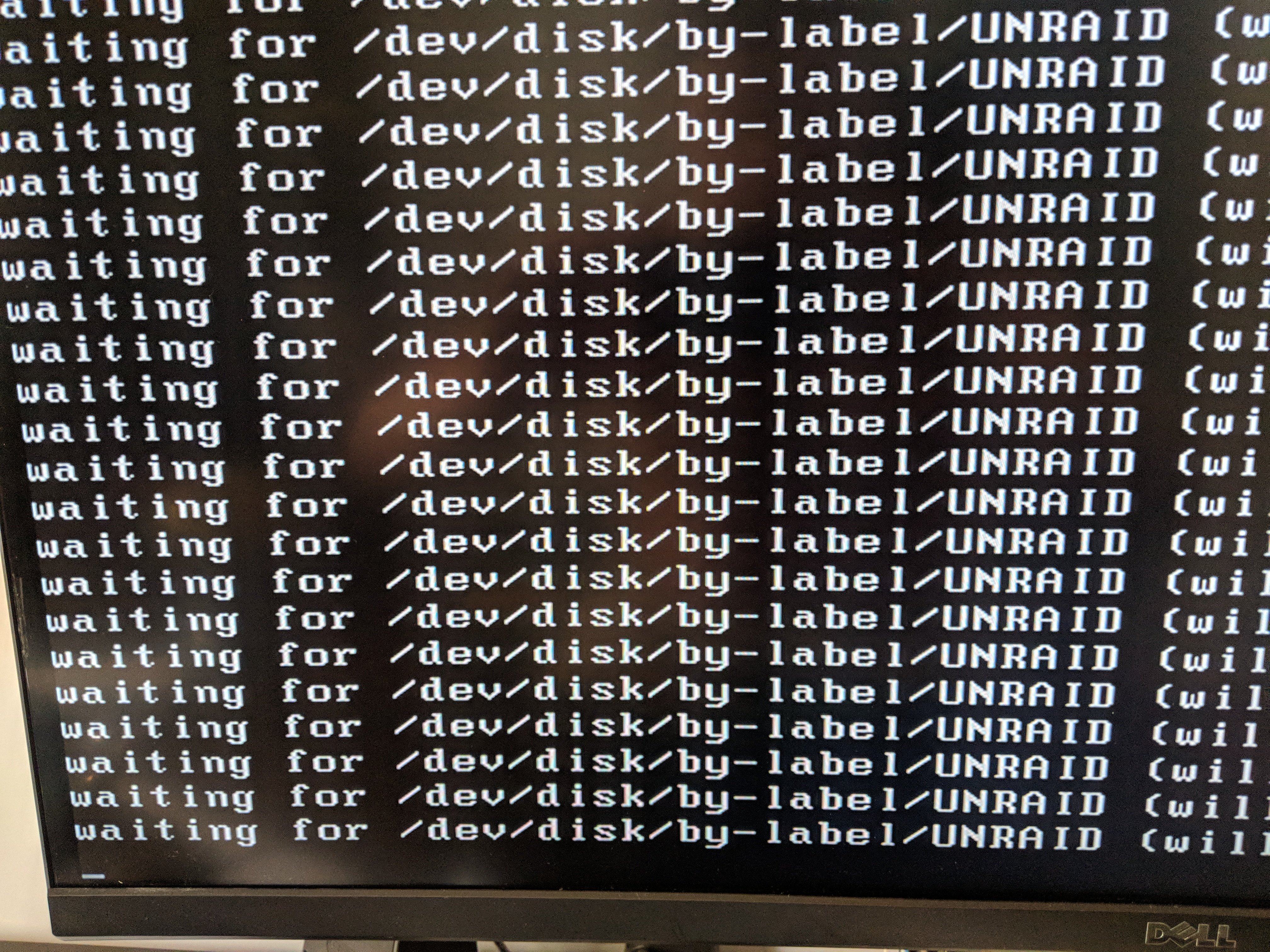

edit: Just tried booting it up again, this time noted this oddity. It goes through this for about 30 seconds and then says dev/disk not found. It then asks if I forgot to make the USB drive bootable, but then boots and I am shortly thereafter able to log in as root.

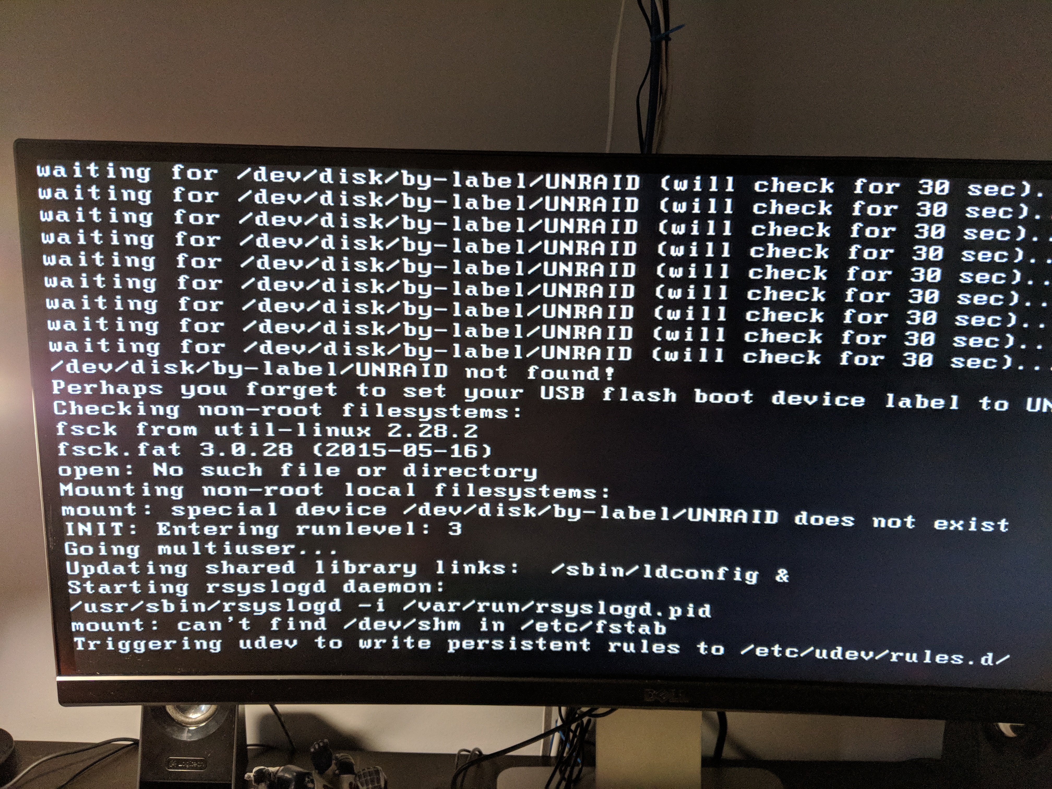

So windows did not find any errors with the USB drive. When I booted up I ran into the same repeating text, and managed to get a picture of what was shown after.

The USB drive is not mounting properly during the boot process, so your configuration isn't being loaded, and the diagnostics can't be saved to it.
Before you go through all that try booting the USB from a different port on the server.
Thank you @Squid and @jonathanm. I managed to get it back online by wiping the USB drive and copying over my config directory. I am really not sure what caused this, but its working now and thats all that matters!
