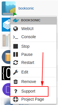

Yeah, in an effort to reduce random posts like this one, you're not permitted to create a new thread, however the developers create dedicated support threads which you can reply to with your issues in an effort to keep the non-Unraid stuff neat and organised.  You can find the specific thread easily from the GUI.
