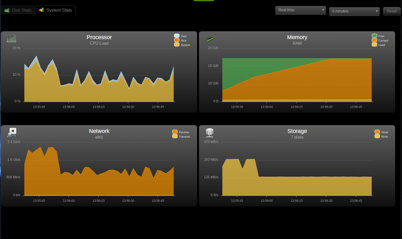

So I recently added a Samsung 860 Evo as a cache drive. I have a 10gbit connection between my desktop and unraid server. When I try to transfer a large file (in this example 25Gb) it starts off at the speed you would expect from a transfer between 2 SSD's over a 10gbit connection (about 450 mb/s). Then after a few seconds (5 isch) then the speed drops to around 120MB/s.
During the transfer, I was watching the system stats of the unraid system and I noticed that the amount of cached ram increases during the transfer. When the cached ram usage reaches about half of my capacity is when the transfer speed starts to slow down.

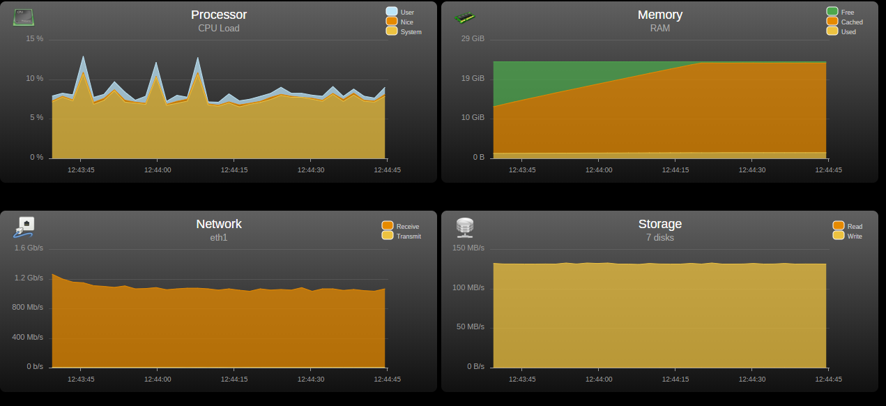

The screenshots included are of the transfer speed and the unraid system monitoring.

3
I tried this and.. The overall speed is lower but it starts out at around 340mb/s then sort of stabilizes at around 250mb/s. Then it drops to around 125mb/s isch. I also noticed that the stability of the transfer is worse. It now transfers between 110mb/s and 140mb/s.
Also it somehow is still using memory caching...
It will always use a little, but it's clear the device/controller is the limit.
