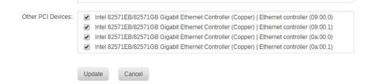

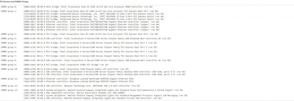

As the title suggests, I am trying to create a PFSense VM following Space Invader One's guide (which is excellent!) however, although I have a PCI  intel 4 port nic it's IOMMU group is bundled with other devices (not sure why that would be??)

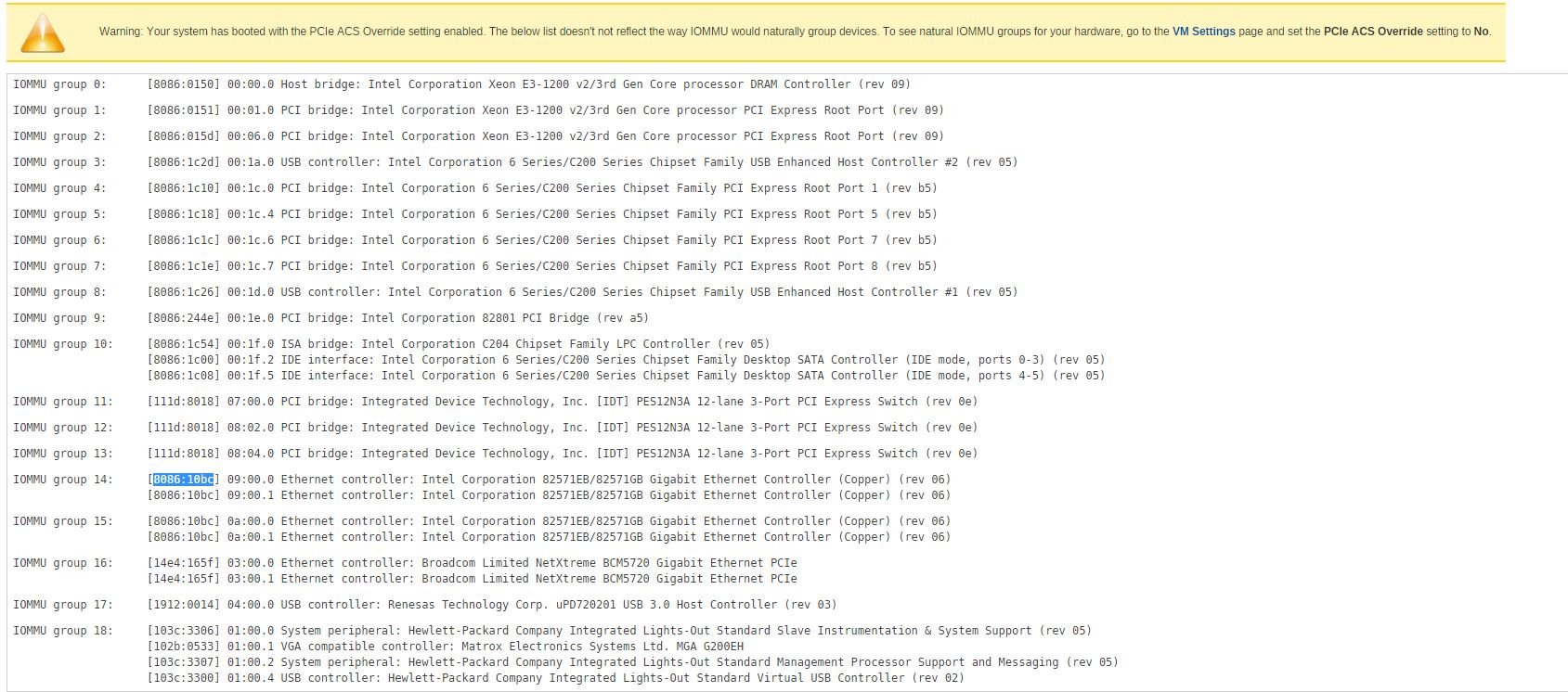

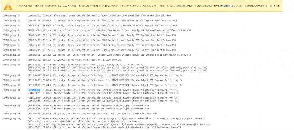

so I enabled ACS and it split 2 ports into group 14 and another 2 ports into group 15
I am now unable to start the VM due to errors on the IOMMU groups 14 & 15

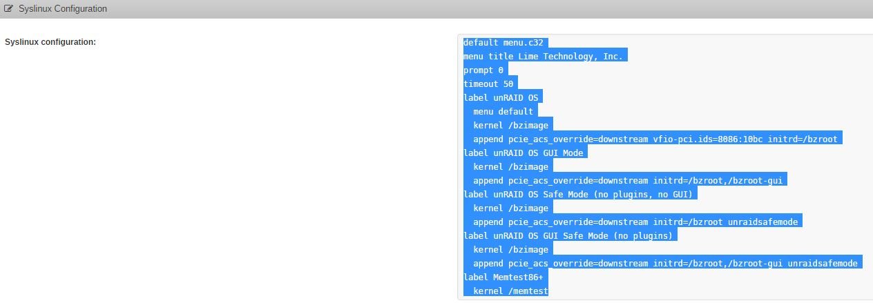

I added this line to my syslinux.cfg which made no difference so I am unsure where to go from here?
vfio_iommu_type1.allow_unsafe_interrupts=1
