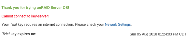

Edit: This is what the error is when I manually install the trial.key.
this indicates that you have a network problem, not that there is a problem with the key.   One of the requirements of using the Trial license is that you must have a working internet connection (this is not required for paid-for keys).

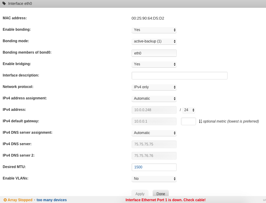

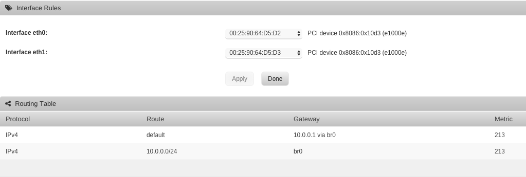

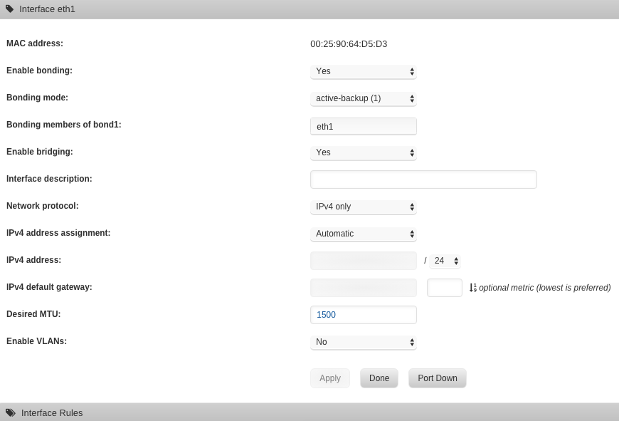

I have tried switching the ethernet ports a couple of times and doing so doesn't even assign me an IP address an I cannot connect to the web UI. I currently have both bonding and bridging on for both eth1 and eth0. I did notice an error that wasn't showing last night, or I possibly overlooked, saying eth1 port is down. I attached screenshots of my network settings if that helps at all. Thanks again for helping me out!

Could be a bad cable, RJ45 connector not seat fully, bad port on switch or a bad NIC.
I plugged in a second ethernet cable to the other port and it gets rid of the "Interface Ethernet Port 1 Is Down" error, but still has no network connection. I tried a couple different ethernet cables this morning and still had the same errors.
I ran this same hardware using FreeNAS up until yesterday and was able to get an internet connection. I know at least one of the ports work. Additionally, I tried pinging a couple of things outside my LAN (ie. google.com, github.com) and that seemed to work. However, trying to ping lime-technology.com or keys.lime-technology.com doesn't work and can't connect.
Edit: So randomly it started working. I am not sure if it was plugging in the second ethernet cable that did the trick and it only took a couple of minutes for it to take effect or what might have happened. As of now I have bridging on for eth0 and eth1 and bonding turned off for both. Hopefully, this stays permanently. Thank you @Frank1940 and @ken-ji so much for the help!
