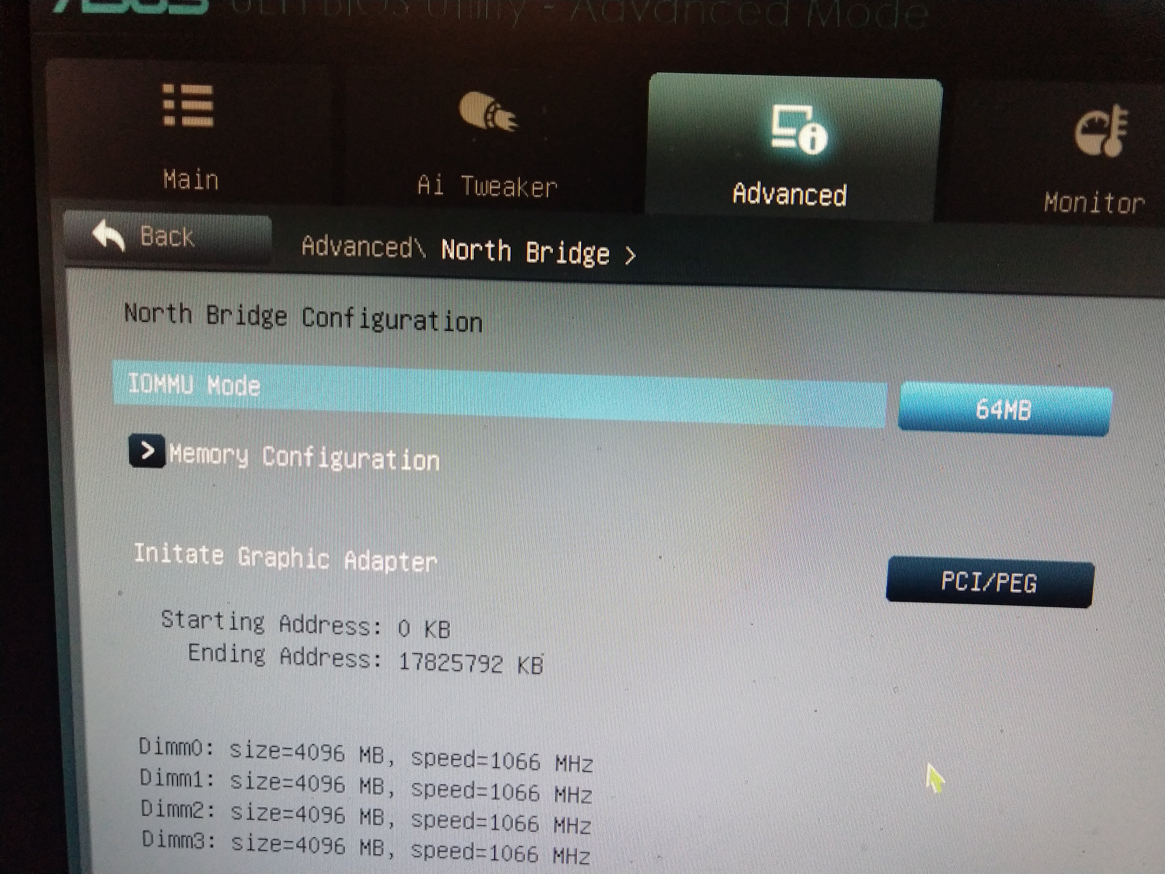

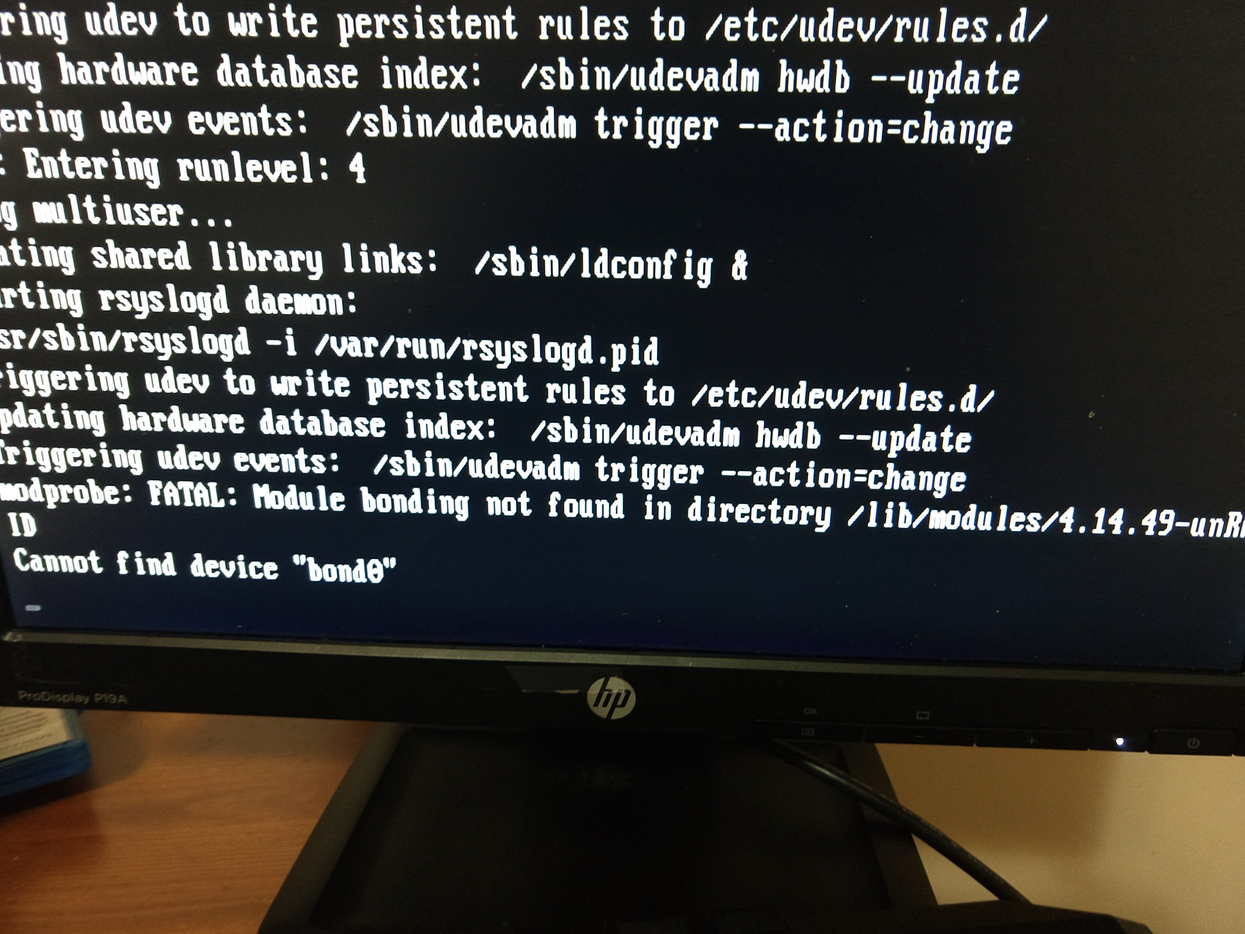

I am new to unraid and just spun up my first server. I got the array all set up and installed some plugins. Everything was working fine until I set IOMMU mode to 64MB then unraid would not load even in safe mode with gui. I disabled IOMMU again and sure enough everything is working. My motherboard/cpu is on the supported list. So, I am a bit confused. Any ideas?

Without a diagnostics zip file to confirm, my best guess is that you have a marvell based disk controller in the system. Remove or disable that and see if it will boot with IOMMU enabled. I'm also a little confused by your statement about setting IOMMU to 64MB. I wasn't aware IOMMU reserved memory was configurable.
I'll try to get a diagnostics log and upload. But here are some screenshot of what I am talking about:
