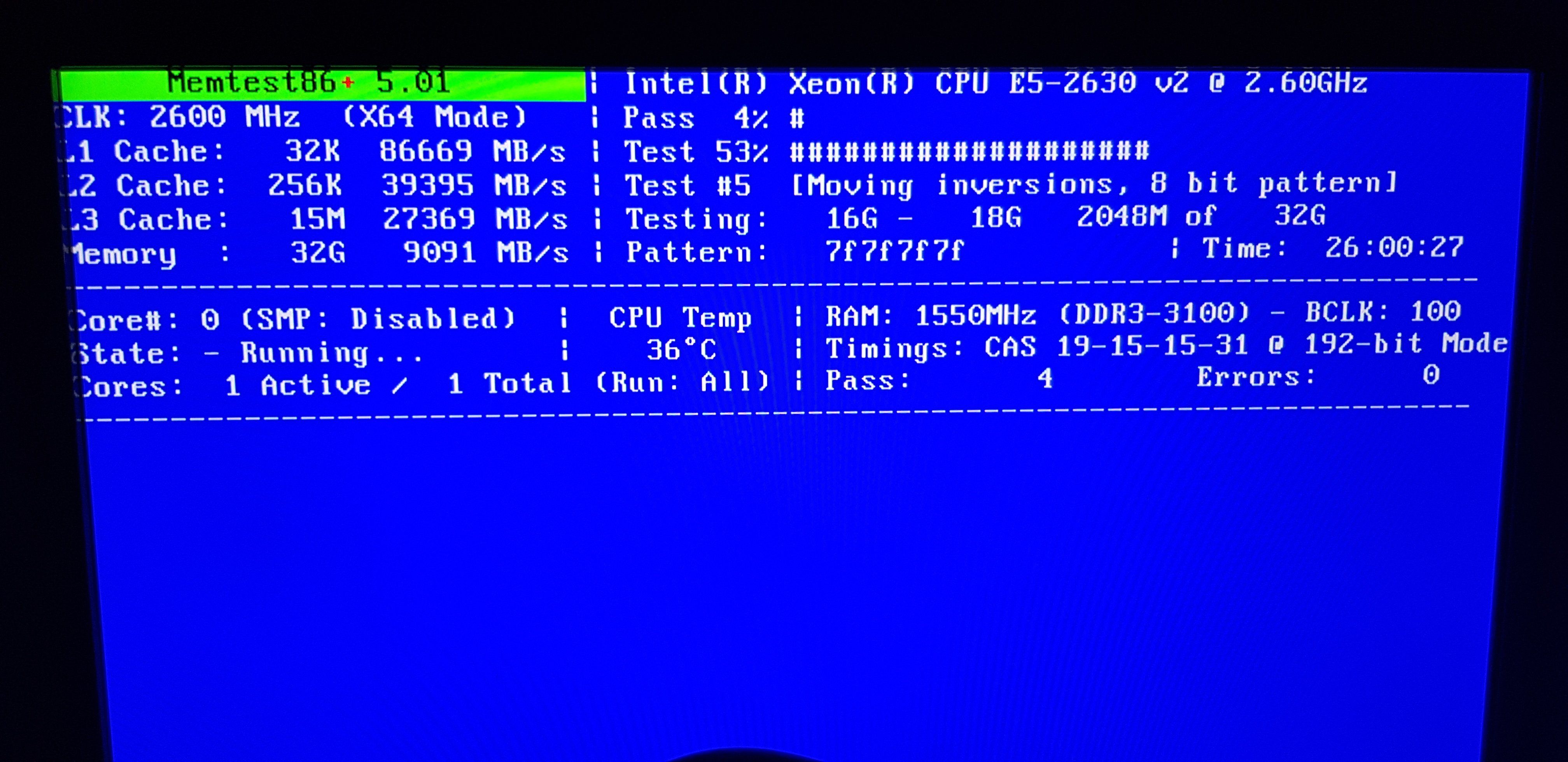

July 18, 20188 yr Author 4 minutes ago, Frank1940 said: You might also want to check to see that the installed RAM is actually recommended by the MB manufacturer. Some MB's are picky about the RAM used. This issue often raises its ugly head when the number of RAM modules increases. (Probably because of the loading on the address busses.) Google can be your friend for this type of research. Running memtst is one of the options in the boot menu for unRAID... I am hoping it isn't RAM conflicts, it is server ram in a server board that is to spec, that's as good as I could do. There isn't much RAM available that is recommended by Supermicro as they want you to buy proprietary or in their small approved lines from key suppliers. I worked out how to run memtest earlier, so far no errors 43% in. TBH, never even see the boot screen as i mainly run it headless! At the end of this, dunno if I would rather have a fault or not, at least I know the issue if I have a fault. Thanks

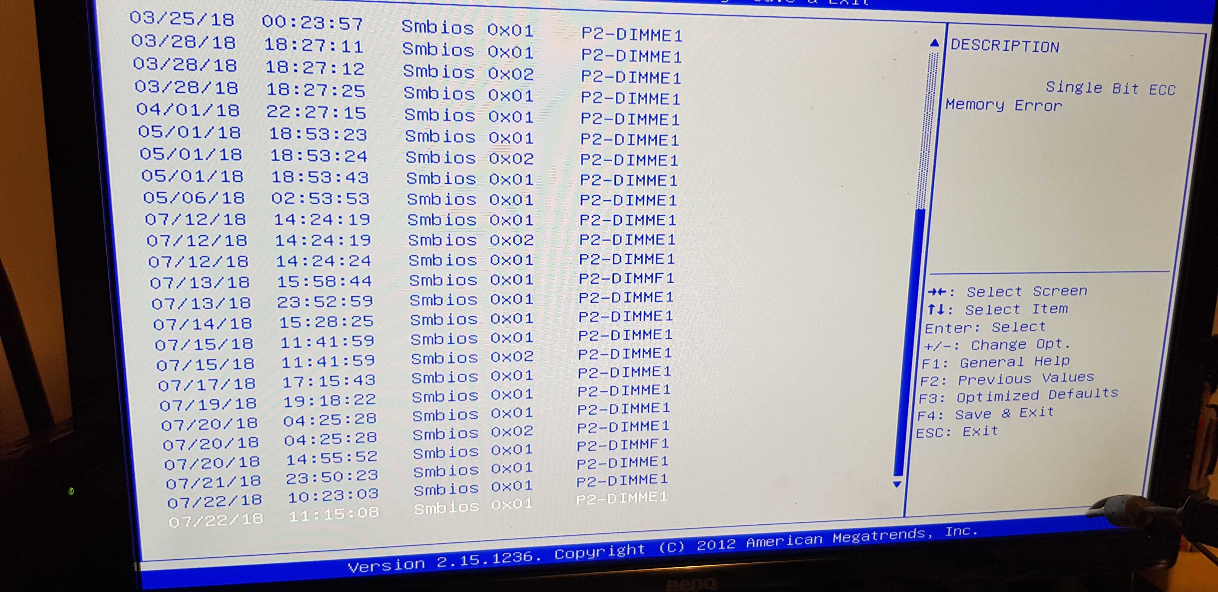

July 19, 20188 yr Community Expert Memtest won't work on systems with ECC, if there are single bit errors they will be corrected and go undetected, you can try checking the board's SEL (system event log), there might be more info there.
July 22, 20188 yr Author On 7/19/2018 at 10:00 PM, johnnie.black said: Memtest won't work on systems with ECC, if there are single bit errors they will be corrected and go undetected, you can try checking the board's SEL (system event log), there might be more info there. Seems like you're right
July 22, 20188 yr On 7/19/2018 at 4:00 PM, johnnie.black said: Memtest won't work on systems with ECC, if there are single bit errors they will be corrected and go undetected, you can try checking the board's SEL (system event log), there might be more info there. The good thing with Memtest is that it will still stress-test the memory - so running Memtest before looking at the event log can help locating bad memory.
July 22, 20188 yr Community Expert And don't forget that single bit errors are corrected, but if a multi bit error occurs the server will halt/crash to prevent corruption, not sure if those would be logged on the SEL but would expect so, in any case that DIMM should be replaced.
