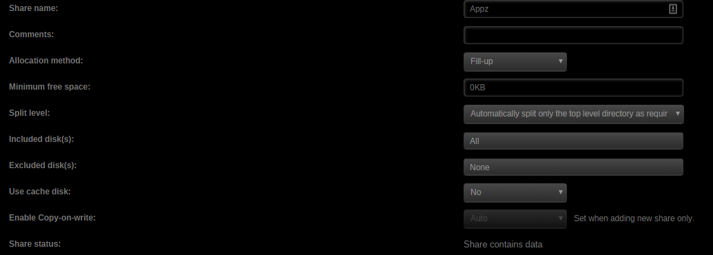

Your Downloads share for some reason is set to only include Disk3.  Except that you don't have a disk 3.  Actually, looks like you have many shares that are set to only write to the non-existent disk 3.
Did you use to have one, and didn't remember to adjust your shares to a different drive?

I looked at the share config for Downloads

So i tried and it worked :)
Strange that it was in this state
So i set it into:
Thanks a lot man!
