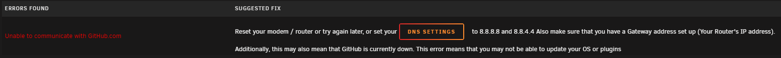

January 10, 20206 yr 1 hour ago, Squid said: That is exactly how you do it. Whether or not the file gets recreated until a change is made to the settings doesn't matter as unRaid will utilize its defaults in the interim. Hi @Squid Ok so I would still have to go to settings and apply what would then be the default settings? I seem to have caused myself a lot of problems after my changes some dockers work and others doesn't work both are using bridge? I copied the network cfg back and rebooted unraid... in Fix Common Problems - I can see this: My network settings are the same as before pointing to my router as DNS... (I have tried to change them to above DNS same result) Should I delete the file again....

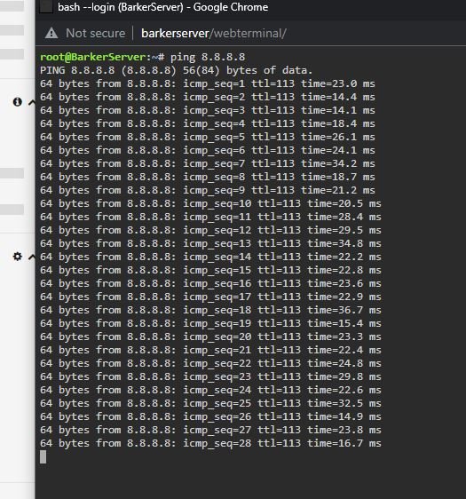

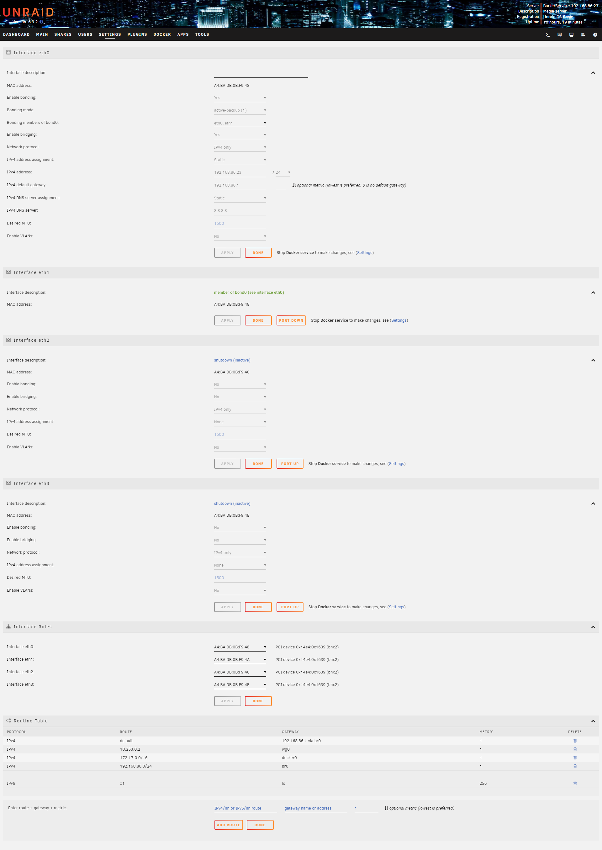

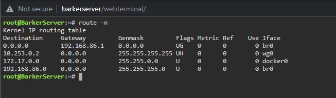

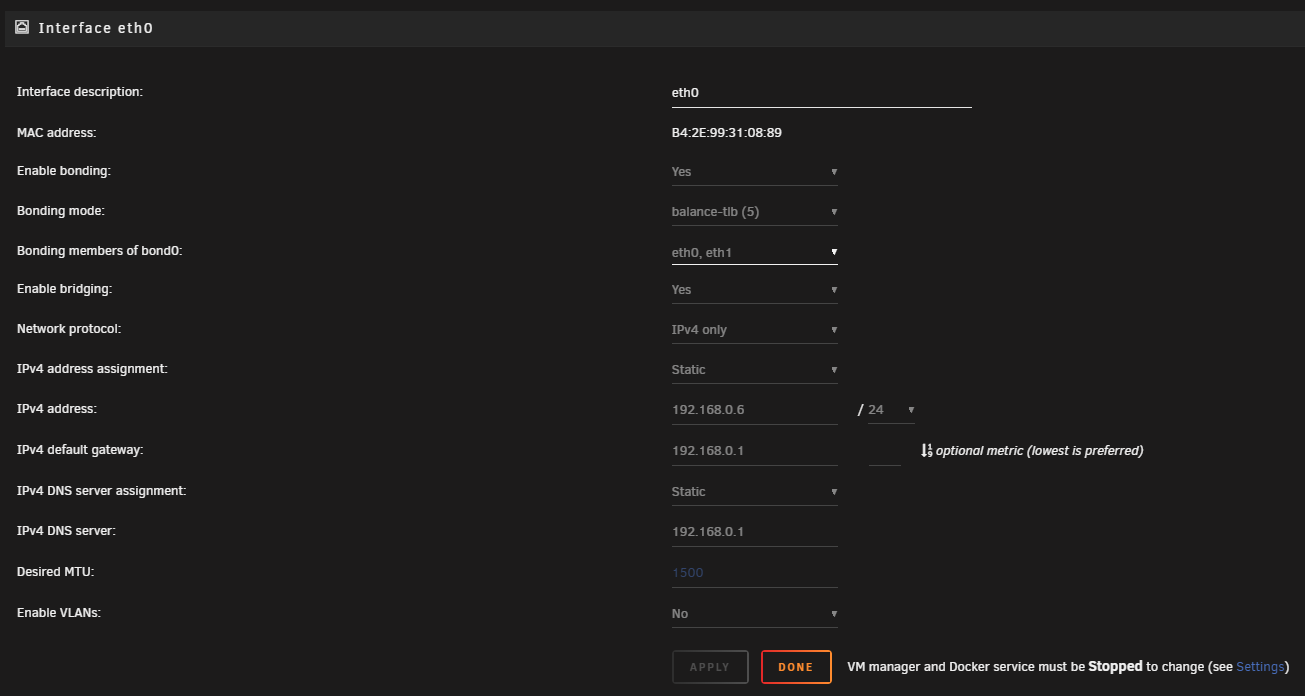

April 1, 20224 yr I moved my array from an HPE microserver to an r710 and I assigned the r710 the same IP as I'd assigned the HPE. Everything is working fine and is accessible via LAN but I can't access anything from the net. Would deleting the network.cfg file fix this? Could you look at my settings and suggest anything? Thank you!
