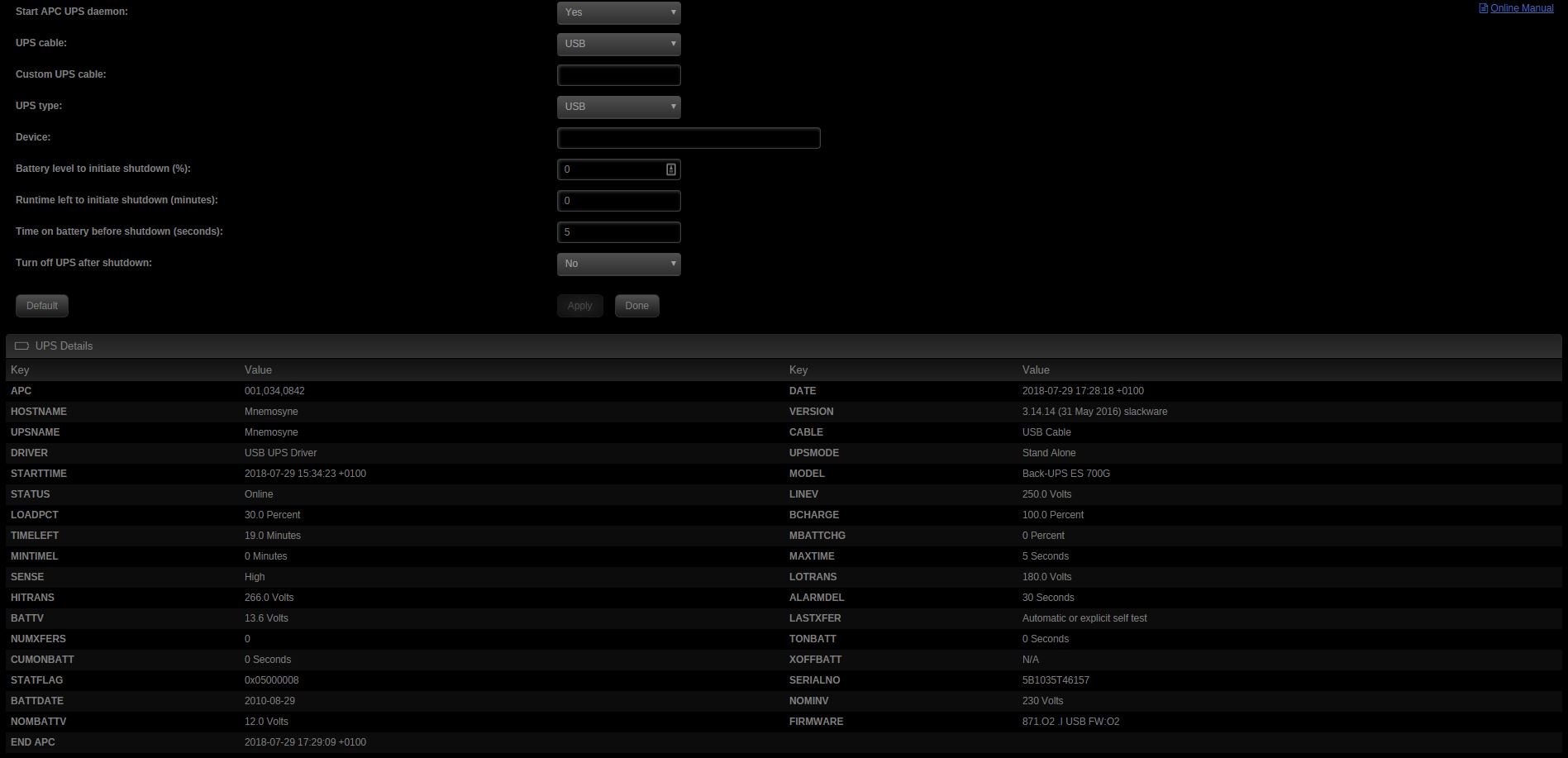

Personally, I don't think frills will be utilised. Unless there's a docker or plugin that I'm unaware of to give more flexibility to UPS users, The native capabilities are pretty basic, though I can personally say I've never had a problem with them. Check out the capture for this crappy old UPS I have laying around to give you an idea of the usage in unRaid.
