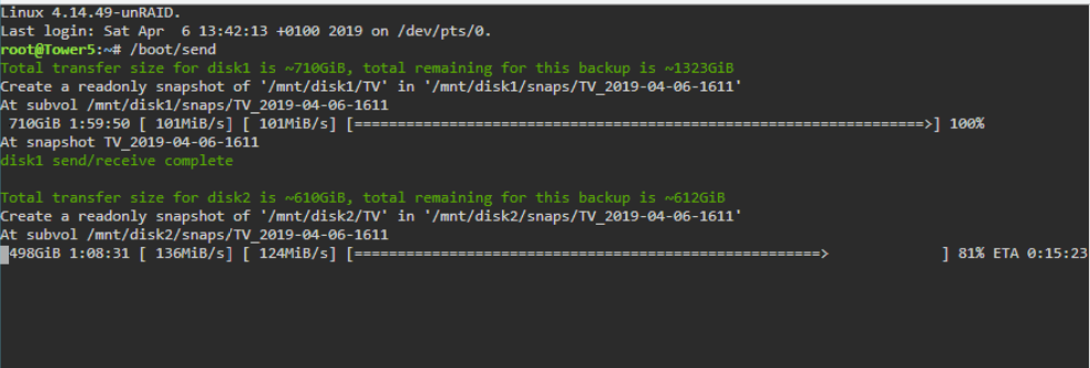

May 22, 20197 yr Community Expert On 5/21/2019 at 9:15 PM, servidude said: Is your script publicly available? I don't mind posting it, but note that I known nothing about scripting, I'm just good a googling and finding examples of what I want to do, so the script is very crude and while it works great for me and my use case it likely won't for other use cases, also: -send/receive has currently no way of showing progress/transfer size, so I do it by using pv after comparing the used sized on both servers, obviously this will only be accurate if both servers contain the same data, including the same snapshots, i.e., when I delete old snapshots on source I also delete them on destination. -you'll need to pre-create the ssh keys. -if any of the CPUs doesn't have hardware AES support remove "-c [email protected]" from the SSH options. -for the script to work correctly the most recent snapshot (the one used as parent for the incremental btrfs send) must exist on source and destination, so the initial snapshot for all disks needs to be sent manually, using the same name format. #!/bin/bash #Snapshot date format nd=$(date +%Y-%m-%d-%H%M) #Dest IP Address ip="192.168.1.24" #Share to snapshot and send/receive sh=TV #disks that have share to snapshot and send/receive for i in {1..28} ; do #calculate and display send size s=$(BLOCKSIZE=1M df | grep -w disk$i | awk '/[0-9]%/{print $(3)}') su=$(BLOCKSIZE=1M df | grep -w user | awk '/[0-9]%/{print $(3)}') d=$(ssh root@$ip BLOCKSIZE=1M df | grep -w disk$i | awk '/[0-9]%/{print $(3)}') du=$(ssh root@$ip BLOCKSIZE=1M df | grep -w user | awk '/[0-9]%/{print $(3)}') t=$((s-d)) if [ "$t" -lt 0 ] ; then ((t = 0)) ; fi g=$((t/1024)) tu=$((su-du)) if [ "$tu" -lt 0 ] ; then ((tu = 0)) ; fi gu=$((tu/1024)) echo -e "\e[32mTotal transfer size for disk$i is ~"$g"GiB, total remaining for this backup is ~"$gu"GiB\e[0m" #source snaphots folder cd /mnt/disk$i/snaps #get most recent snapshot sd=$(echo $sh_* | awk '{print $NF}') #make a new snapshot and send differences from previous one btrfs sub snap -r /mnt/disk$i/$sh /mnt/disk$i/snaps/"$sh"_$nd sync btrfs send -p /mnt/disk$i/snaps/$sd /mnt/disk$i/snaps/"$sh"_$nd | pv -prtabe -s "$t"M | ssh -c [email protected] root@$ip "btrfs receive /mnt/disk$i" if [[ $? -eq 0 ]]; then ssh root@$ip sync echo -e "\e[32mdisk$i send/receive complete\e[0m" printf "\n" else echo -e "\e[31mdisk$i send/receive failed\e[0m" /usr/local/emhttp/webGui/scripts/notify -i warning -s "disk$i send/receive failed" fi done /usr/local/emhttp/webGui/scripts/notify -i normal -s "T5>T6 Sync complete" Edited May 24, 20197 yr by johnnie.black

November 11, 20196 yr Dear johnnie.black, Sorry i am testing around with your given script but unfortunately it seems to be not working for me. Everytime i try to "send the differences from previous one" i get some connection errors and finally the information "send/receive failed" from all disks. I try to figure out how i can get it working, because i am not so familiar with ssh it is a little challenge for me. Please can you explain me a way to get it working for my private purpose? The goal will be to send btrfs snapshots to my other unraid Server located on a different location in my house, they will not go into cloud or offsite. Things i figured already out: - Made ssh connection on from Source-Server to Backup-Server and gave a fingerprint (confirmed yes) - Manually used the following string in the terminal: btrfs send -p /mnt/disk1/snaps/Data_2019-11-11-1340 /mnt/disk1/snaps/Data_2019-11-11-1358 | pv -prtabe | ssh root@HEREISDESTIP "btrfs receive /mnt/disk1" At subvol /mnt/disk1/snaps/Data_2019-11-11-1358 [email protected]'s password: Here i entered valid PW ERROR: empty stream is not considered valid I am not using variables to fixing everything to one working command, then i am not using -s option on pv and not using the -c switch on ssh to make all simpler What could i do next to get it finally working? Thank you very much, any help is very appreciated! Best regards Lobsi Quote #!/bin/bash #Snapshot date format nd=$(date +%Y-%m-%d-%H%M) #Dest IP Address ip="192.168.1.24" #Share to snapshot and send/receive sh=TV #disks that have share to snapshot and send/receive for i in {1..28} ; do #calculate and display send size s=$(BLOCKSIZE=1M df | grep -w disk$i | awk '/[0-9]%/{print $(3)}') su=$(BLOCKSIZE=1M df | grep -w user | awk '/[0-9]%/{print $(3)}') d=$(ssh root@$ip BLOCKSIZE=1M df | grep -w disk$i | awk '/[0-9]%/{print $(3)}') du=$(ssh root@$ip BLOCKSIZE=1M df | grep -w user | awk '/[0-9]%/{print $(3)}') t=$((s-d)) if [ "$t" -lt 0 ] ; then ((t = 0)) ; fi g=$((t/1024)) tu=$((su-du)) if [ "$tu" -lt 0 ] ; then ((tu = 0)) ; fi gu=$((tu/1024)) echo -e "\e[32mTotal transfer size for disk$i is ~"$g"GiB, total remaining for this backup is ~"$gu"GiB\e[0m" #source snaphots folder cd /mnt/disk$i/snaps #get most recent snapshot sd=$(echo $sh_* | awk '{print $NF}') #make a new snapshot and send differences from previous one btrfs sub snap -r /mnt/disk$i/$sh /mnt/disk$i/snaps/"$sh"_$nd sync btrfs send -p /mnt/disk$i/snaps/$sd /mnt/disk$i/snaps/"$sh"_$nd | pv -prtabe -s "$t"M | ssh -c [email protected] root@$ip "btrfs receive /mnt/disk$i" if [[ $? -eq 0 ]]; then ssh root@$ip sync echo -e "\e[32mdisk$i send/receive complete\e[0m" printf "\n" else echo -e "\e[31mdisk$i send/receive failed\e[0m" /usr/local/emhttp/webGui/scripts/notify -i warning -s "disk$i send/receive failed" fi done /usr/local/emhttp/webGui/scripts/notify -i normal -s "T5>T6 Sync complete" Edited November 11, 20196 yr by Lobsi
November 11, 20196 yr Community Expert 2 hours ago, Lobsi said: Sorry i am testing around with your given script but unfortunately it seems to be not working for me. Everytime i try to "send the differences from previous one" i get some connection errors and finally the information "send/receive failed" from all disks. Does the parent snapshot exist on /mnt/disk1 on the destination server? Post the output of ls -l /mnt/disk1 on the destination server.
November 11, 20196 yr 50 minutes ago, johnnie.black said: Does the parent snapshot exist on /mnt/disk1 on the destination server? Post the output of ls -l /mnt/disk1 on the destination server. This seems to be my main issue, i have not the right idea how i get the parent snapshot from one server to the backup server. The output of your question: root@Zwerg:~# ls -l /mnt/disk1 total 0 drwxrwxrwx 1 nobody users 8 Nov 11 11:08 snaps/
November 11, 20196 yr Community Expert 2 minutes ago, Lobsi said: This seems to be my main issue, i have not the right idea how i get the parent snapshot from one server to the backup server. The first snapshot from every disk needs to be sent manually to dest, only after that you can start using the script to make incremental backups, also the script is set to send to dest server root, not snaps folder, you can use any folder if you want but need to adjust the script accordingly.
November 11, 20196 yr 20 minutes ago, johnnie.black said: The first snapshot from every disk needs to be sent manually to dest, only after that you can start using the script to make incremental backups, also the script is set to send to dest server root, not snaps folder, you can use any folder if you want but need to adjust the script accordingly. Thank you very much for your explaination, i appreciate that much. Can you give me an example how i can put the first snapshot from my source server to my destination server? I would like to get finally this situation: I have 2 Unraid Servers, a bigger one who has different Dockers and VMs and a smaller one who only should store the snapshots from the bigger one in case i get a ransom ware or crypto trojan... On the small server i would like to have all snapshots stored by preserving the unraid mechanic (there are 3 8tb Drives, one for parity in it) if this is possible. Finally i like to put the Server in sleep until the next snapshot cronjob of the bigger server starts again.... Edited November 11, 20196 yr by Lobsi
November 11, 20196 yr Community Expert 13 minutes ago, Lobsi said: On the small server i would like to have all snapshots stored by preserving the unraid mechanic (there are 3 8tb Drives, one for parity in it) if this is possible. Just so were clear to be able to use the script above the destination server needs to have the same disk config as the source server, or at least the disks you want to snaphot, i.e., you have 2 x 8TB disks on dest you can snapshot only 2 disks on source up to 8TB.
