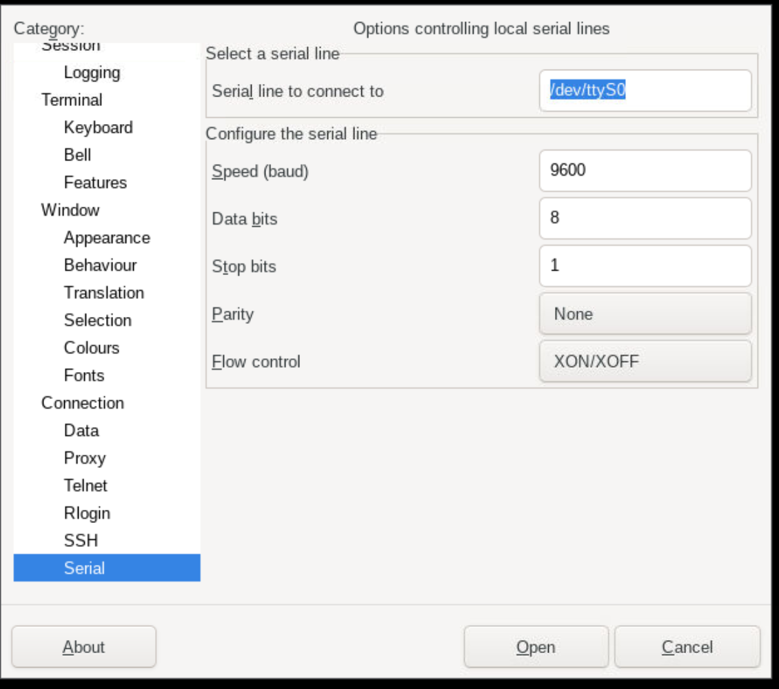

July 9, 20197 yr how do I pass a serial port to this container? my router has a serial port and I'd like to access it with this.
July 10, 20197 yr Author 11 hours ago, ndaringer said: how do I pass a serial port to this container? my router has a serial port and I'd like to access it with this. You need to edit container's settings and add a "Device". The device should be the one associated to your serial port (e.g. /dev/ttyS0). Then you also need to add a variable "SUP_GROUP_IDS" with the value sets to the group of your serial device. You can get it by executing: stat -c '%g' /dev/ttyS0
July 13, 20197 yr On 7/9/2019 at 9:18 PM, Djoss said: You need to edit container's settings and add a "Device". The device should be the one associated to your serial port (e.g. /dev/ttyS0). Then you also need to add a variable "SUP_GROUP_IDS" with the value sets to the group of your serial device. You can get it by executing: stat -c '%g' /dev/ttyS0 Thank you! This worked perfectly!

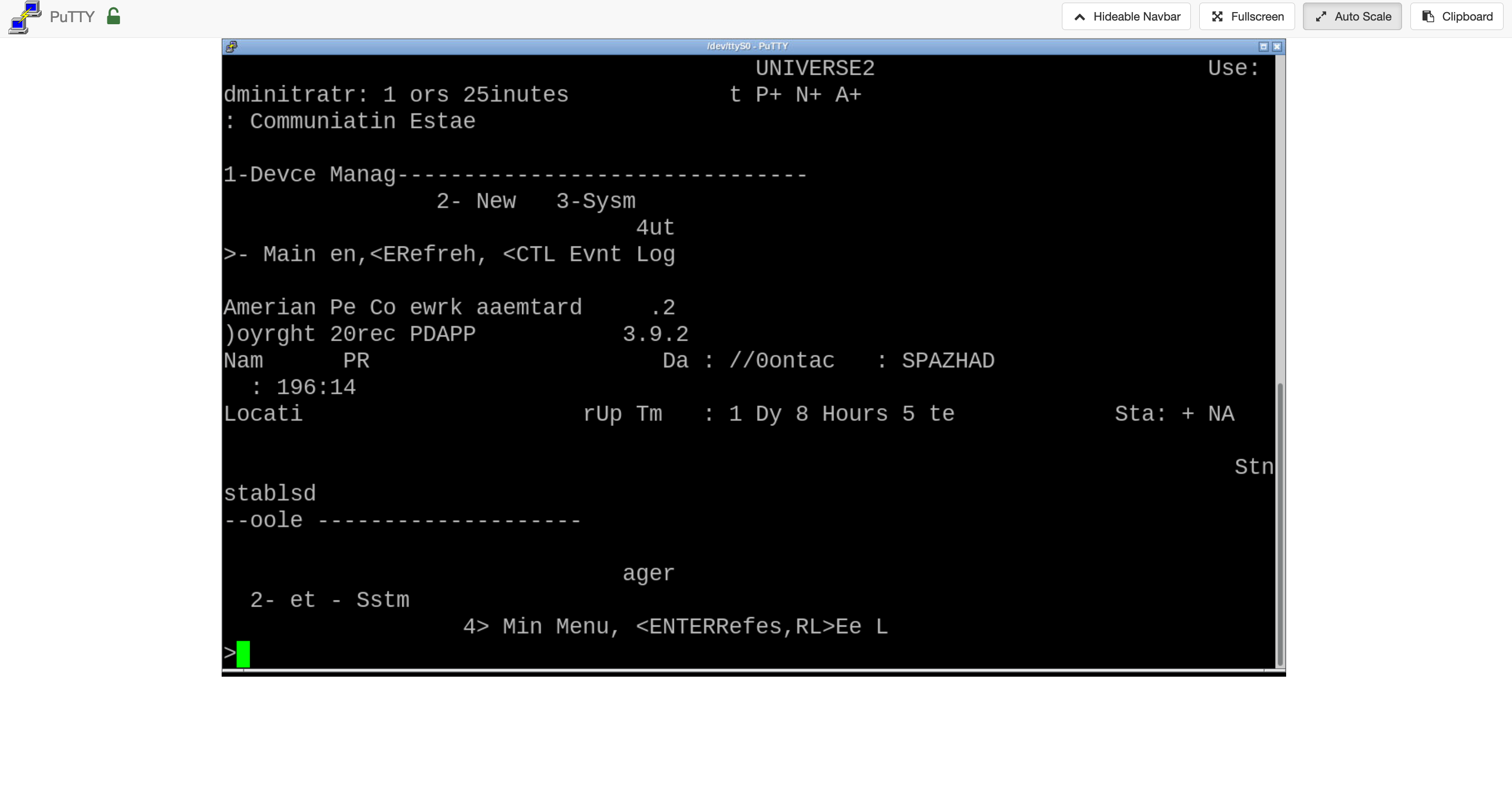

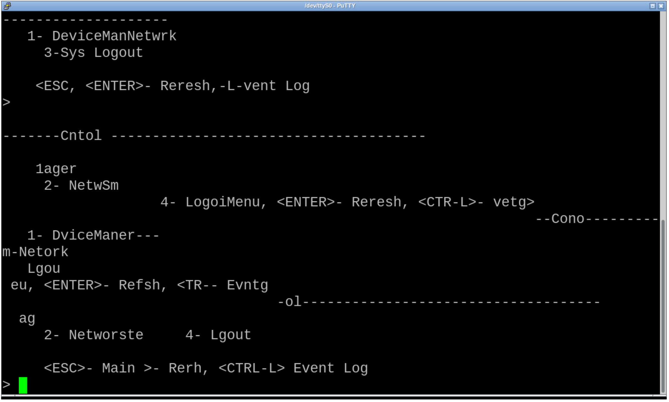

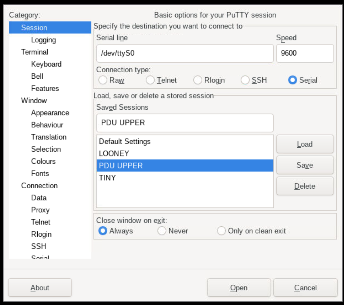

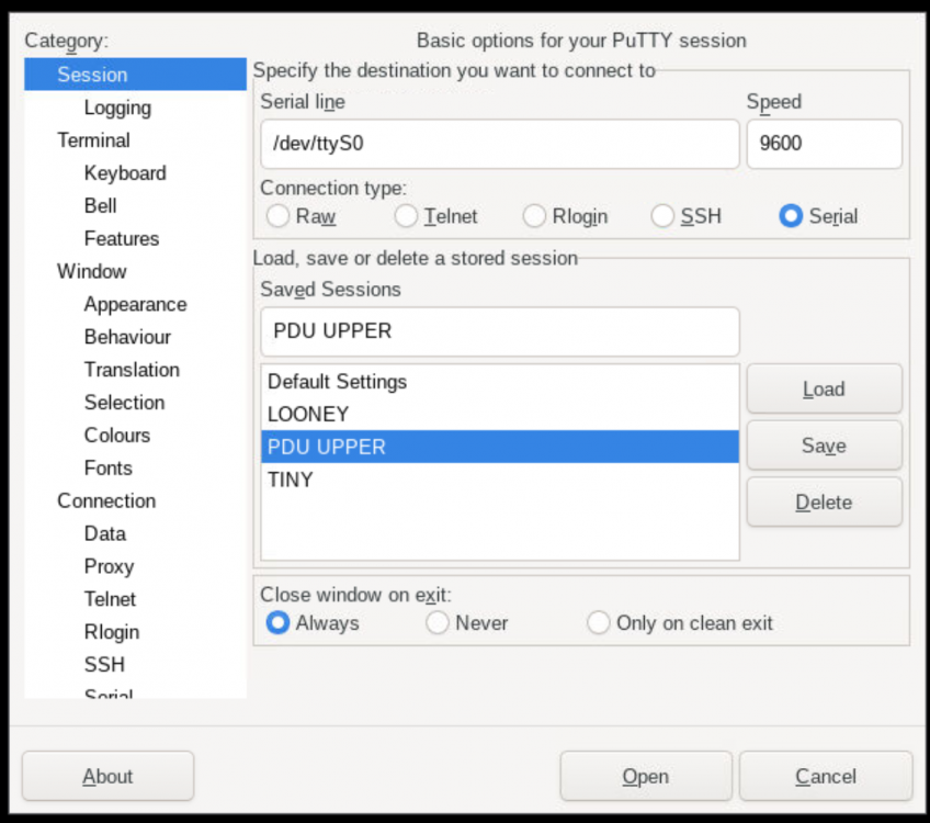

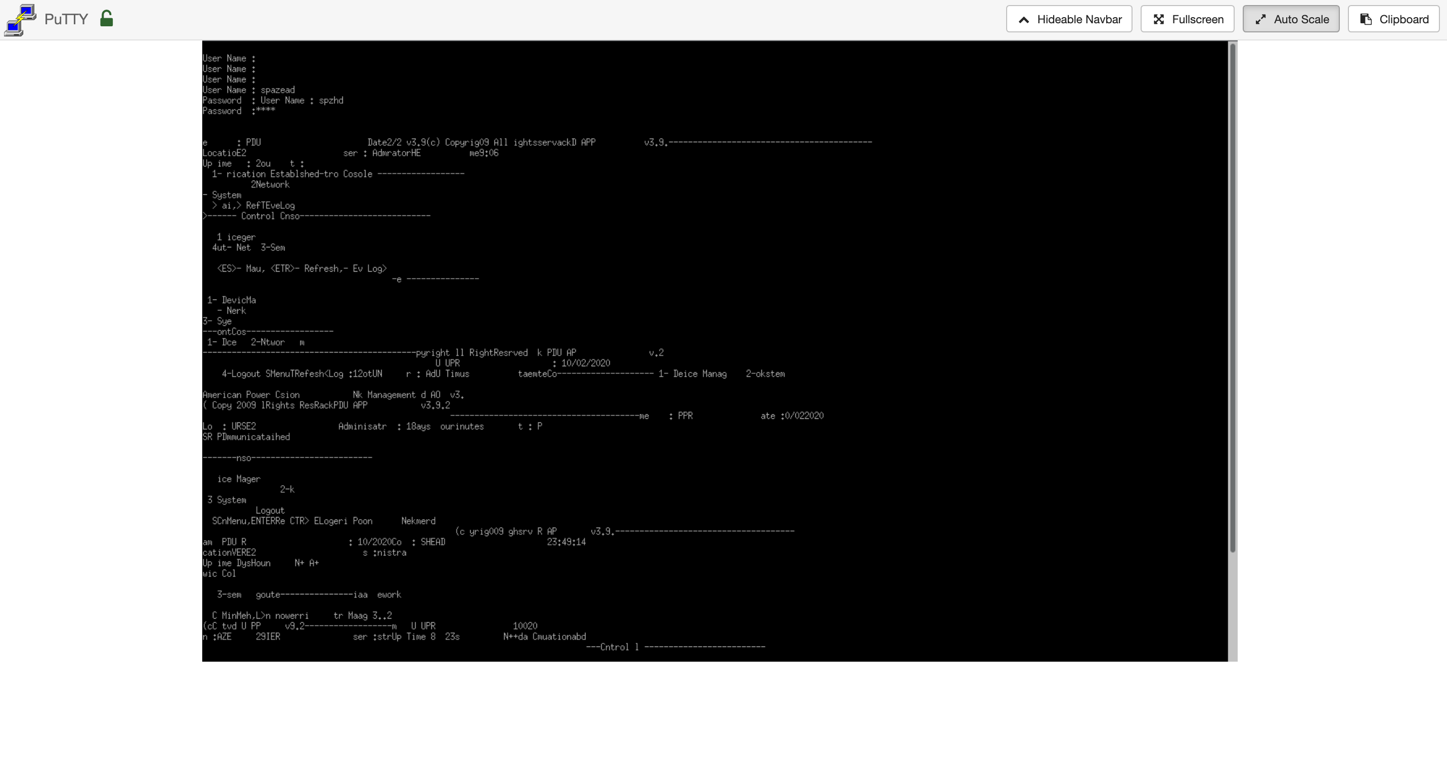

September 15, 20206 yr hi there, hope someone can help me, trying to use Putty docker to access my APC PDU, i copied the setting i have from my windows putty but the display is all distorted. My windows putty works fine.. Edited September 15, 20206 yr by Spazhead
September 15, 20206 yr Author 17 hours ago, Spazhead said: hi there, hope someone can help me, trying to use Putty docker to access my APC PDU, i copied the setting i have from my windows putty but the display is all distorted. My windows putty works fine.. The first screenshot you provided doesn't seem to come from the container's UI... is it the case?
September 29, 20205 yr Author On 9/15/2020 at 7:07 PM, Spazhead said: thats from the webgui , i can do another one Ok, the blue bar on top of the window was confusing me, it is usually not there... Did you try to reduce the font size in PuTTY settings ?
October 3, 20205 yr On 9/29/2020 at 2:04 PM, Djoss said: Ok, the blue bar on top of the window was confusing me, it is usually not there... Did you try to reduce the font size in PuTTY settings ? here it is with default font size, still the same
October 14, 20205 yr Author On 10/2/2020 at 11:50 PM, Spazhead said: here it is with default font size, still the same In PuTTY config, under "Terminal", maybe you can try to enable "Implicit CR in every LF" ?
October 14, 20205 yr 18 hours ago, Djoss said: In PuTTY config, under "Terminal", maybe you can try to enable "Implicit CR in every LF" ? hi there, try that, it's still the same. thanks
October 20, 20205 yr Author On 10/14/2020 at 5:05 PM, Spazhead said: hi there, try that, it's still the same. thanks Sorry, I'm not sure what's going on... There are a few settings under "Terminal" you can play with. I do have few devices connected through serial and I don't have such issue.

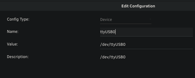

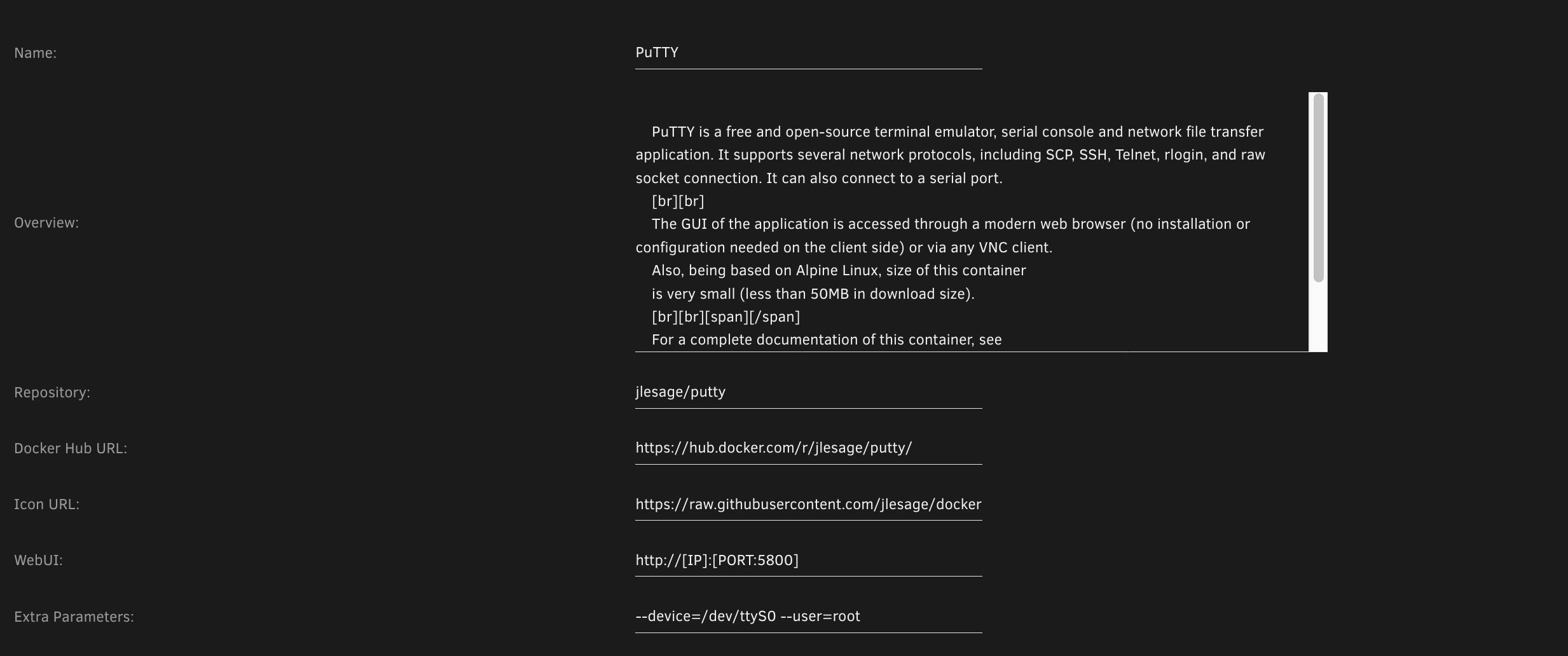

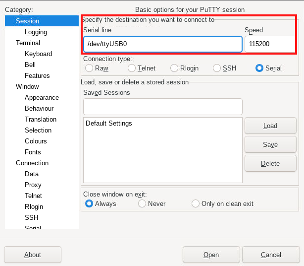

February 2, 20215 yr On 7/9/2019 at 9:18 PM, Djoss said: You need to edit container's settings and add a "Device". The device should be the one associated to your serial port (e.g. /dev/ttyS0). Then you also need to add a variable "SUP_GROUP_IDS" with the value sets to the group of your serial device. You can get it by executing: stat -c '%g' /dev/ttyS0 This is SUPER helpful. Thank you! Can you please add notes to that effect in the template overview? I would never have known this if I didn't come across this forum. I have initially just added the --device paramter but that wasn't enough. This is what I did to make it work for my serial USB cable /dev/ttyUSB0 Run this on UNRAID terminal: # stat -c '%g' /dev/ttyUSB0 16 Add these paramters to the Docker template Then use that device using the Serial option: Interactive serial console now working:
February 3, 20215 yr Author 7 hours ago, frakman1 said: This is SUPER helpful. Thank you! Can you please add notes to that effect in the template overview? I would never have known this if I didn't come across this forum. I have initially just added the --device paramter but that wasn't enough. This is what I did to make it work for my serial USB cable /dev/ttyUSB0 Run this on UNRAID terminal: # stat -c '%g' /dev/ttyUSB0 16 Add these paramters to the Docker template Then use that device using the Serial option: Interactive serial console now working: Yes, this is something that could be added to the documentation on GitHub. Also, I think the part to get and set the supplementary group could be done automatically. The only thing that would be needed is exposing the device to the container. I will look at this...
