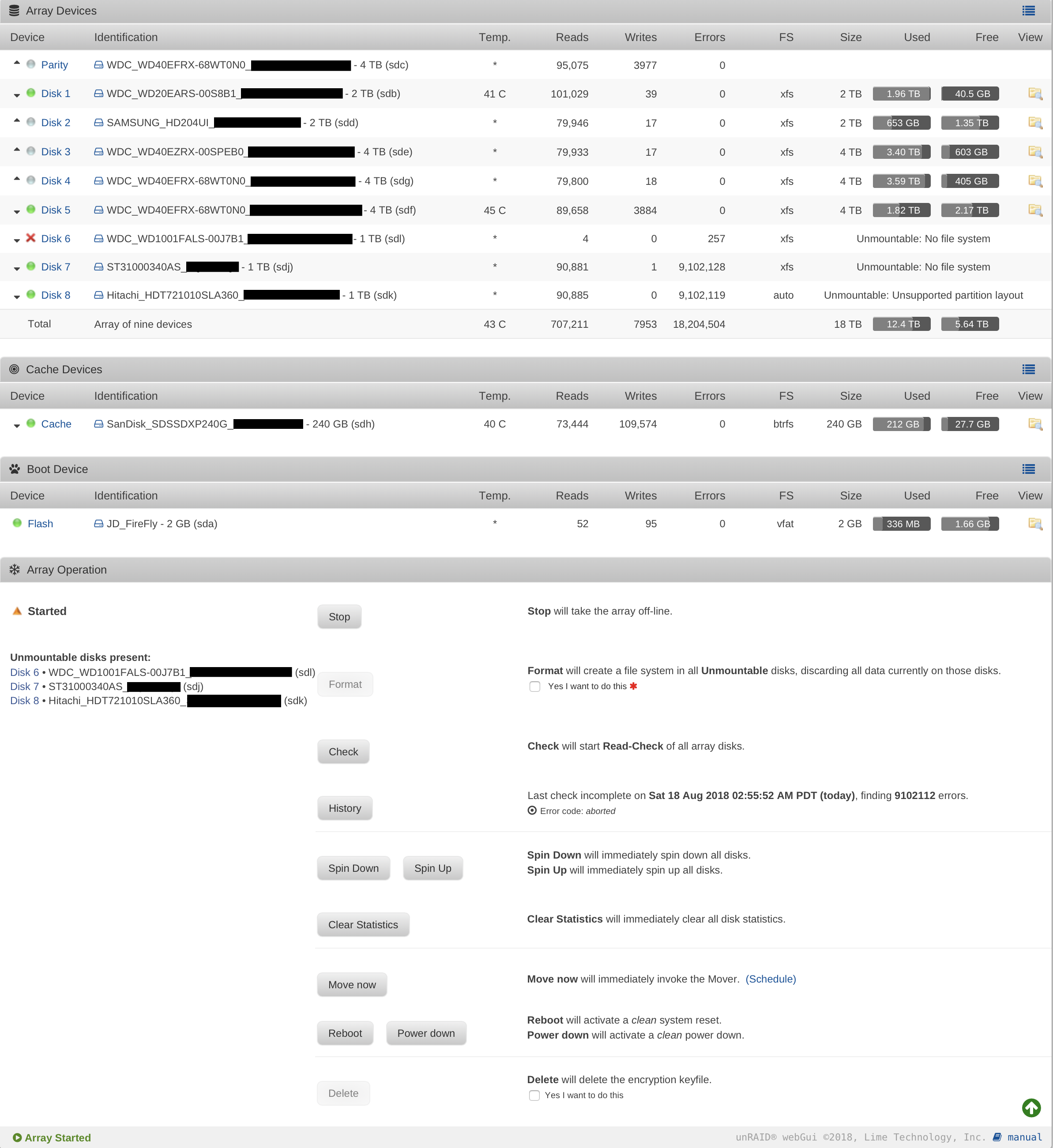

My unRAID 6.5.2 system reported that disk6 (sdi) had been disabled. I had a same-sized, unassigned hot spare already in the tower, so I followed the instructions below to replace it with the hot spare (sdl). (I did not remove the disabled disk, as I am currently thousands of miles away from the tower and won't be near it for several more months.)
https://lime-technology.com/wiki/Replacing_a_Data_Drive
When I started the array, unRAID began to rebuild disk6. Shortly thereafter, however, there was a notification that there is a problem with the hot spare disk also. Shortly after that, another disk -- disk7 (sdj) -- showed up as unmountable.
I have another disk in the array (disk8) that is empty, the same size, and could be used to rebuild disk6 (my first priority, if possible). That disk, however, was set up with encryption a while back, but it never seemed to work properly, always displaying "Unmountable: Unsupported partition layout" for unknown reasons. I didn't need the space on that drive at the time, so I figured I'd get around to reformatting it (unencrypted) at some point in the future.
In short, it seems like three drives (two data drives, one hot spare) *might* have developed/exhibited problems all at once. I don't really understand what's going on. I should, in theory, have a working empty disk in the array (disk8) that could be used as a potential drive replacement.
If at all possible, I would like to remove the empty disk8 from the array and use it to rebuild disk6. I don't know whether that's possible, and if so, how to proceed.
More generally, I am looking for any and all recommendations regarding how best to move forward. I have attached a console screenshot and a diagnostics bundle.
Any thoughts? Any other information I can provide that would be helpful?
tower-diagnostics-20180818-0308.zip

In addition to the write error which disabled disk6, you were getting read errors on the parity disk some day before that, and you are still getting read errors on 6,7,8. Also, 6,7,8 are not reporting SMART so likely they aren't connected any longer.
I think you must have a serious hardware problem such as the disk controller which is affecting multiple disks. I don't think you are going to be able to fix this remotely.

SAS2LP driver crashed during the rebuild, all disks are likely fine, but you'll need to reboot and get new diags since they are offline, rebooting should also bring all your data back.
SASLP/SAS2LP are not recommended for a while now, and this is one the the recurring issues, you should replace it with an LSI, but for now you might get lucky and a second attempt could complete without issues, assuming the disks are in fact OK.
