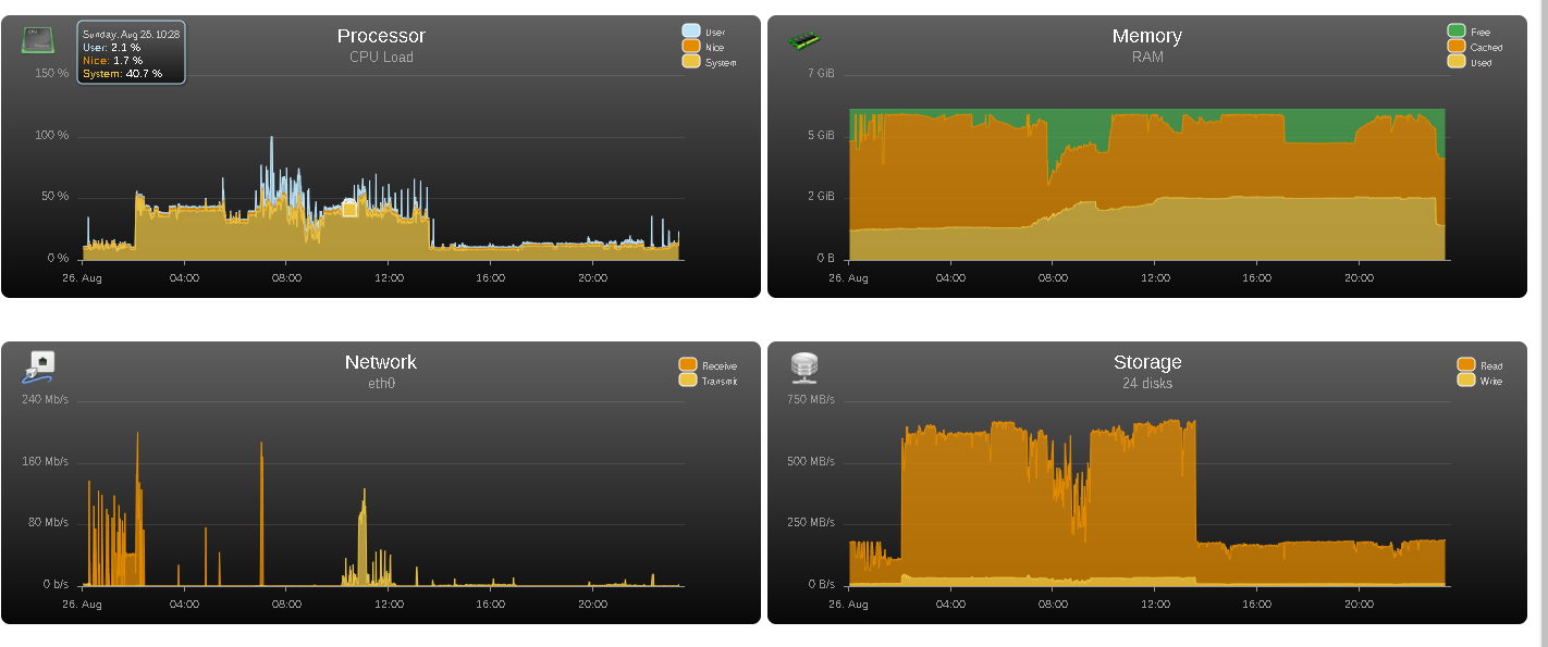

any ideas as to why a parity sync will all of a sudden drop 50% in speed?
i am trying to  complete a parity rebuild to a new 8TB drive (tested with preclear before the time), and for the first +-13 hours it was performing admirably (roughly 35MB/s). since this afternoon however, it dropped to 10MB/s
I dont have anything writing to or reading from the array, so it is really strange to see this :
I have disabled anything extra (cahcdirs , and now for troubleshooting even the docker and VM services). No details in syslog as to a caused. can anybody maybe give an idea?
not willing to wait 7 plus days for a parity sync to finish at current speeds :(, but also dont want to give up on 25% / 24 hours alread completed...
Personally, I'd consider that to be the low end of unacceptable :)  But, with the age of your system, it might be as best as you can get...
Other than that, your parity drive being reconstructed IS currently overheating.  No clue though is that impacts write speeds or not

65°C would be a warranty-breaking temperature for most HDD.
You need to immediately fix this issue - hard disks doesn't really produce much heat but 10W of heat without moving air will result in very significant temperature increases. Your fans must move air over the drives. And preferably cool air sucked into the case and not air that has already been heated by the CPU, PSU, graphics card etc.

must admit - stubborn me did not want to believe it, but seems like temperature was indeed the cause. just the stubborn, errr i mean loyal old server, wanted me to remove it from the server cabinet and put it right next to my bed before it started to complete a parity sync (combined with a massive 75 cm fan for the warmer times of day.
i believe there is other possible issues afoot - possibly some of the controllers, as i had 4 drives drop out of the array yesterday during fan troubleshooting, which required me to run xfs_repair before i could mount them again. will monitor it closely
