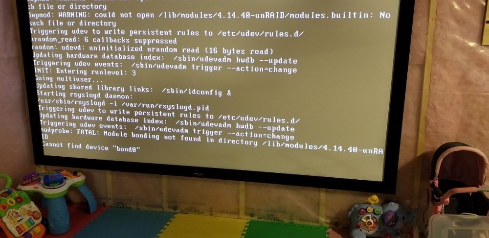

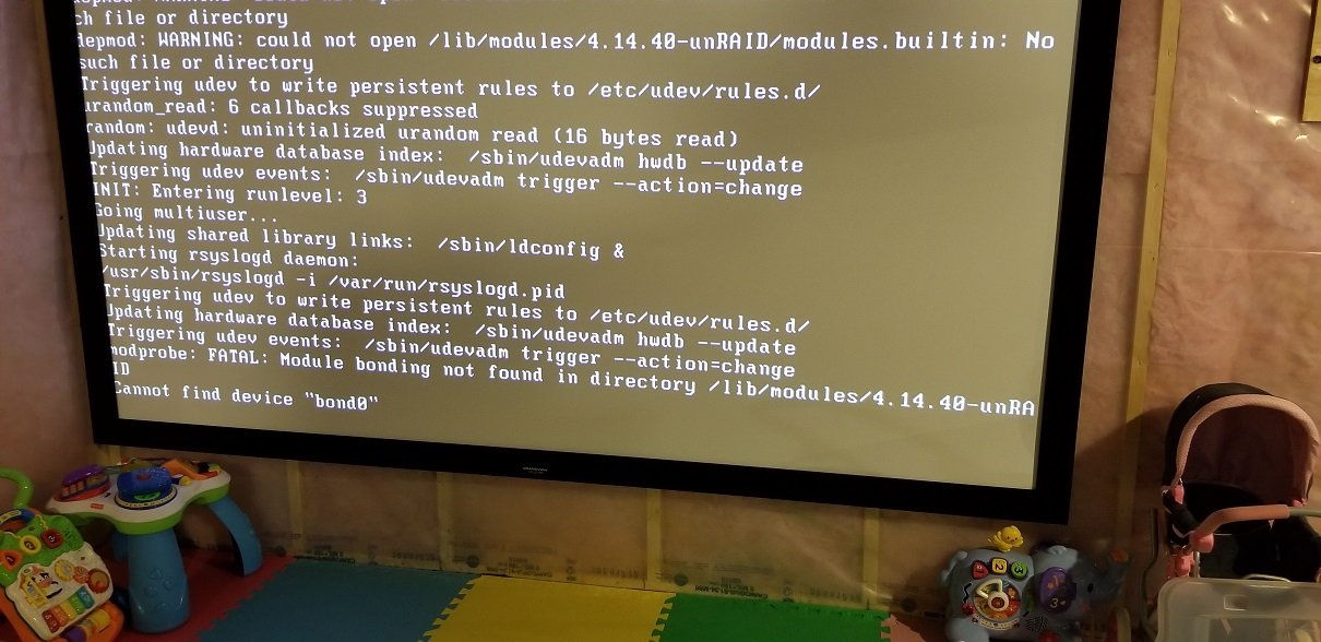

So this afternoon I noticed that my Plex docker had an update, having done this multiple times before I initiated the update but it failed. Immediately I noticed my custom banner was reset to default and my docker and vm tabs were missing but everything seemed to continue working. Upon getting home later that night I decided to do a reboot but was hit with the error cannot find device "bond0". I tried checking the usb on a windows machine and it reads fine, I tried other usb ports on the server with no success.

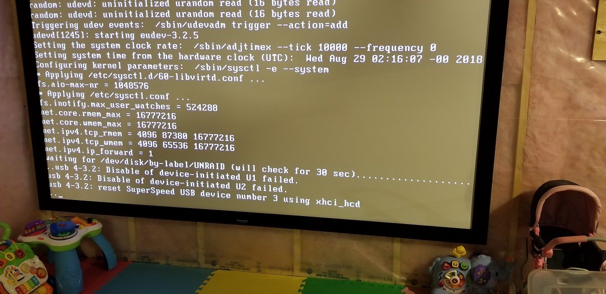

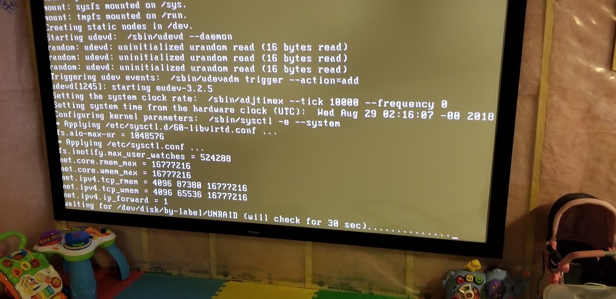

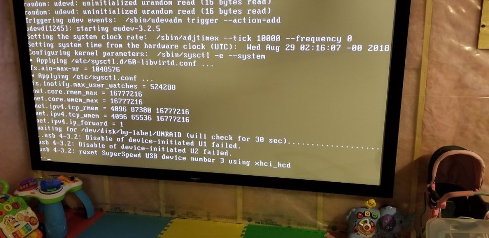

Your boot flash device has dropped off line. Try a different socket, preferably a USB 2.0 one.
I tried several same all around.
Does your flash device have a USB 2 or USB 3 interface? Use a standard USB 2 one, even if you have to put it in a USB 3 socket.
I mean it is usb 3 but it has worked without a hitch for over a year and now all of a sudden a plex update fails and everything stops working?
It's dropping off line, as shown in your second photograph.

As said by @John_M your USB is offline. This prevents loading of the necessary drivers which are stored on the USB device, resulting in the error message about bond0.
