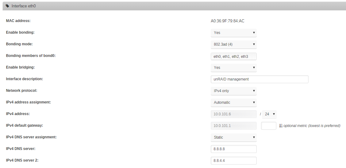

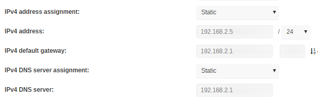

I tried setting them statically in unraid to other DNS but it keeps wanting to take the VPN dns..
Show once again "cat /etc/resolv.conf"
seems like no matter what I do in pfsense or unraid, always takes wrong DNS
would that DNS make it so i couldn't get to the web gui as well?  i know it wouldn't be able to resolve internet names.
There must be something overwriting your DNS entries on your server. I just made a quick test on my backup server.
root@ceres:~# cat /etc/resolv.conf
# Generated DNSv4 entries:
nameserver 8.8.8.8
nameserver 8.8.4.4
Try starting your server in safemode...

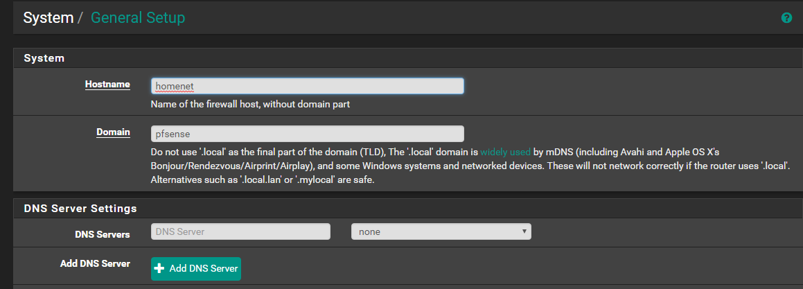

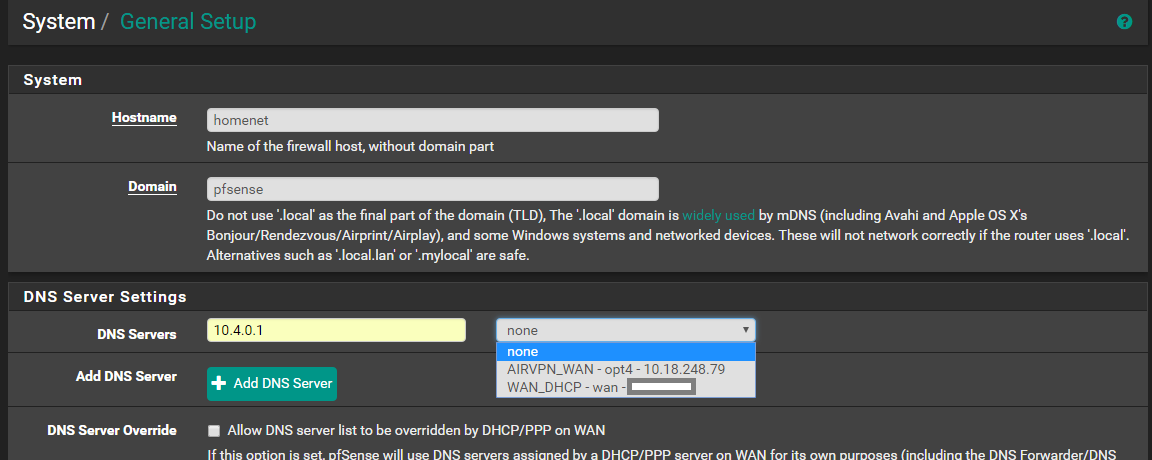

hey, in pfsense, under the general settings, that 10.4 number was there.  I deleted it and now unraid takes the DNS number that i put in there. the only problem is i may have broken my VPN settings on my VPN network, i won't know until i can test it.
But Unraid should not take the pfsense setting when "static" is configured. It would simply ignore that. Can you show me your network.cfg file?
ya it broke my DNS for my VPN network but maybe I can find a workaround.  there must be another way.   I can't thank you enough for figuring this out for me..  I have been driving my wife and kids nuts.  hopefully this will fix the webgui issue as well.  :)
for sure i will grab show the file..  that would be even better.

I expected to see:
DNS_SERVER1="8.8.8.8"
DNS_SERVER2="8.8.4.4"
Not sure from where the 54.x.y.z address comes. You are sure you did "Apply" to change network settings?

here it is again.. i just switched Unraid back to automatically instead of static.  here is with the static ip set.

here is a picture of my pfsense general settings.  i deleted the 10.4.0.1 out of the general DNS setting and now Unraid works but my VPN doesn't.  And yes, all the VLANS are separate in pfsense and the switches.   I tried putting back the 10.4.0.1 in the DNS setting and dropping down the list and picking AirVPN Wan but that didn't work.  I am stoked though at least I know now where the problem was.. i was about ready to give up on unraid and throw the computer out the window.

You might also want to try turning off DHCP (set IPv4 address assignment to Static) and fill in the blanks.
And like @bonienl thinks, you probably have VLANs bridged together thanks to the CISCO switches. If pfsense has a log for the DHCP requests, you will see the unRAID MAC address (as well as other devices) on all the other VLANs.
thanks Ken-Ji,  will look into that, think I will set it to static so I can control it. thanks so much for your help.

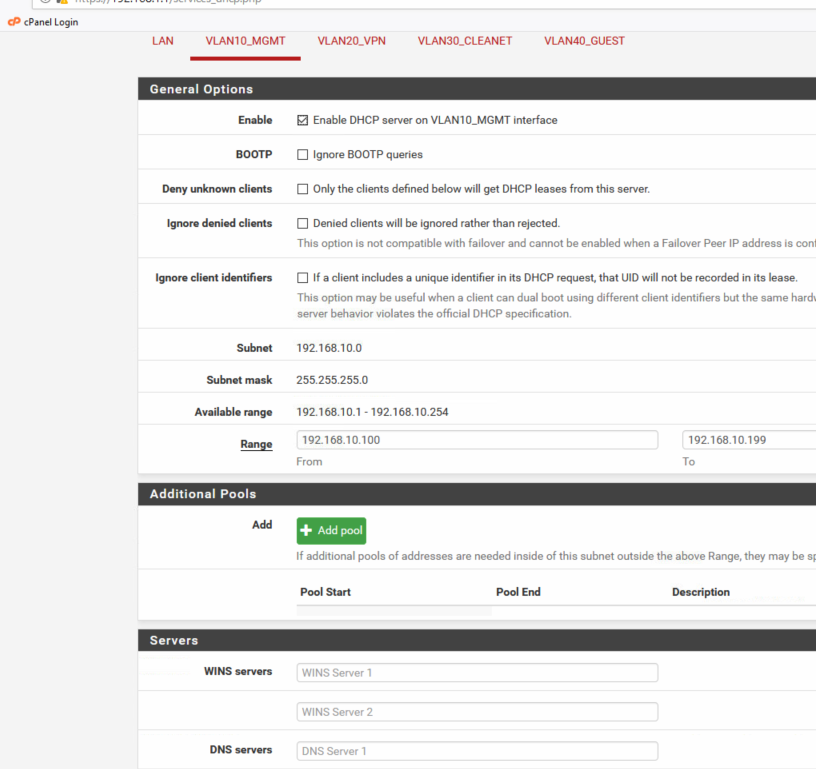

So since you are using DHCP and pfSense is handing out the ip you need to look at Services-DHCP Server- then click on the vlan that is 192.168.10.0. See mine called vlan10 under dns i have no servers, because im letting my gateway address also be my dns server for that vlan.
my assumption is that under you setup you have a DNS address of getflix.

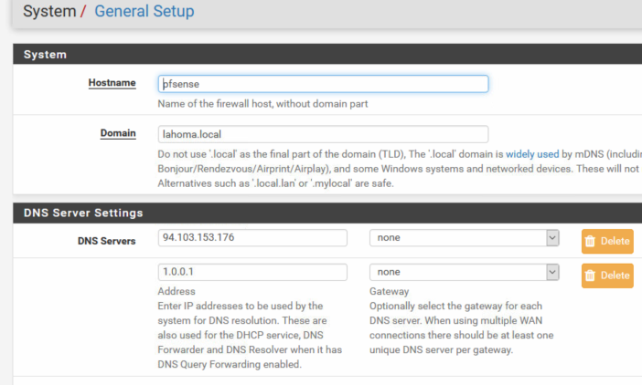

Next i see you are using air vpn (the best VPN out there. just saying) let me ask you again are you forcing all of your traffic thru the vpn?
i ask because in your above screenshot you have one of airvpns dns addresses and unless  all of your traffic is going thru the vpn tunnel you it will not know were to go. My general setup also below in the image. my setup only has vlan20 using the vpn everything is using wan.

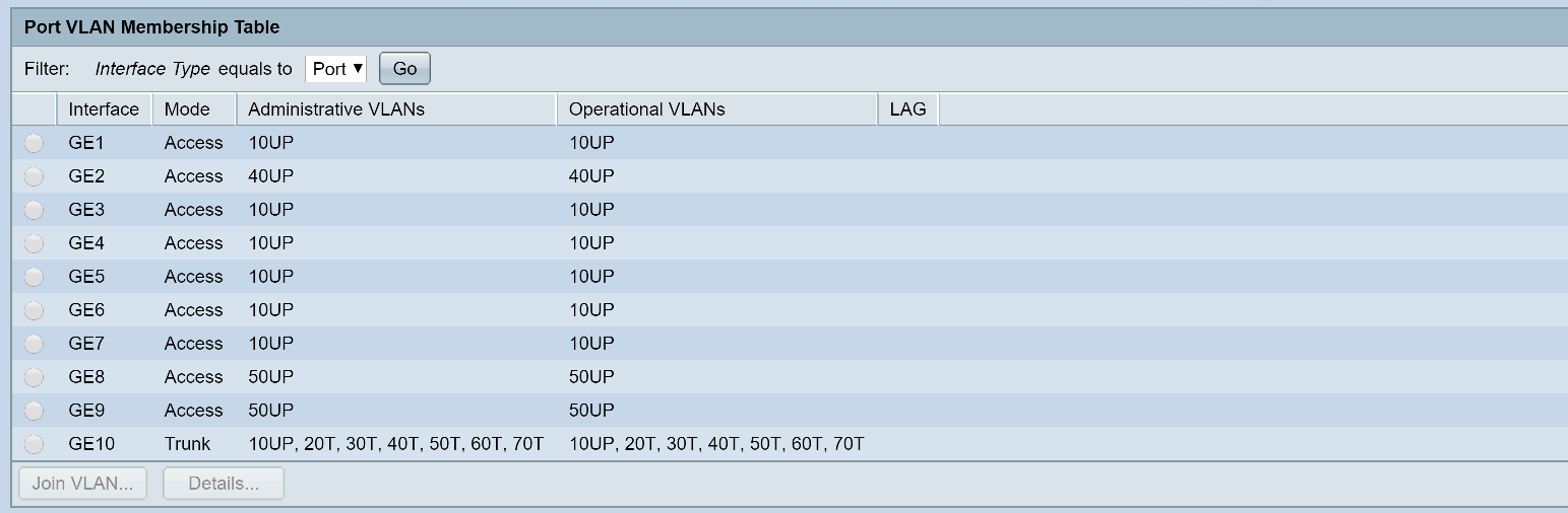

I also have the 10 Network as an untagged network, i was told to set it up that way on the PFsense forum.  All my switches are setup using VLANS.  Here is a screen shot of the one in my bedroom.  See how port 10 is the trunk port that carries all my VLANs to my bedroom. Port 8 and 9 are for cameras.  Port 2 is if I want to connect to AIRVPN, and the rest are my regular LAN.
