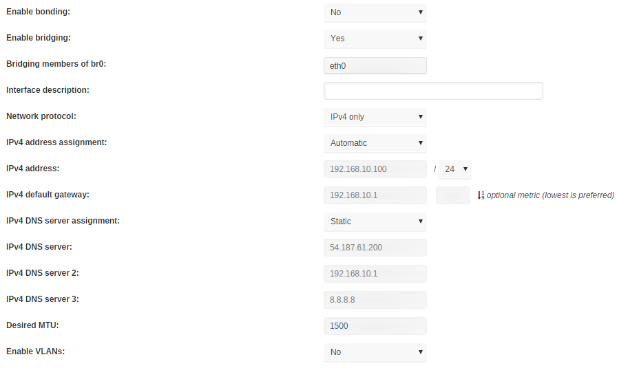

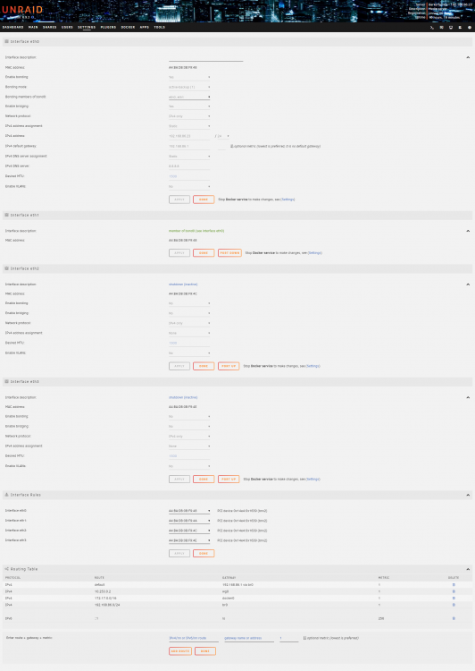

Hey guys, just got Unraid up and running but it doesn't connect to the internet.
I am running PFsense but without any plugins so i don't know if that complicates things.  If i go to terminal, i can ping 8.8.8.8 and 8.8.4.4.  I try to paste the community app link into plugins and it says network failure.
I am thinking it is a DNS thing as I can ping when i use numbers.   Any help would be so much appreciated, i am now at a stand still.
Edited by xman111

Hey Squid, i am in Vancouver, Canada, should be no blocking.  My gateway is pointing to pfsense 192.168.10.1.   I also added a screenshot of my network settings

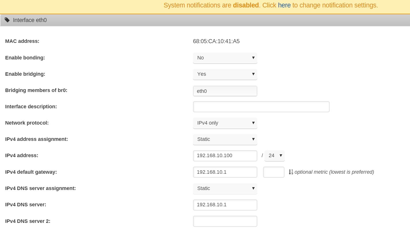

Try putting either  8.8.8.8 or 8.8.4.4 in as the     'DNS server2:'  entry and see if that helps.

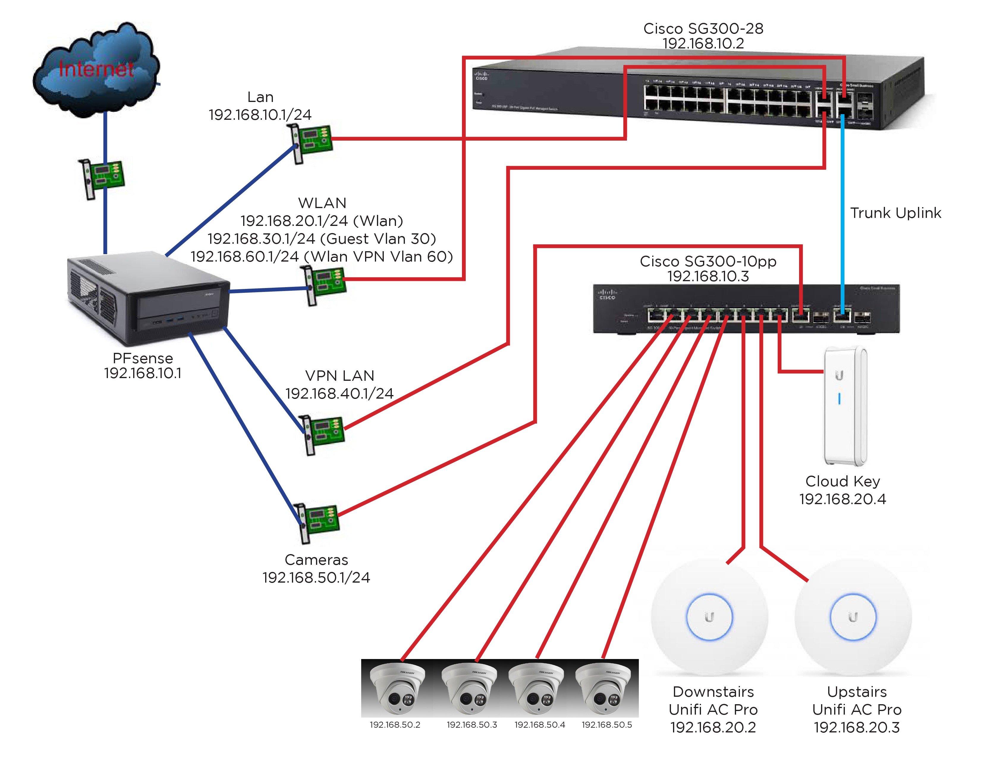

Here is a bit of an older diagram of my network.   Everything was installed new when we built our house a year ago.  It is a little complicated but works awesome.
Not sure if it is a pfsense issue or unraid as all my other machines work great.

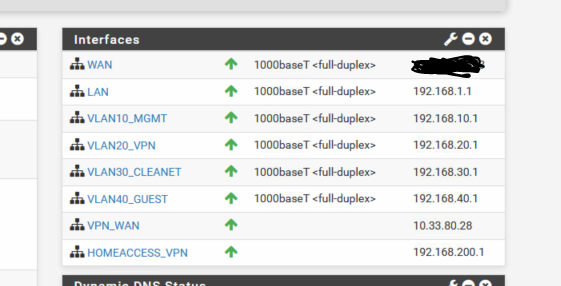

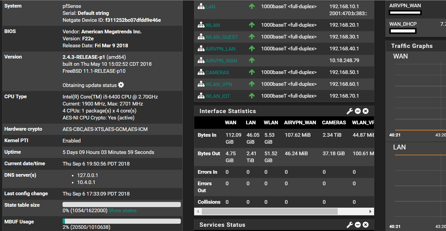

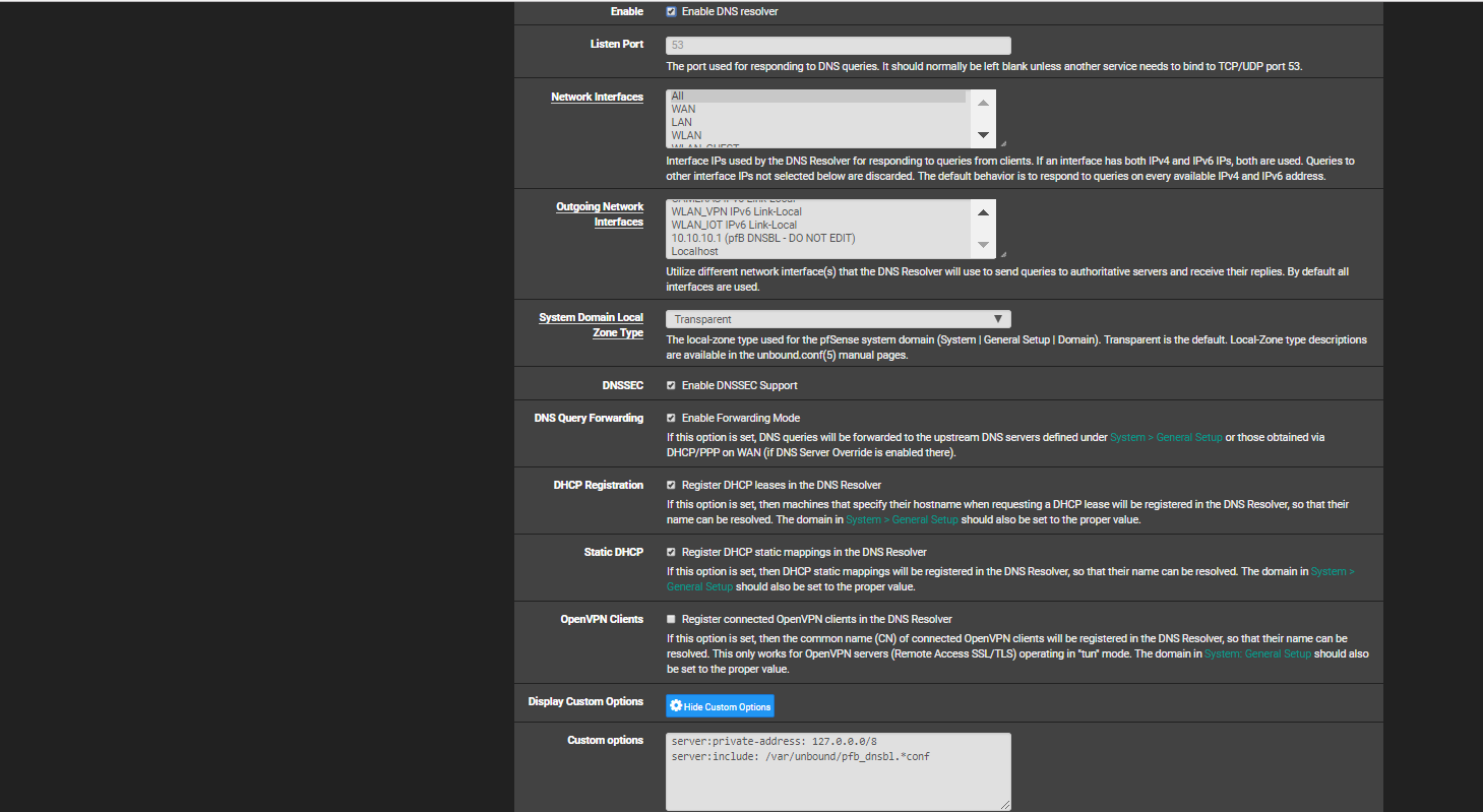

here is my pfsense page.   Have a kick ass computer for it too, i5, 16gb, ssd, still no worky :)
here is my DNS page.. i did notice something in there about pfblocker but it is turned off, could that be an issue?

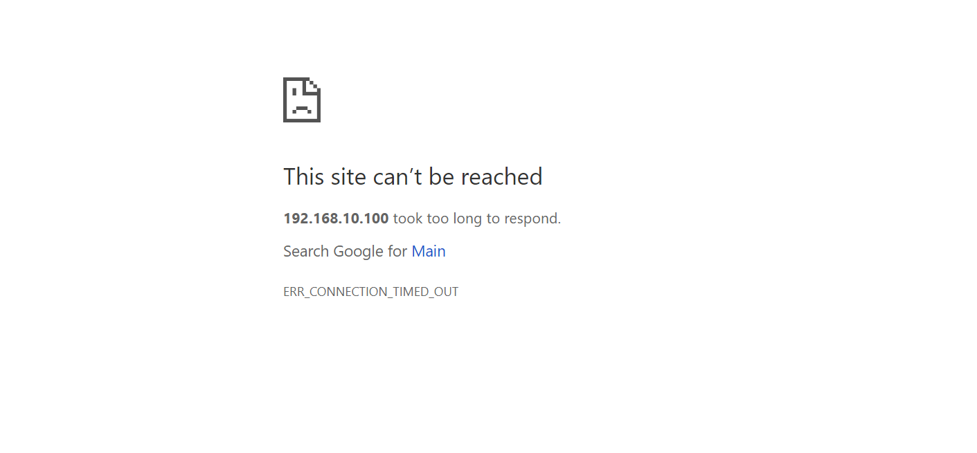

1 last thing while I am thinking about it.  Sometimes when i try to connect to the webgui it says connection denied but if i go on my laptop on a different subnet it can connect.  My home computer and server are both connected right beside each other on a Cisco switch in my bedroom, server is 192.168.10.100 and my PC is 192.168.10.11.  From what i understand, since they are on the same subnet, pfsense shouldn't even be involved.
right now I am trying to connect to unraid from my computer right beside it, on the same subnet and Cisco switch and get this.  But i hop on my laptop on my wireless subnet at 192.168.20.15 and it connects right away.

I see your using nvguru guide, so do I.
So on your main page you have the localhost as a DNS server and the airvpn dns. So unless your forcing all of your Lan traffic thru air it doesn't know where to go.
The setup is set to block all DNS unless it comes from the pfsense box so putting Google's DNS wouldn't work.
I have under general an openic dns and cloudflare. My vpn subnet uses air's dns.

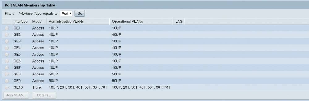

This definitely means you have an issue with how the SG300-28 is working with the LAN / vs VLANs
are the ports tagged properly? is the native VLAN, the LAN? run this from your desktop and from unRAID. (use unRAID ip / desktop ip respectively)

also these two computers (desktop and server) are attached to a SG300-10 in my bedroom.  Port 10 is a trunk port that brings in all my Vlans into my room so i can assign each port to whatever vlan i want.  All the ports are tagged VLAN 10 untaged (which is my lan network) except one, which is tagged 40 which is my VPN, so if i want to connect to AirVPN, i just plug the computer into port 2 instead of port 1.
