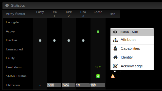

Virtually all reports of this issue are with Linux systems.  It does not seem to occur with Windows or MAC OSes.  If you got 30 notifications in one day, yeah, that's a lot.  One way to make the notifications less frequent is to acknowledge the error in the GUI.

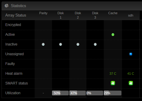

As seen in the screenshot below from the Dashboard, on the "Smart Status" row there will be a triangle warning symbol. for the drive  If you click on that and acknowledge the error, it will go away for a while.  I last acknowledged the error a couple of weeks ago and just received a warning notification about pending sector count on this drive again today.    After acknowledging the warning, it will eventually return (this is good so it can be checked again), but, in the meantime monitor the drive SMART reports to see if there are other issues or if the count increases.  There may be issues with the drive.
Once you acknowledge the error, SMART status returns to OK.

I wish I had a resolution for you other than ignoring the warning, but, that has worked for me and I have never seen any other issues with the drive in the SMART reports.

SMART warning returned and I updated the screenshot and explanatory text

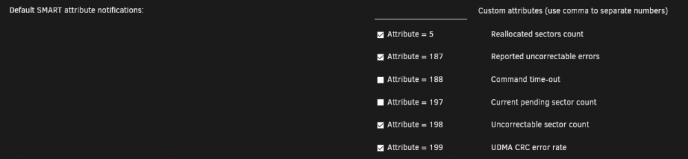

You can disable monitoring that attribute just for the SSD for now, no point to keep receiving false alerts.

On the main page click on the SSD, scroll down to SMART settings and untick attribute 197

Yes, only array and cache devices, I believe there's no way for now to do that for unassigned devices.
You could probably get around it by disabling 197 on the general SMART settings, and then enable for all array/cache devices, though it will stop monitoring other unassigned devices, if you have some.

Thanks.  This seems to have worked until Crucial has a fix.  Though I'm a bit worried they'll never fix it.
